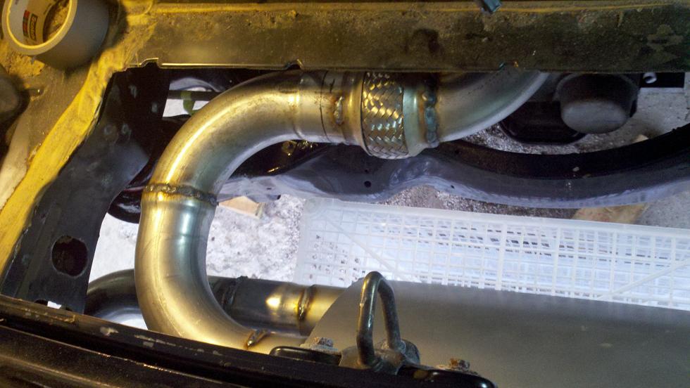

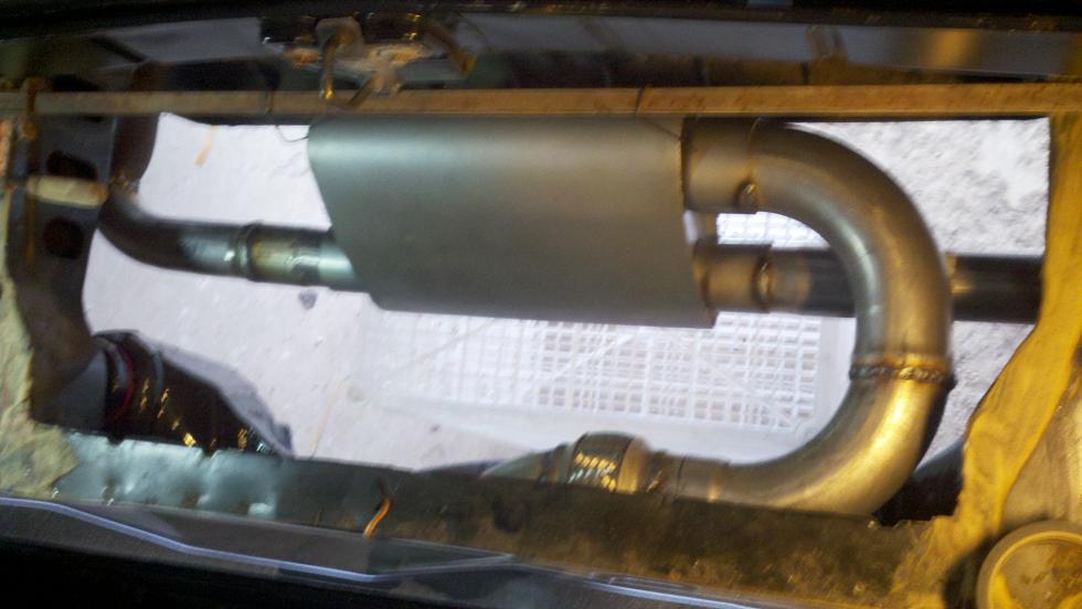

It aint pretty but its done, my first time mig welding, not bad if I do say so my self.
Its a true 3" exhaust with 2.5" out of the Flowtech Afterburner muffler. I tried to leave room for a Inter-cooler eventually. Thats why I decided to cut the trunk out.

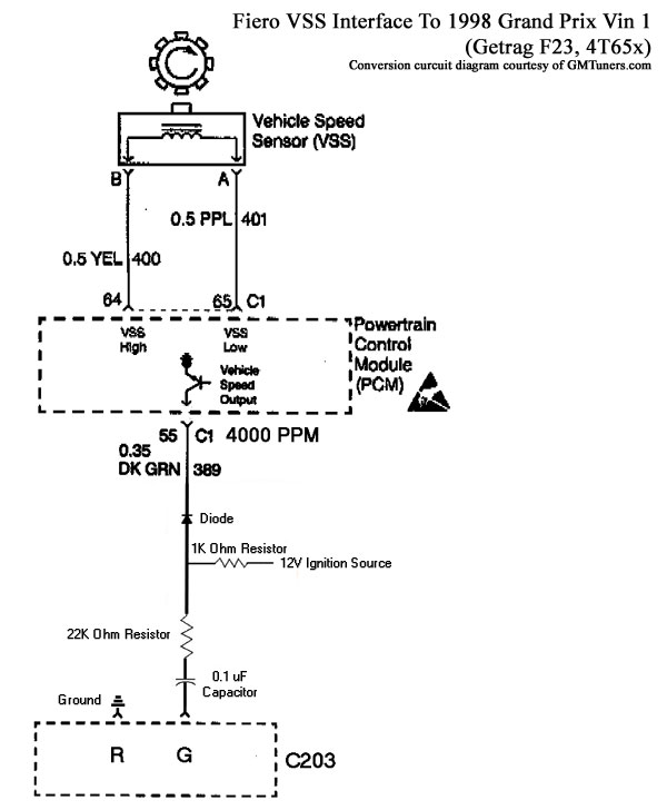

I noticed that my speedo is stuck on 120MPH. (even with the key off.) I did this for the speedo mod. Edit; I did a search for "stuck on 120" and it apears to a common problem and fixes itself with driving. I have no idea how long this car has been laid up, I bought it as a non runner.
That's a pretty darn nice system. I need to build one like that but without cutting the trunk. Also not still sure if I will keep the trumpets.

The muffler was 65.00 plus shipping. The 3-3" elbows, flex joint, and 2-2.5" X12" 90deg bends were $140.00. I am keep a tally on the costs and will write some thing up when i get it on the road. Thanks guys.
