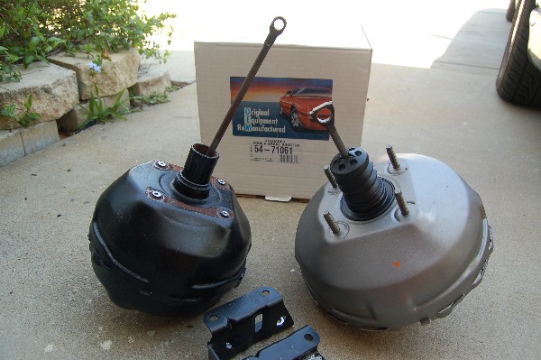

That photo I posted shows the box with a label that says Dodge, along with the part number...it's the same part number for Fiero.

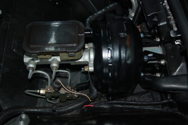

Just finished the S-10 brake booster swap this week.

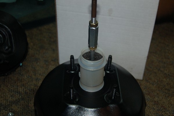

I threaded the linkage instead of welding it. That gave me a nice way of adjusting the rod length so it was perfect when I installed it.
All done and bolted in. The braking improvement is quite nice.

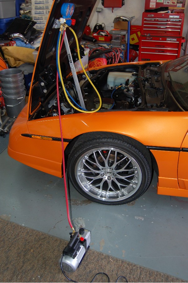

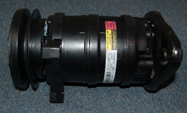

Just before Daytona last month I installed a new A/C compressor, accumulator, orifice tube and o-rings throughout the system.
Bought a vacuum pump and manifold gages and got my A/C working beautifully for the first time in 2 years.
I now know how to do my own A/C!
