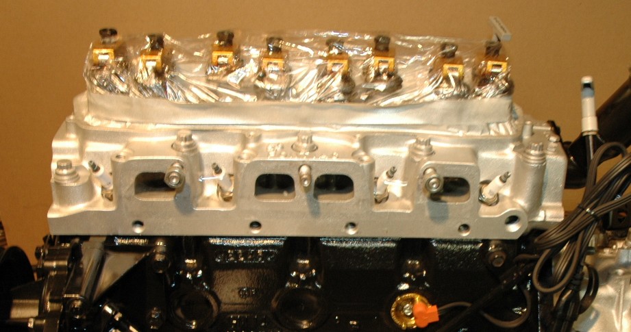

The SD4 head's exhaust ports are quite different from the stock Iron Duke head.
Header gaskets - there are two listed for the 2.5L (sometimes).
Here's a pic of the exhaust ports on my SD4 aluminum cylinder head GM PN 10038433
Fel-Pro SD4 header gasket PN FPP-1441 is what matches the ports.
Here's a comparison of the difference in exhaust gaskets.
The top one matches my SD4 head's exhaust ports, the lower is a stock Duke gasket.
While it will bolt on, a header built for the Iron Duke head partially blocks the SD4's exhaust port.
You can see how by how much when the SD4 gasket is matched to the Duke gasket underneath.
The already smaller SD4 exhaust port has it's flow blocked by a fair bit.
