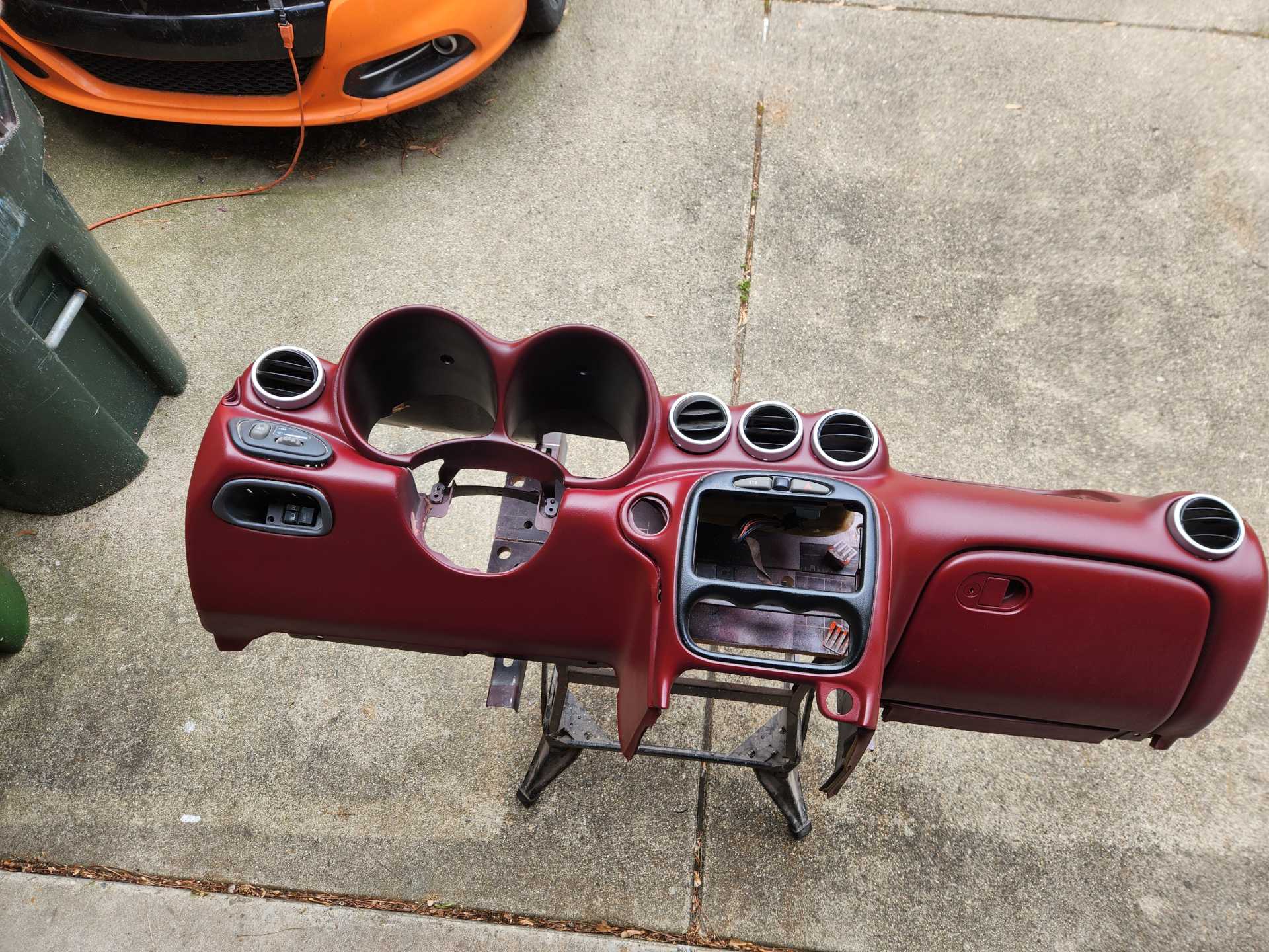

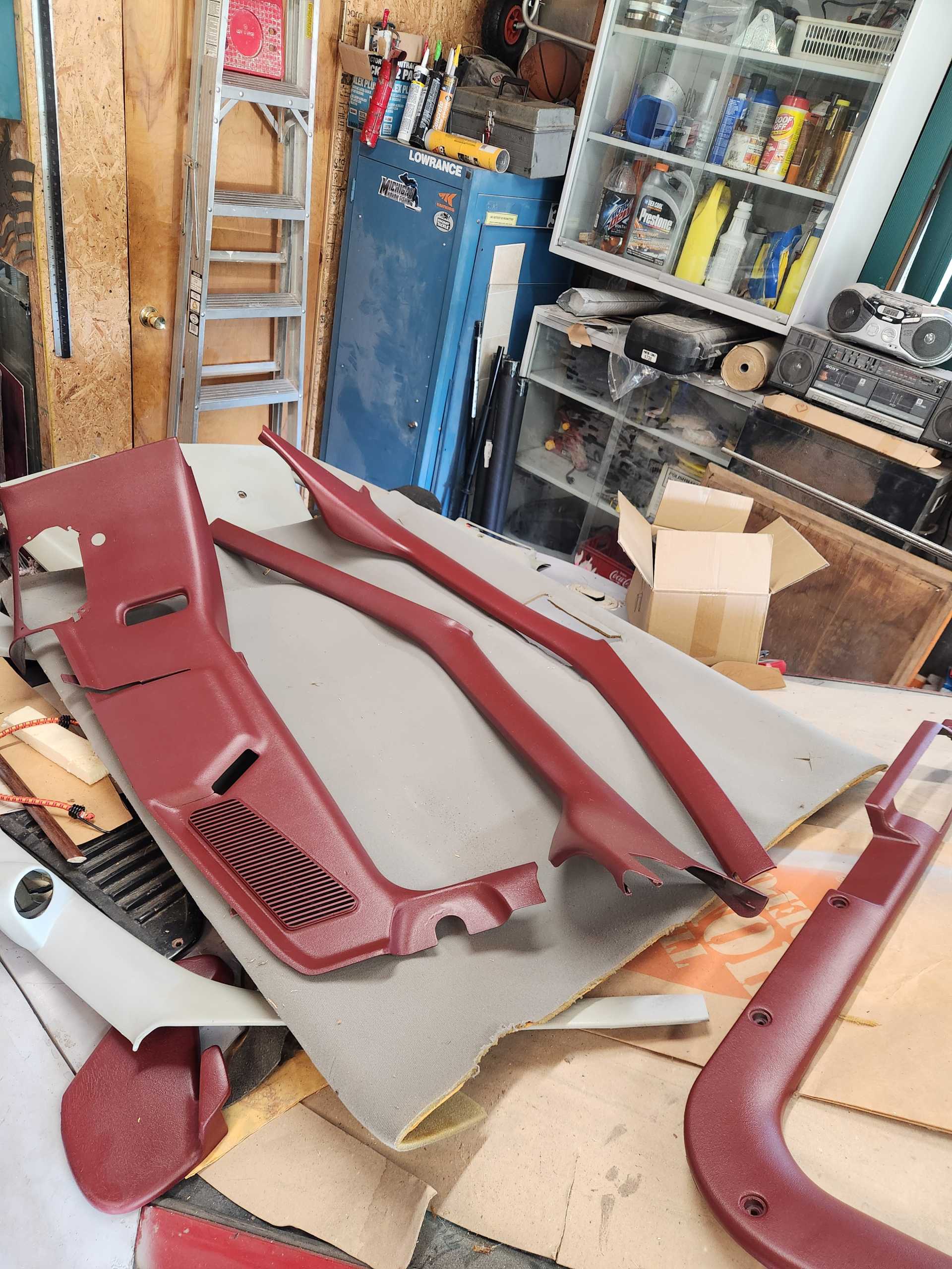

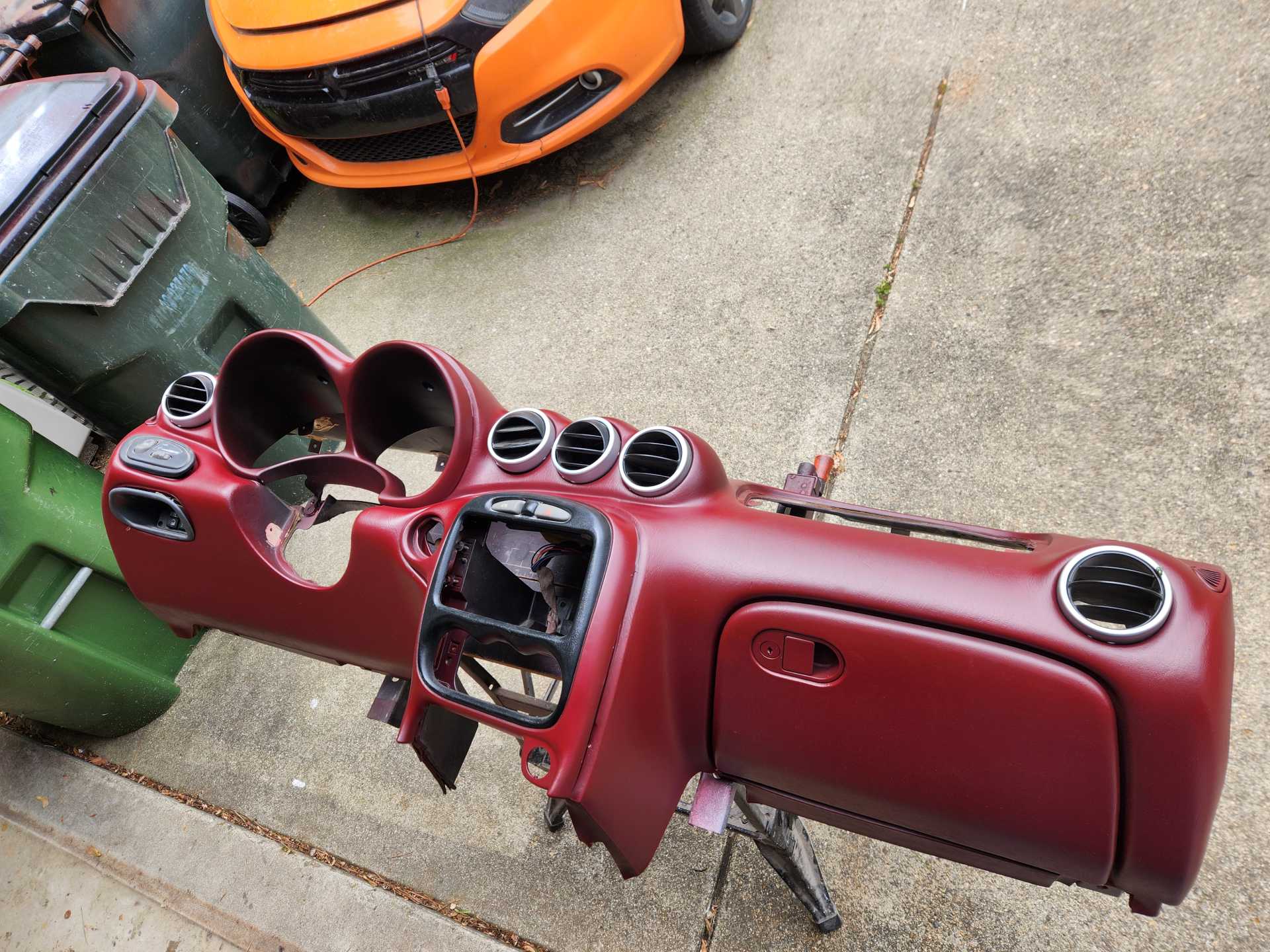

I pulled all of the panels out of storage. They have been cleaned and painted SEM Napa Red. I pulled the dash out last weekend, it is also now Napa Red, with silver and black accents.

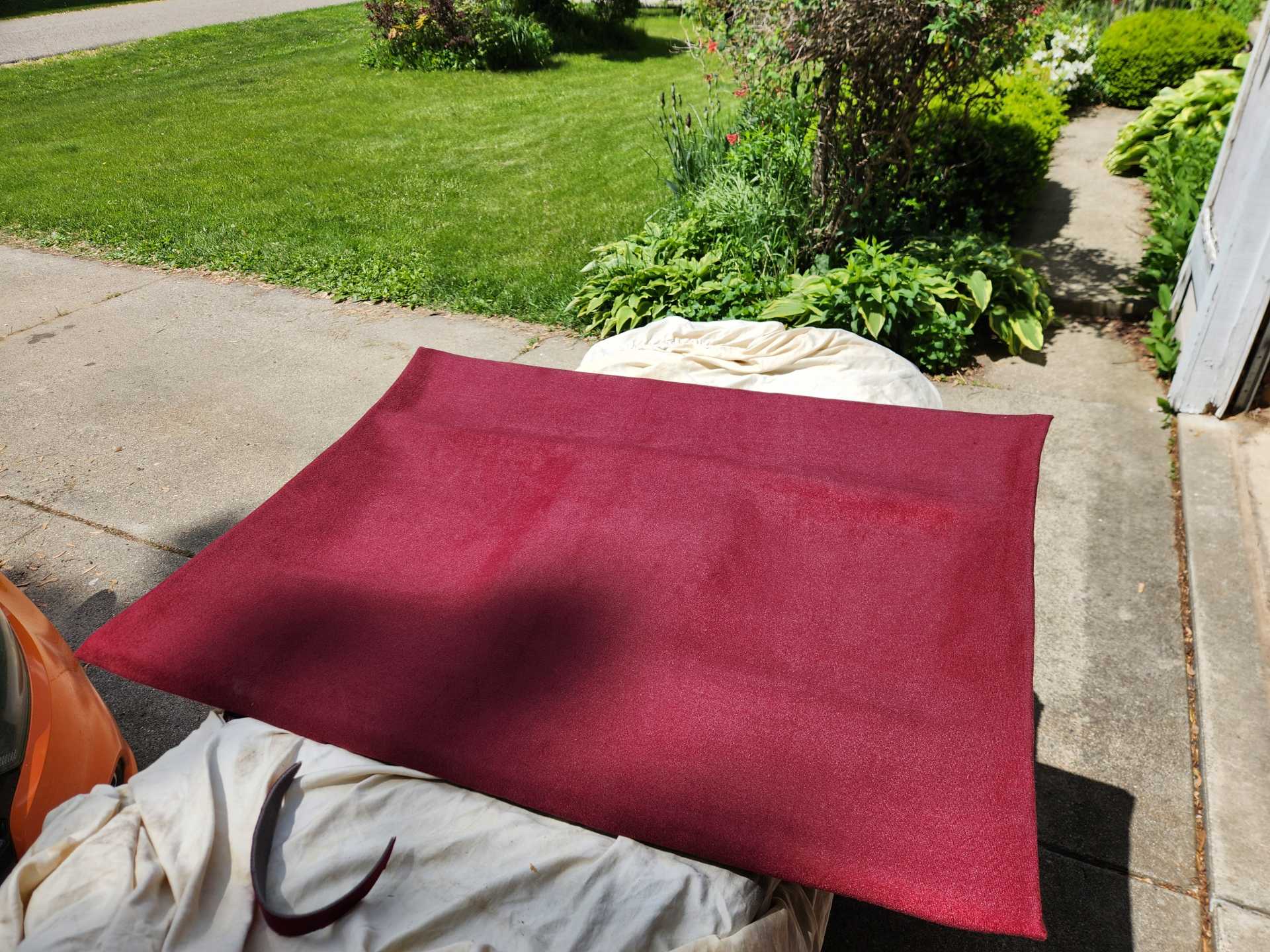

Most of the roof was covered with 50 mil sound deadener (a little to go on passenger side).
The grey headliner was stripped. The backer repaired, and recovered with a pretty close match to Napa Red.

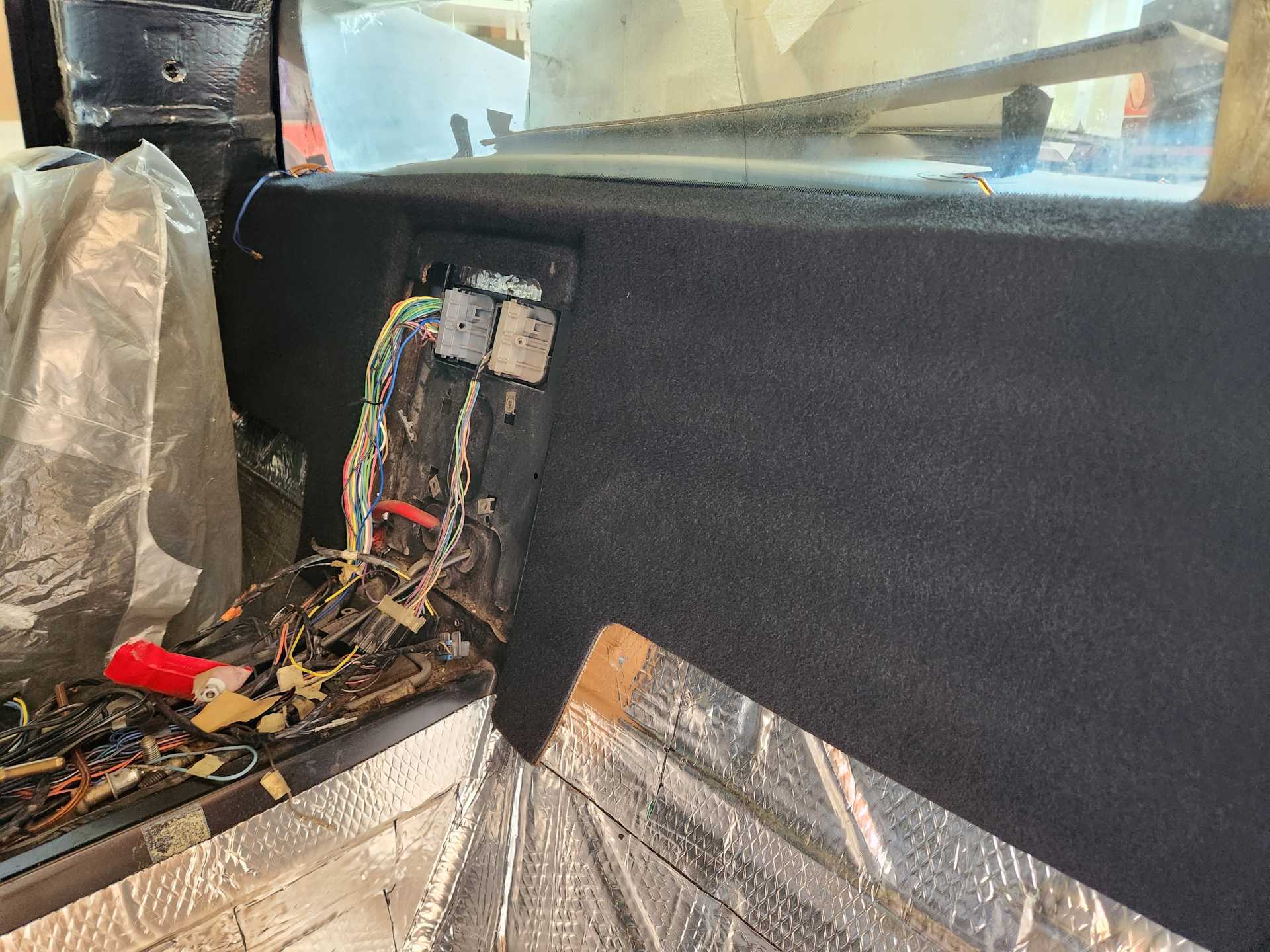

I also spent some time adding a new fuse box to the frunck, where I'm getting power for a new Boss amp and ran power for the power seats.
And, lastly, I ran though and found all of the proper stereo wiring, then installed a new Boss 7" multi-media head unit.
