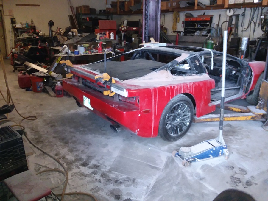

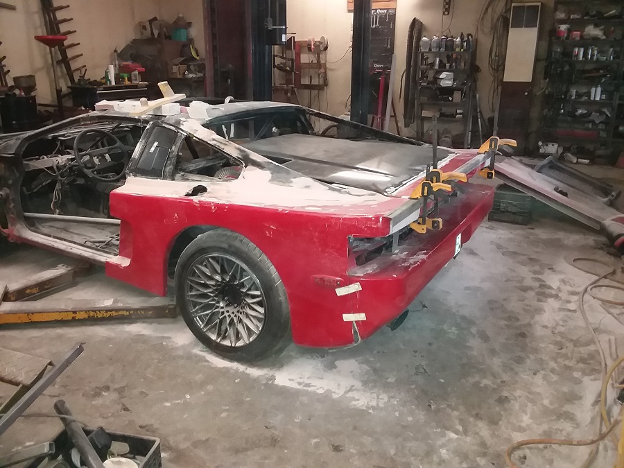

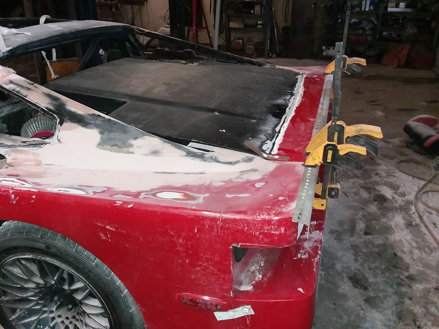

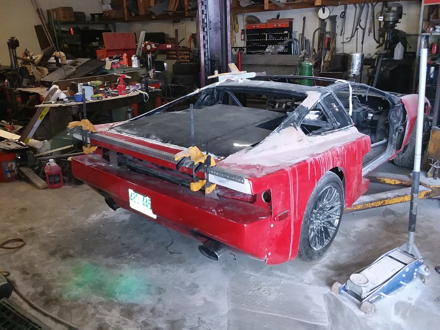

well today since it is slow i am playing with the rear deck lid i am using a GT lid and have cut the back off the kit car lid and am attaching it to the GT lid this is giving me a much better fitting deck lid and better looking when shut or open
engine man

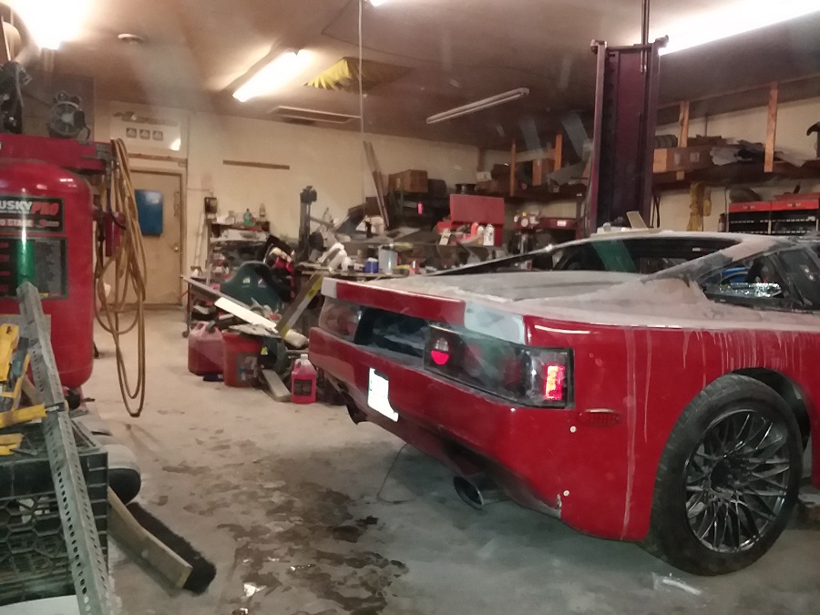

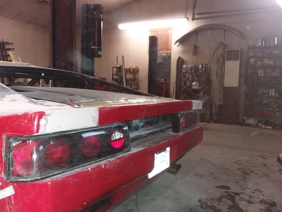

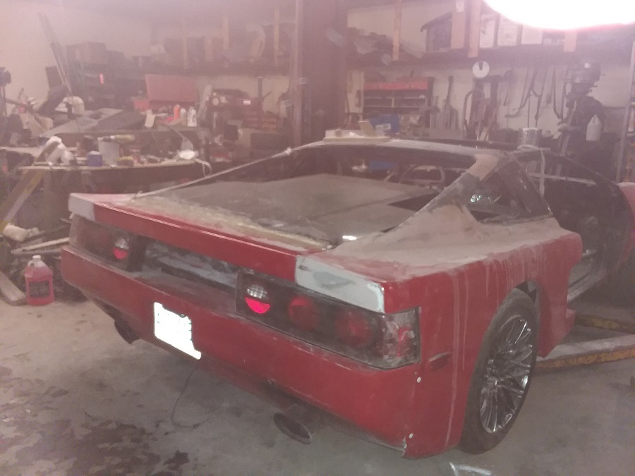

JAN 20, 12:36 PM
just wanted to show how much better the taillights fit the first pictures was how they were before with some really big gaps now they fit nice and tight but i still need to do a bit more messaging but it is 90% good. you can also see the right hand side rear dips down from the inside to outside

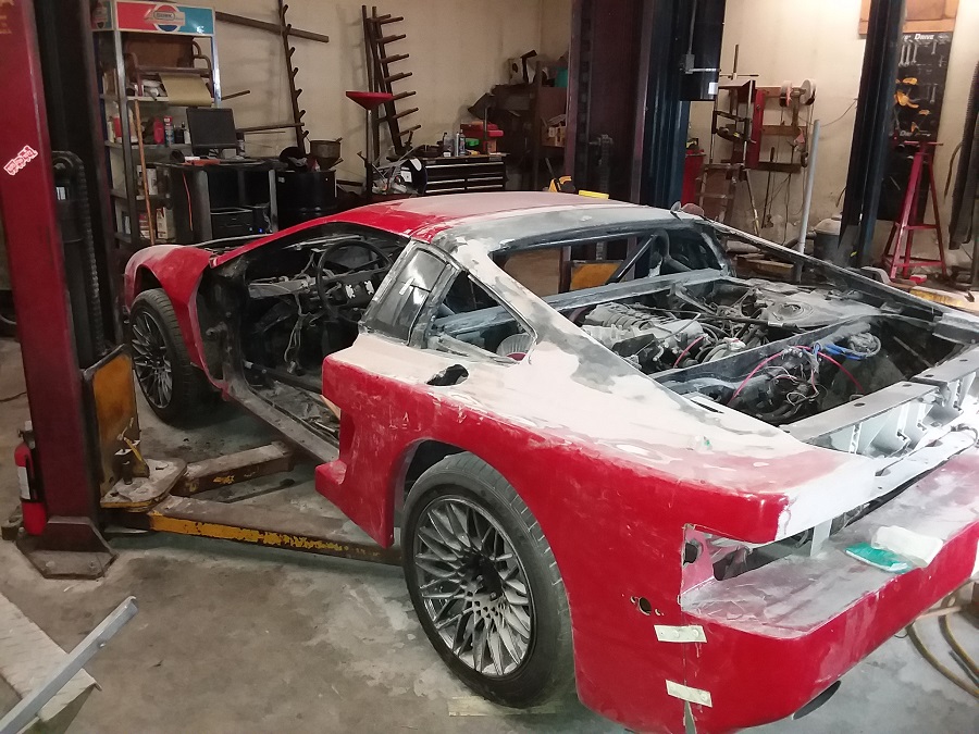

JAN 27, 12:53 PM
well i threw the roof on just to see i did cut it as it needed to be shortened up and i have taken a few days off from it and will get back on it soon but i figure i have until May, as i would like to go to the home depot car show if they have it

Looking great so far, taillights look much much better now.
