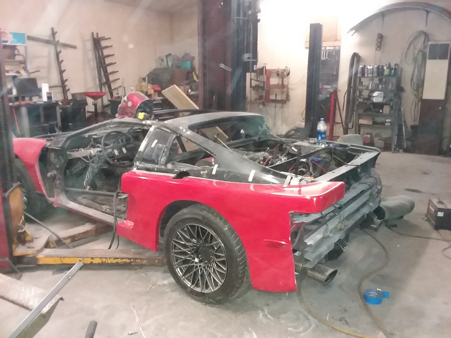

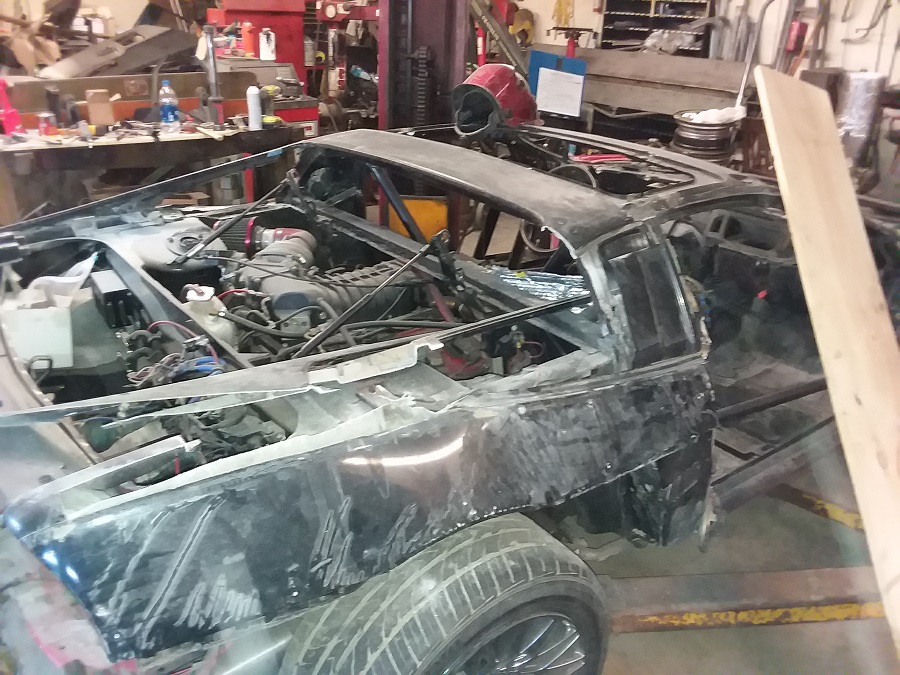

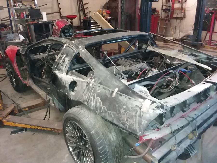

ok i started to mod the GT body first then i will put the Testarossa kit body on the back and glass it in
engine man
JAN 02, 04:03 PM
i had to see if it is going to look as good as think IF i do a good job and i think it is going to look great
engine man
JAN 03, 06:21 PM

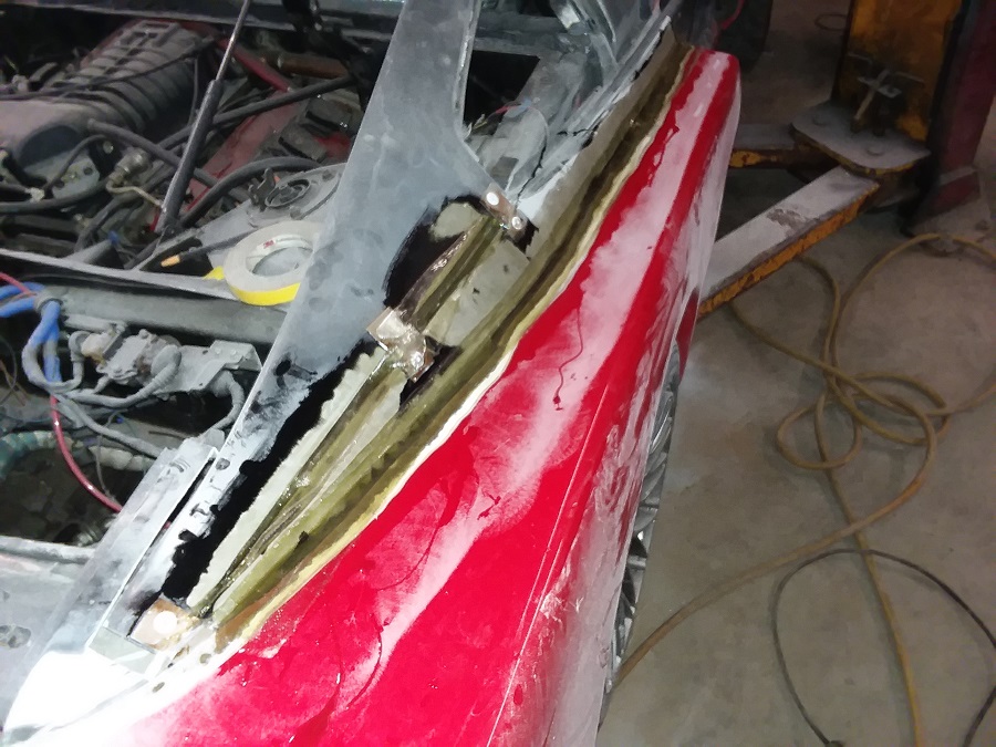

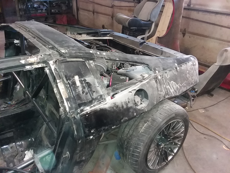

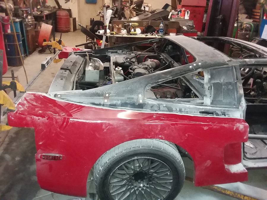

Ok i have both rear quarters up on the car and level now i just need to fiberglass them on and make some braces and fiberglass them in
engine man
JAN 05, 11:05 AM

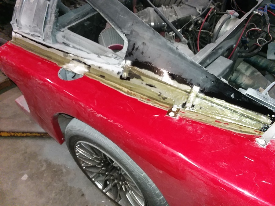

Today i started to fiberglass it all back together this is gonna take some time to get it looking good and be strong
engine man
JAN 07, 07:10 PM

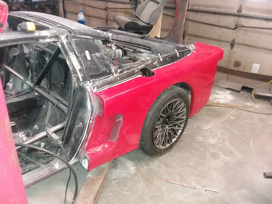

today i got a few minutes to put a few layers of fiberglass i need to work on bracing it from the underside . this thing is gonna be great looking i think even if i don't get it perfect
engine man
JAN 15, 11:40 AM

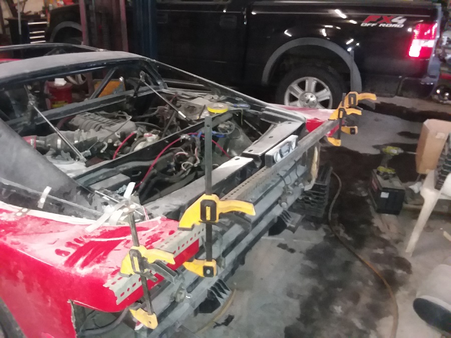

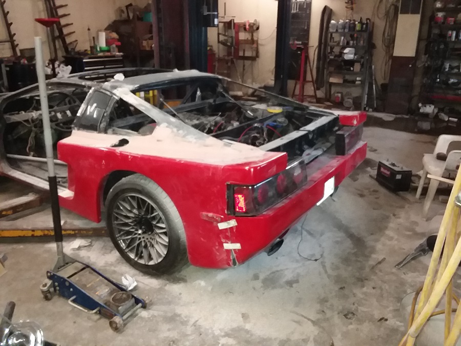

I riveted the bumper back on i moved it in 1 inch and squared it to the top so the gaps around the tail lights ar tighter and even i also put some braces on the underside of the rear body so the right side stayed flat and not tilted from inside out it is slow going but t takes time to get the way you want
RCR
JAN 16, 07:25 AM
Quite the radical change since the last time I popped in.
Very Cool
Bob
engine man
JAN 16, 09:24 AM
thank's RCR sometimes you gotta do what you gotta do and chopper her up
engine man
JAN 16, 03:36 PM

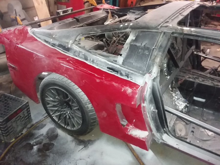

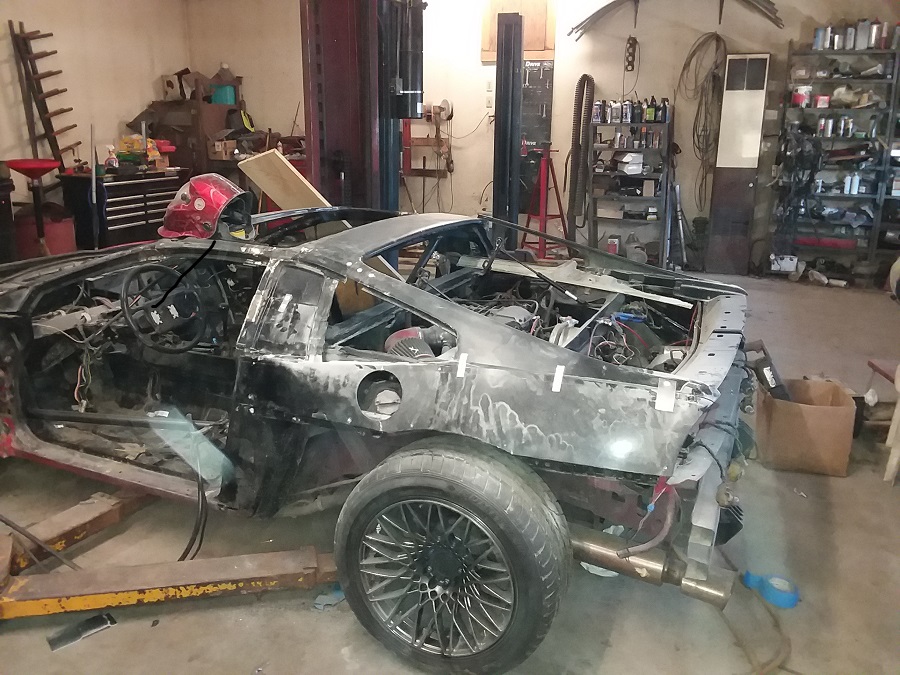

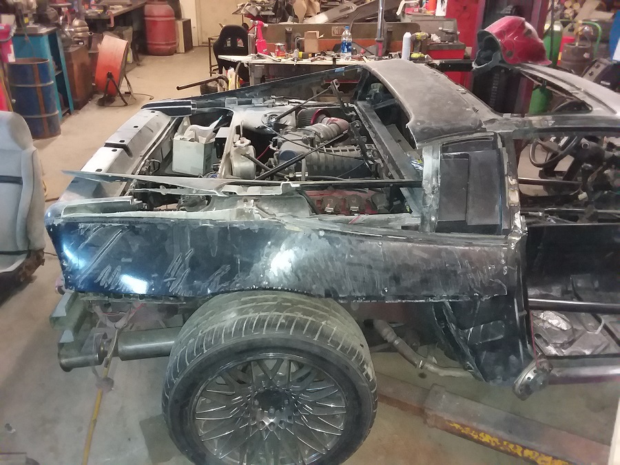

Sanding body filler is just so much fun it is as fun as sheetrock compound oh well this just how it is you sand then put more filler on then sand check it and just keep doing this process over and over until it is good and straight [This message has been edited by engine man (edited 01-17-2019).]
