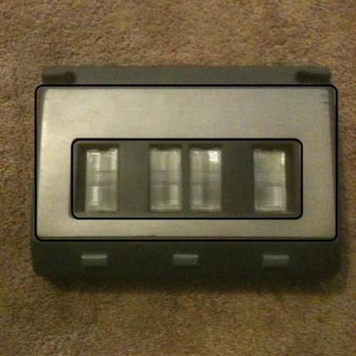

TXOPIE FEB 08, 03:37 PM
Rob,
Can you find out the manufacture and color of the powder coating:
I am thinking about having a cover plate made for the courtesy light panel:
...the area that is raised out...I outlined it in black above.
I think it will help make the car look uniform with the new look...also thinking of pieces around the door handle and locks...thoughts?
