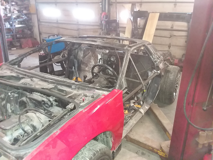

well it is coming along slow as i am trying to get it the best i can to make sure it is all square and right

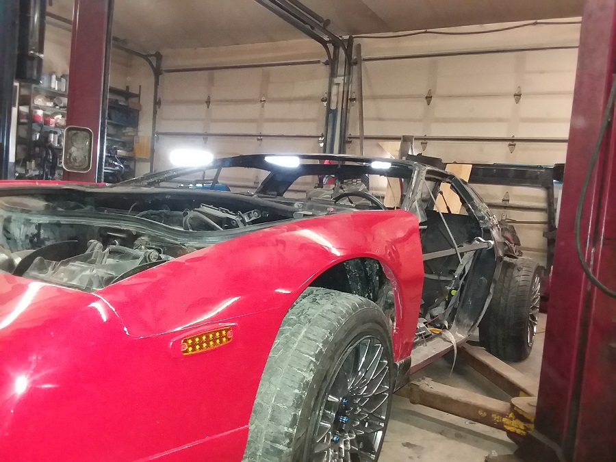

Today i decided that i would be putting in a roll cage it will be a rear hoop with legs that go forward at a angle and some short spuds that go to the rear fire wall right at the rear upper frame rail this should stiffen the car up and i might x brace the rear hoop to give it some torsional twist stiffness [This message has been edited by engine man (edited 12-05-2018).]

waiting for some steel so i can finish this as i like to do some more overlapping to get as much strength

How about doing a windshield swap that brings the leading edge further forward for a more raked look? I think it was a Chrysler sebring windshield others have done? You know, as long as you're this deep into a chop.
engine man
DEC 07, 07:41 PM
Wow it just got laid down about 9 degrees and you want me to change windshields so it is even more laid down that would take way more work than i am willing to do

Today i started to put in a roll cage so it stiffens up the chassis some more i want the car to perform as well as it is going to look
