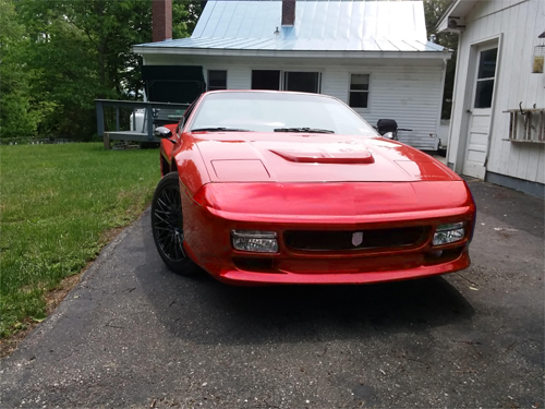

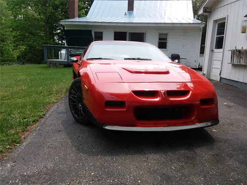

Messed with the bumper a bit too. TBD, I really don't care for the Munson bumper. Here's one with a black spoiler:
And a body colored one:
And since I was borrowing from Amida's 512 bumper, here's the full bumper:
engine man
NOV 04, 06:47 PM
i like the second one and you have given me a vision of what i want

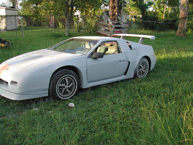

i can see i need to make the lights fit better along with make the rear of the car end with the lights so about 2 to 3 inches need to be cut off along with making a center panell out of acrylic

well this week not much going on in the shop so i will see what i can get done on the car i would like to get the body off and get the top cut as i have looked at how Archie said to do it as i did one once when in FL but i will say it was not done the way it should have been done + i hade a flux core 110v welder no gas now that i have learend much more about it i will do a much better job
