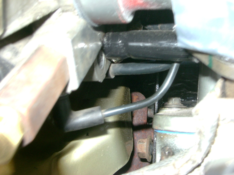

I went out to the car to get some work done this morning at 9am. After removing the distributor cap and rotor I could see that the idle air tube was not seated into the back face of the throttle body. The larger of the two black tubes is supposed to be in the 1/2" hole. I removed the throttle body and added a new 'O' ring into the groove:
After reconnecting it all up, my idle has dropped down to about 1300 RPM in Park. When I put my thumb on the air idle port of the throttle body the engine is just barely running now. SO I still have a small leak I will do some more testing later tonight.
Went back out and removed the throttle body, cap and rotor. I put the piece of soda can underneath the EGR pipe where it connects to the upper intake. All is well in the idle department now. I was able to set the timing at idle instead of at 1700 RPM. I will remove the pipe one day this week and try to find where the leak is. Might just be the gasket, as I had modded a gasket to bolt it all up. It was all we could find at the parts house back then. I have tried Ebay for a Camaro/Firebird one with no luck. I don't really want to pay $100.00 for a new EGR pipe with The Fiero Store.

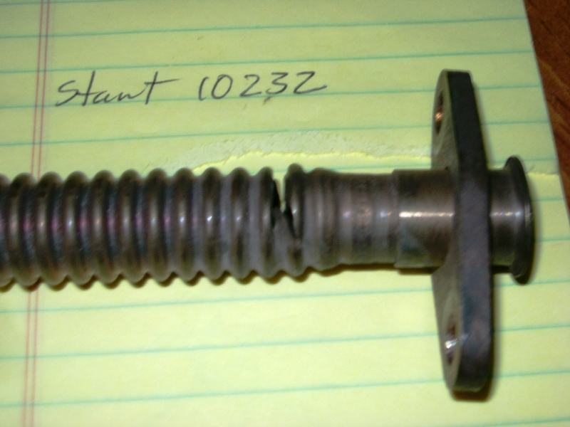

I removed the EGR pipe today and removed the little silver insulation thing. This was open more, but I had closed it a bit with pliers. A bit out of focus, but good enough to see the break.
