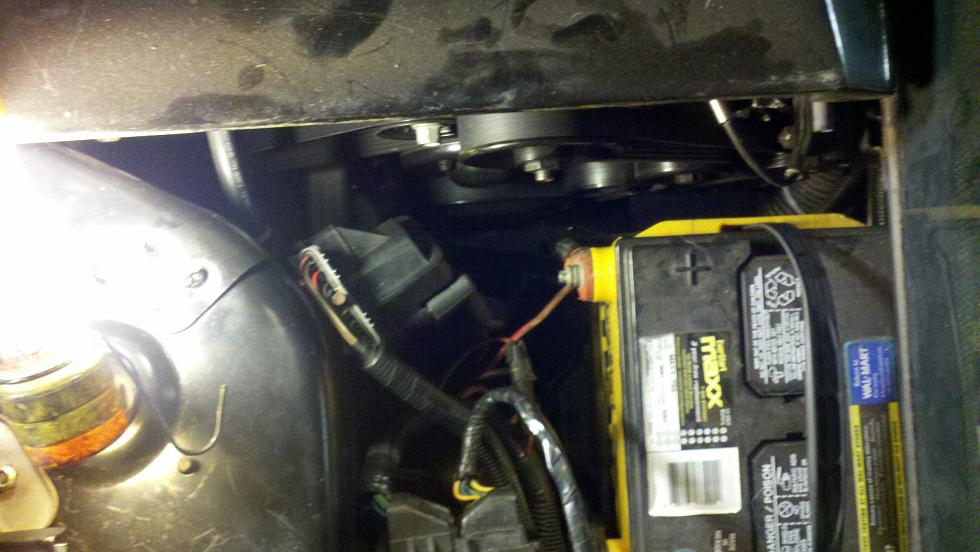

I found that i need to move the motor mounts to the passenger side 1/2' to make the axles equal length. This would allow two 86 4 speed drivers side axle shafts and outer CV to be plug and play into the 4T65EHD tulips. Does that sound right? this is my pulley clearance to the hood as it is, almost even. Whats yours?

RumbleB
SEP 12, 09:47 PM
I noticed that your fuel rail is in the stock position. Why not flip it around so the fuel hoses are not hanging over your serpentine belt. Just thinking safety.
hercimer01
SEP 12, 10:07 PM
I tried but the hold downs for the fuel rail are in different locations when you swap it around. How would you anchor it down?
