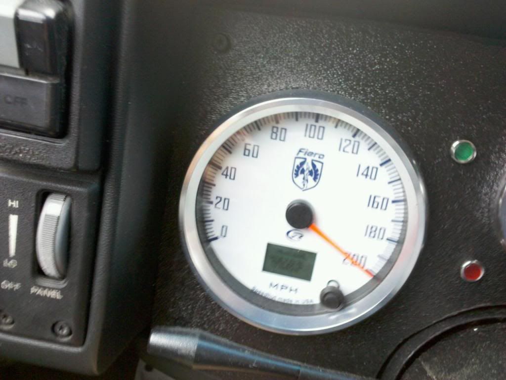

Charlie64
JUN 04, 10:52 PM
Isn't this a wonderful sight???
