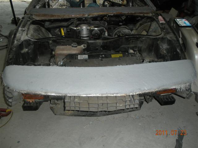

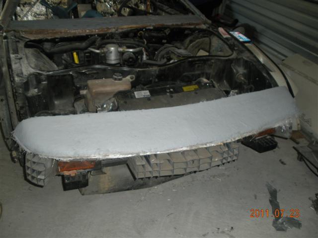

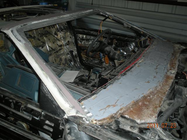

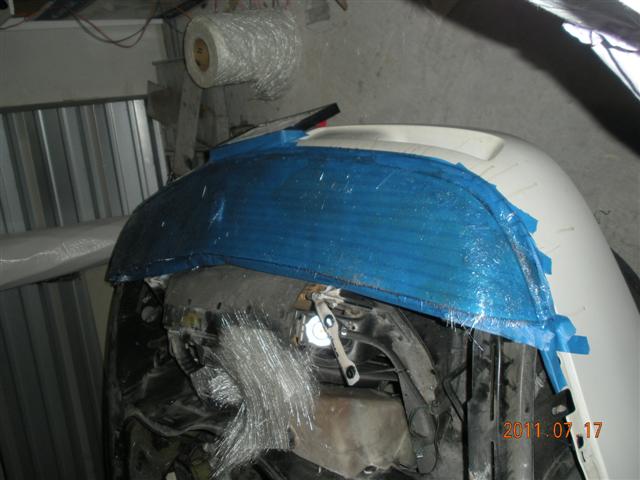

Had a little time to work on the car today. I worked on the windshield area some.
.jpg) I had to fill at the bottom and fill the center at the top. I have a cap to start the bumper with. Not sure how it will end up yet but with the top I will be able to work on the lights.
.jpg) I just used tape it was faster than waxing and less work.
.jpg)

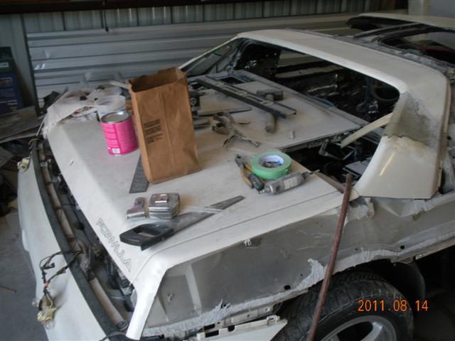

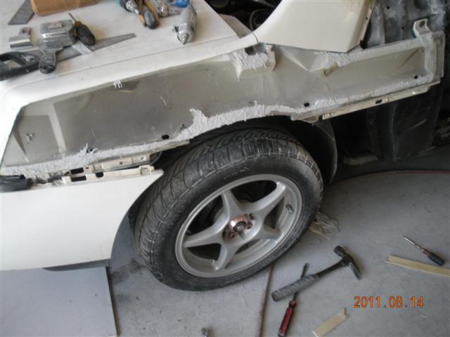

Thanks, I will look into ruff I have the top hoop fitted and the rear hips removed ready to be fattened up a little.
.jpg)
.jpg)
