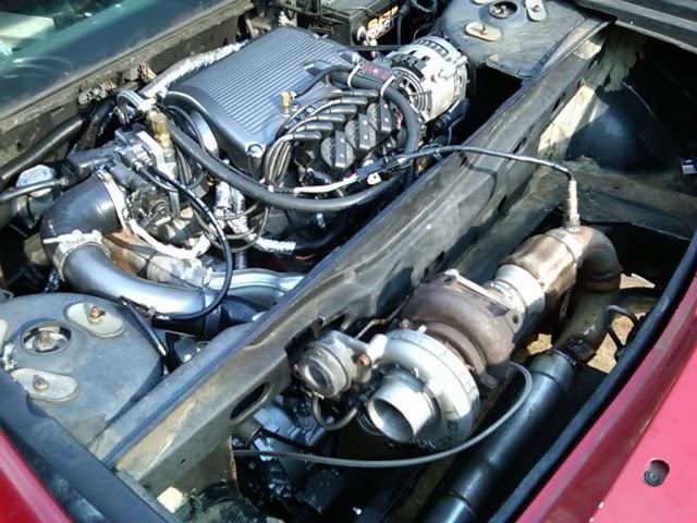

is that braided Teflon being used for the wastegate dump ? keeping in mind that the waste gate only opens when things are hot... how much heat can that braided stuff handle ?------------------
87 Fiero GT 5sp with Vortec L35 4300 Turbocharged V6 Bully Stage 2 clutch Syclone intake manifold and engine management with Moates adapter and chip burner Air/water intercooler and Devil's Own progressive water/alky injection 50lb injectors, 3 bar map sensor, Walboro fuel pump and Jabasco Intercooler pump LM1 wideband on custom manifolds and 3" stainless exhaust system T31 P trim T04B H3 turbo and a S10 caliper conversion. Murphy's Constant Matter will be damaged in direct proportion to its value Murphy's Law of Thermodynamics Things get worse under pressure. Arthur C. Clarke "Any significantly advanced technology is indistinguishable from magic"
Rallaster
SEP 15, 09:02 PM
| quote | Originally posted by vortecfiero:
I thought the W/G opened when the manifold pressure got to a certain point to keep the intake pressure constant...
bmwguru
SEP 16, 06:06 AM
That is not braided teflon as in a typical AN hose. That is a hose I purchased specifically used for a wastegate dump. We had to modify it to fit, but it will be fine. The inside is a flexible metal pipe. The outside has the braided hose on it. Dave

| quote | Originally posted by bmwguru:
That is not braided teflon as in a typical AN hose. That is a hose I purchased specifically used for a wastegate dump. We had to modify it to fit, but it will be fine. The inside is a flexible metal pipe. The outside has the braided hose on it. Dave |
That looks similar to the factroy EGR tubes used on the 96+ SBC and 4.3's... but probably a larger diameter.
