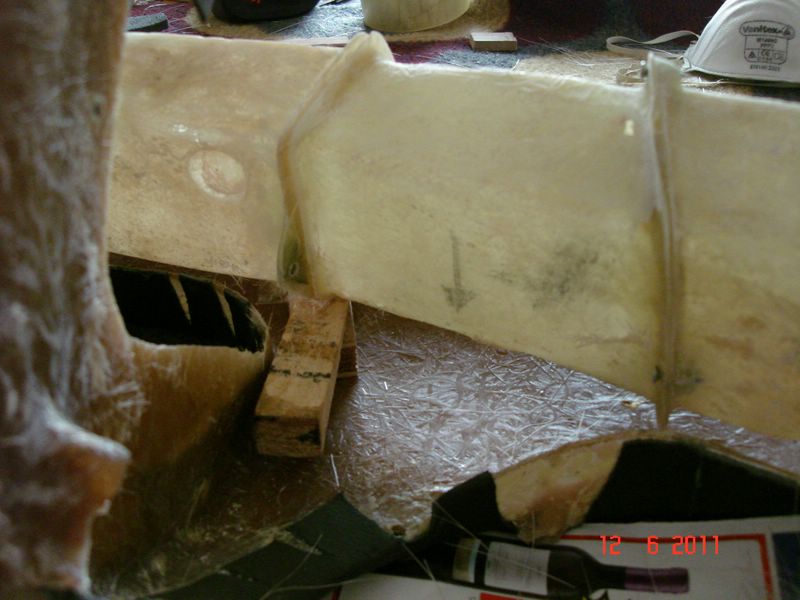

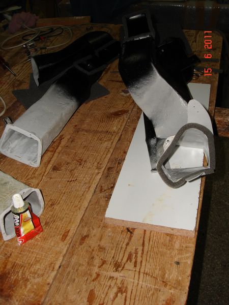

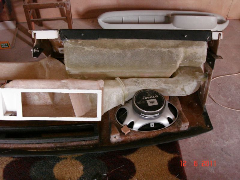

And some update with the work done to the air channels. They are finished and installed to the car and I am happy with the air flow, but I question myself if finally worth all that trouble.
Making again the co-driver's side, to fit the glove compartment.

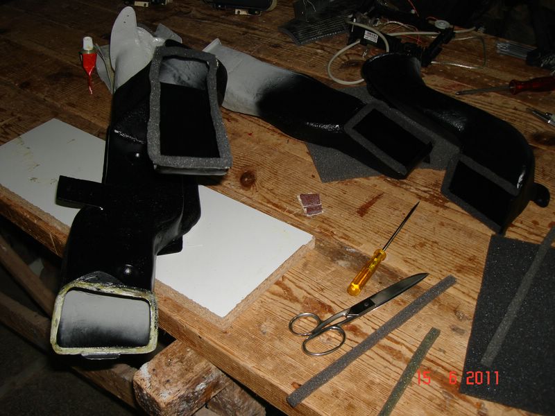

And a detail how I connect the pieces of the air channels (driver side). You can see from the left the small gap between them and from the right I use two screws to keep it together since there is no gap between them.

I use the foam from a pc motherboard to connect the pieces and the Audi air vents (free stuff is the best ).

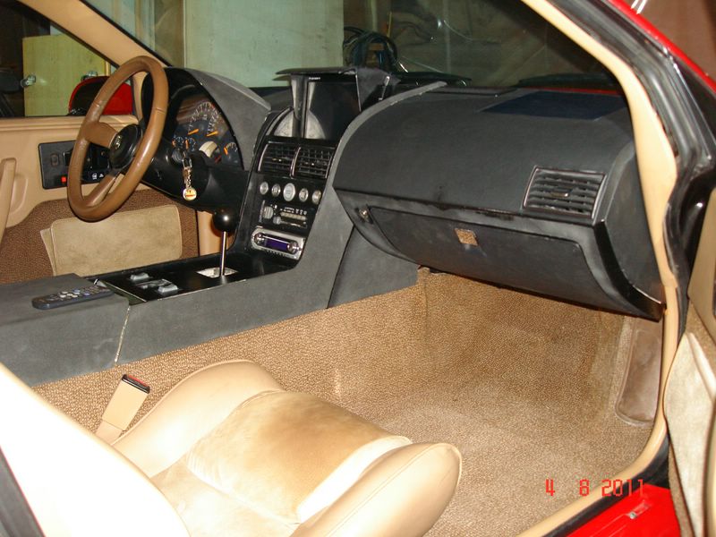

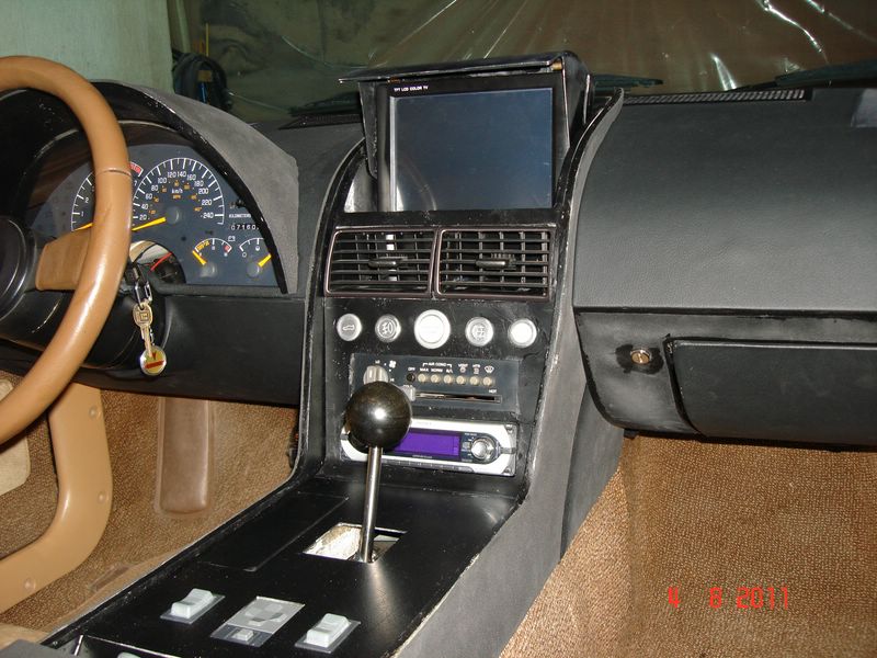

A member pm me for more pics of the interior. This was before summer vacations, but better late than never
