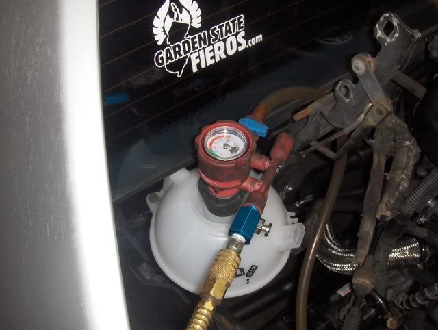

The one I have is about ten years old. It has a few adapters for different cars, but I seem to only use the round screw on one for the German master cylinders. I do on average about six brake fluid flushes a week. The cool part is it gets its pressure from the vehicle's tire. Just put on the adapter. Plug in the quick connect and then put the hose on the tire's valve stem. There is a built in regulator that is adjustable. I have no idea of the brand it is. That faded off years ago. It has probably been used a few thousand times and is still working fine. Dave[This message has been edited by bmwguru (edited 03-22-2008).]

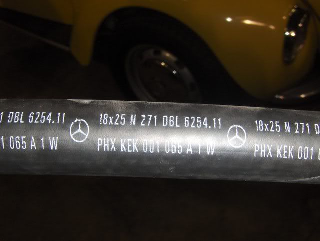

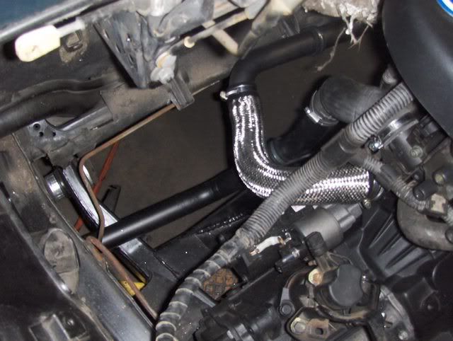

Today we have the cooling system 100% completed. Strangely enough, I think I spent about 25 hours total fabricating the cooling system. When I did my V8, I think it took me three hours (my V8 has solid pipes at the engine...very little rubber hose). Anyway, the cooling system on the VR6 is a little more involved than the SBC. I finished making the feed line to the radiator. I mounted it to the forward transmission mount (which has a nice plate on the front for the pipe bracket.)

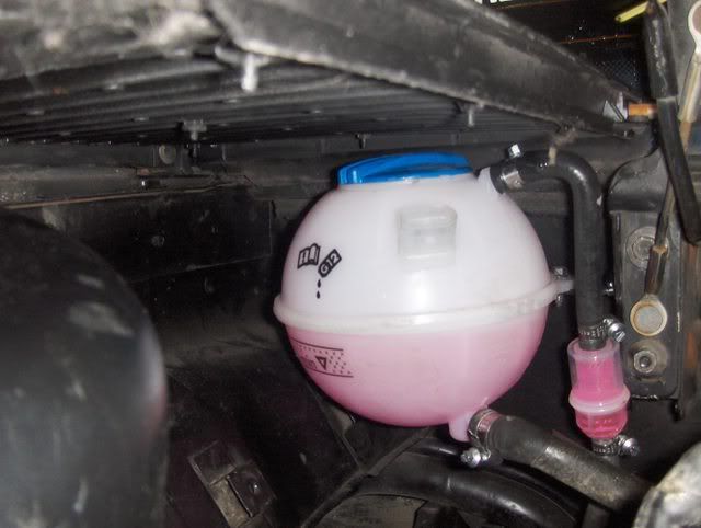

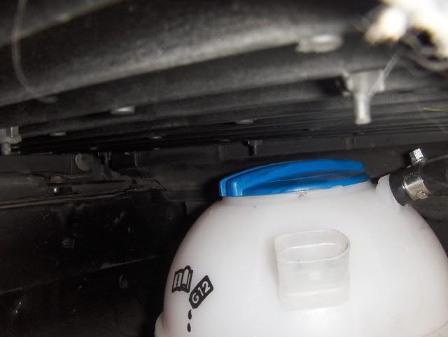

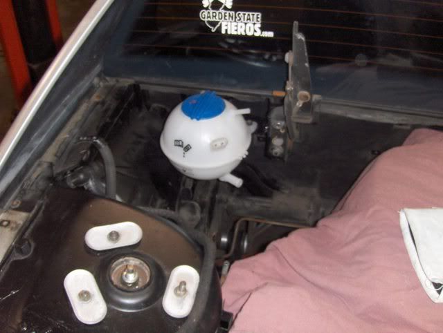

I welded a bracket where the FP and A/C relays used to go. Painted it and then mounted the expansion tank to the bracket. This has to be the highest point in the cooling system and can't hit the vent above it. Kind of tricky, but I got it just right on the first try.

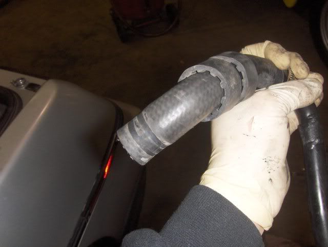

There are tight clearances on the hoses, so I used the factory hose "rubber thingies"...they keep the hose from rubbing against the engine.

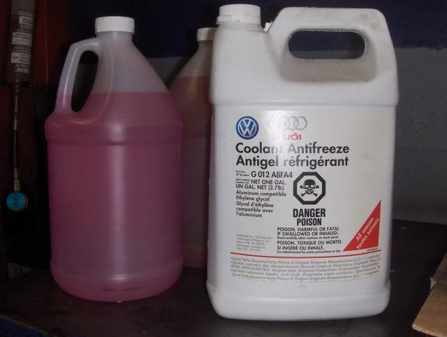

Mixed up the genuine VW/Audi coolant...a 50-50 mix.
Here is the trick to bleeding out your Fieros cooling system.
Here is a pic showing the clearance as well at the cooling system filled. Notice I added a cooling system filter to the system to catch any debris that may be in the engine or anywhere in the cooling system.
 Here is a better shot of the clearance....just right.
