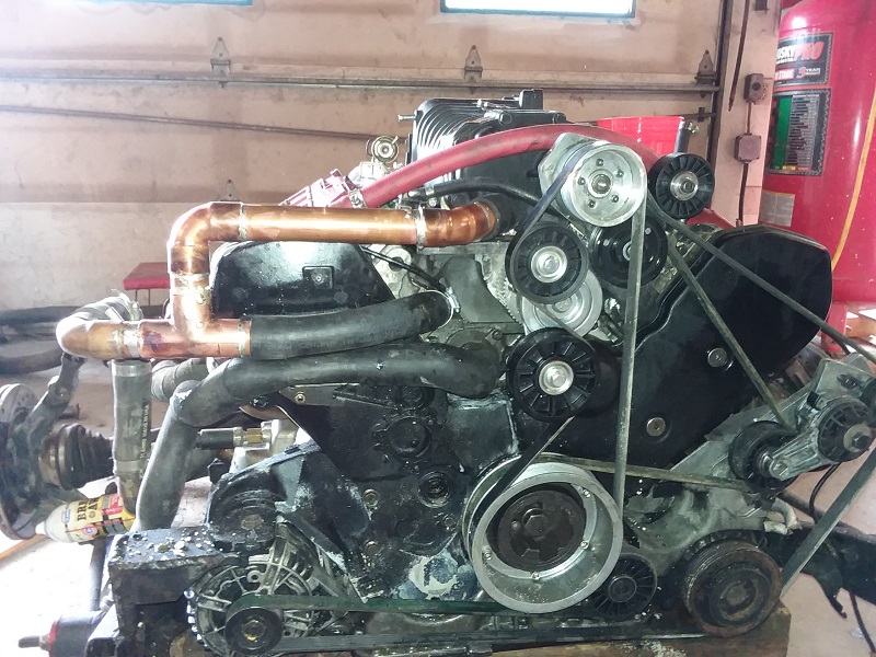

worked on the outer belt idler & tensioner pulley alignment by making a angle shim and i am now happier with the way the belt is riding on them the only thing is i might shim the tensioner pulley out 1 shim as it might make it just that tinny bit better

ok today i finished lining the pulleys up and like where the belts are riding and how they are riding now i need to take the blower off to repair the bypass valve and drill and tap the intake for the intake air temp sensor then a bit of firewall mods for clearance the engine should be all back in this week and running i also want to move the computer to inside the car but that can be done after i get it back up and running

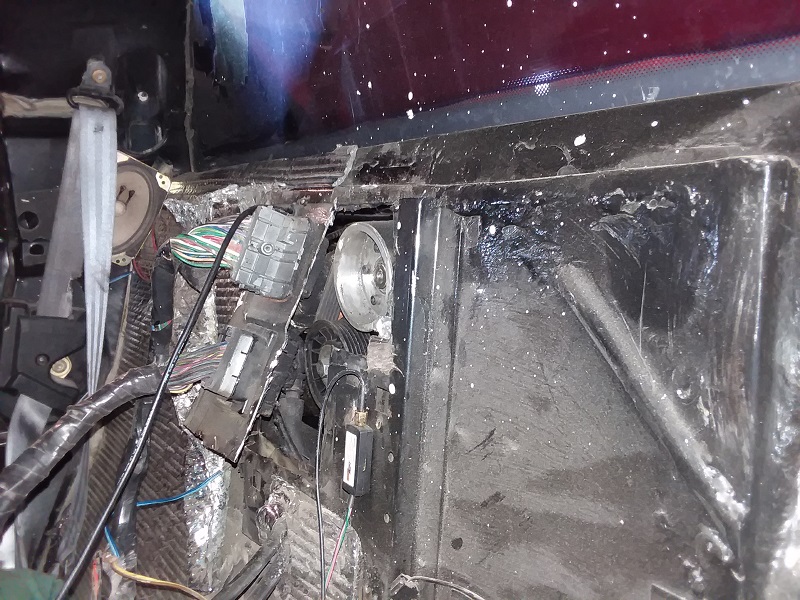

today i did get the engine finished up and now is ready to go in and now i need to do some modification to the fire wall for clearance like need to move the wiring about 2 inches toward the passenger side this is due to the idler and tensioner pulley for the extra belt being on the passenger side

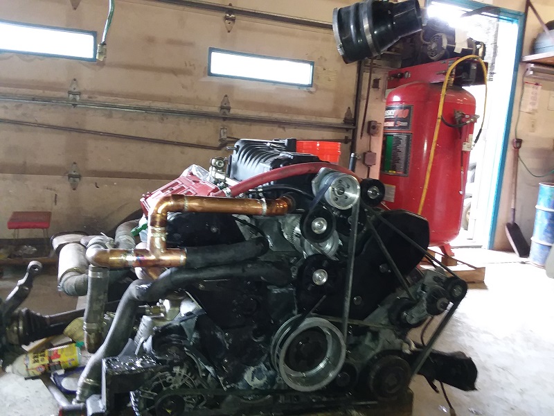

well i need to go to a pluming store as i need to make some coolant pluming up then i can start to install the engine i hope to do this tomorrow it should not take long to put it back in
engine man
SEP 19, 03:32 PM
the plumber must of come by today look at all that nice copper pipe now i can install the engine tomorrow and Friday

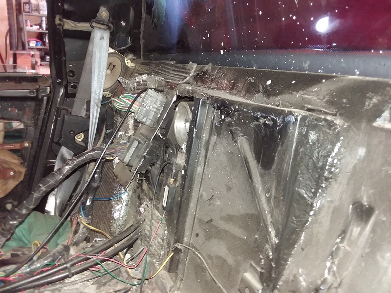

Engine is back up and in but i do need to do some mods to the firewall just need a bit of clearancing

I thought you'd have to do that. lol. Hey Mark am I seeing there are two belts but they have a different route?
engine man
SEP 20, 08:14 PM
yes you are seeing that i needed one to run the alternator and ac pump for when i hook that up in the future but all the pulleys are matched to the same sizes so they are spinning at the same speed [This message has been edited by engine man (edited 09-20-2018).]

today i moved a few things and now there is no issue with interference with the belts and tomorrow i will finish it up and have it running again i am hoping this is the last time i need to take the engine out for anything and i can just enjoy driving it for a few weeks before putting it up for next season

SEP 22, 12:44 PM
