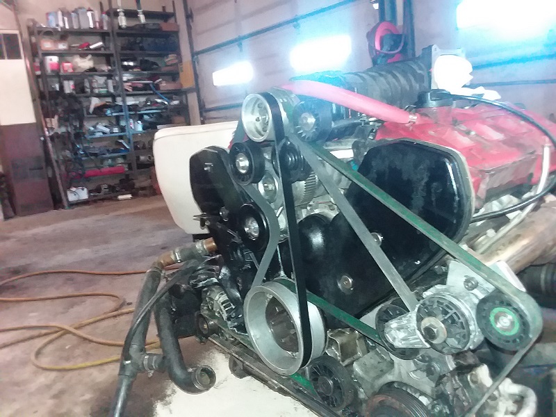

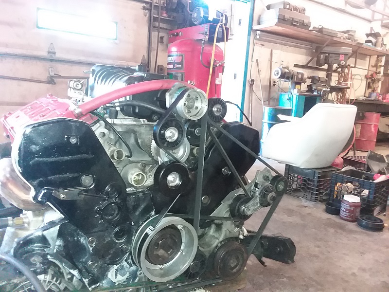

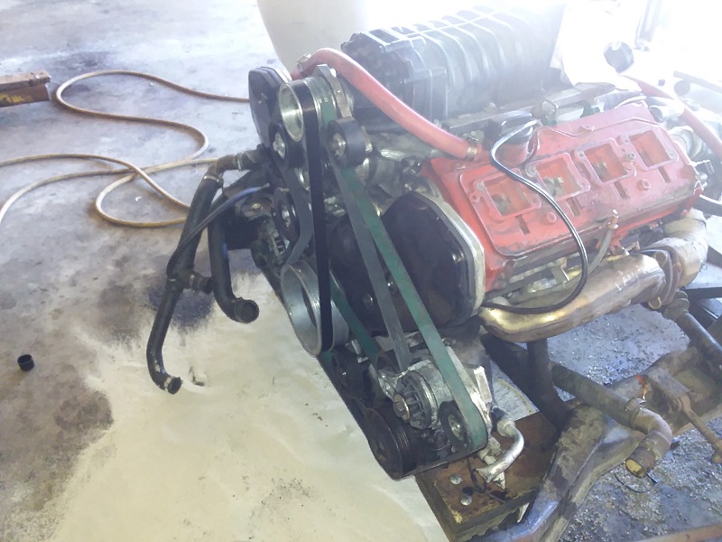

Mark new dual serpentine blower belt system
engine man
SEP 14, 05:39 PM
i think i am going to need to do some more machining for the second belt tensioning system as where i have it bolted to seems to be out of square so it is not square to the crankshaft pulley and every thing must lineup and be square to the crankshaft pulley
