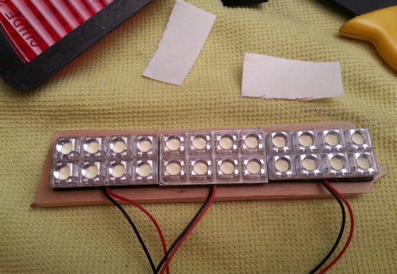

Anyways, well I contemplate how I am going to remedy this, I had taken the 3rd brake light out while messing with the headliner, and decided to convert it to LED tonight. Both the brake light housing from the car, and an extra one I had, are melted pretty bad from the heat of the bulb. I took the better of the two, and set out to convert it. I had some extra LED panels left over from re-doing my dome lights, and decided to put them to use. Be forewarned, It is far from professional job! It is rigged together, but gives the correct end results!
First, I needed something to attach the LED panels too, something to hold them in place. I looked around, and saw a paint stick, perfect! A little trimming later, and see how things line up:
I cut the wood down to the correct size to fit in the 3rd brake light housing. I wanted the LED's back about a 1/4 inch from the lens, and not directly mounted to it. This allows for some light scattering, and fills the whole lens with light, and you do not see just individual LED's up against the lens. I then peeled the sticky backing off the LED panels, and stuck them to the paint stick:
To make sure everything was secure, I ran a bead of hot glue around the edges of everything:
The end result, nice BRIGHT brake light, and no more melting the housing from the heat of the bulb! It is much brighter that it looks in the picture, as my S3's camera reduced the shutter time to compensate for being pointed directly into bright lights! (The same work lights are still on in this photo, the same as the above photo's)
