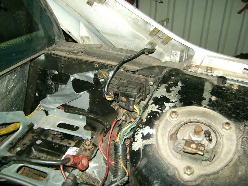

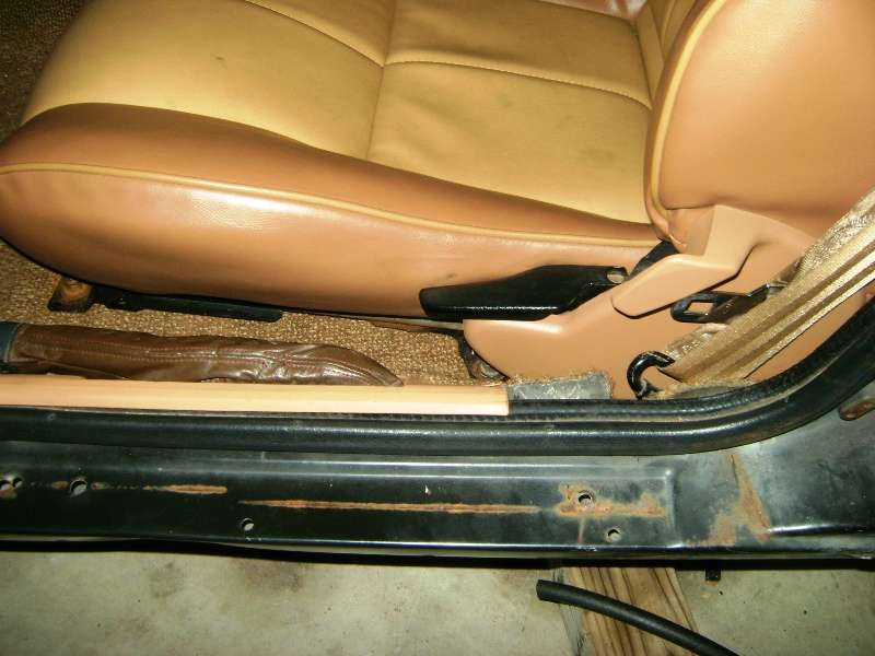

This morning I put the 'C' pillar trim back in the car, and added the seat hinge cover to the seat. Back in the car and bolted down.
Moved the start signal wire in the engine half of C500 from A4 to E2. My car thinks it is a stick shift car, so I just re-pin that one wire socket. C500 and Battery 12V+ wires mounted and tight.
Put the C203, ECM connectors and the ALDL part of the harness inside the car. Added the retainer clip to the plastic pass threw connector.

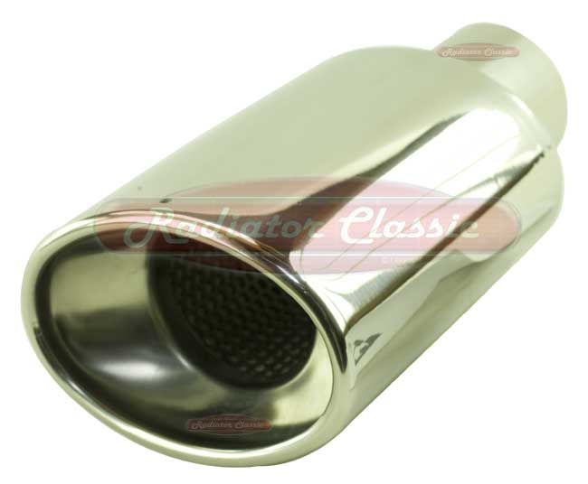

Ordered me a pair of these Stainless Steeel, with resonators:

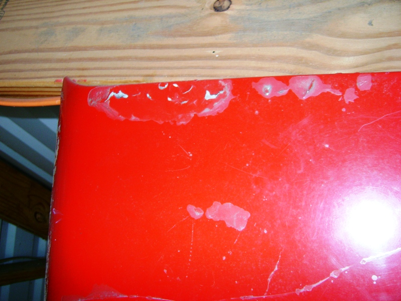

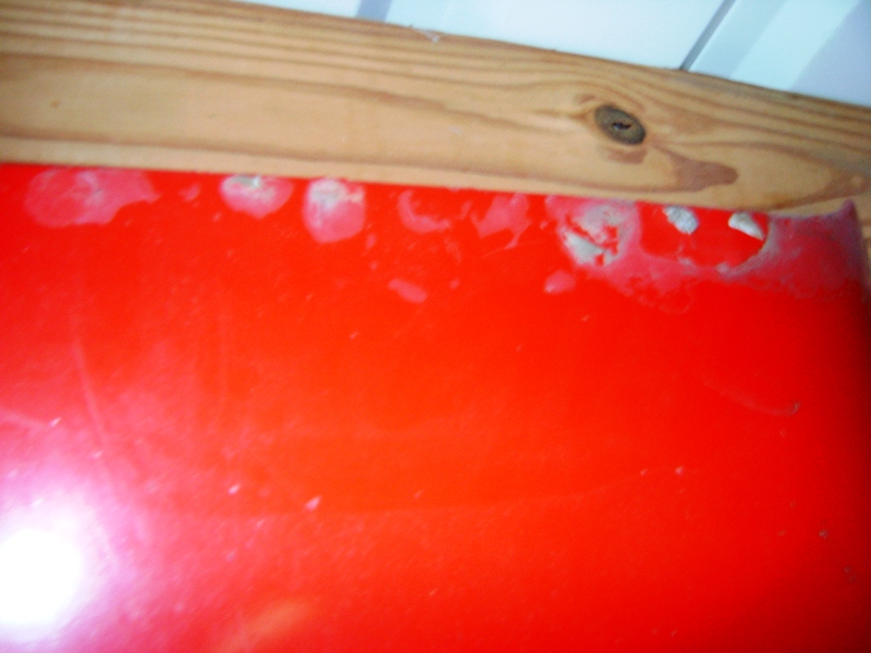

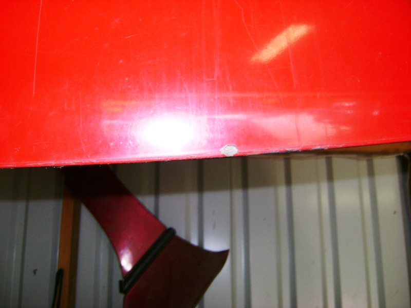

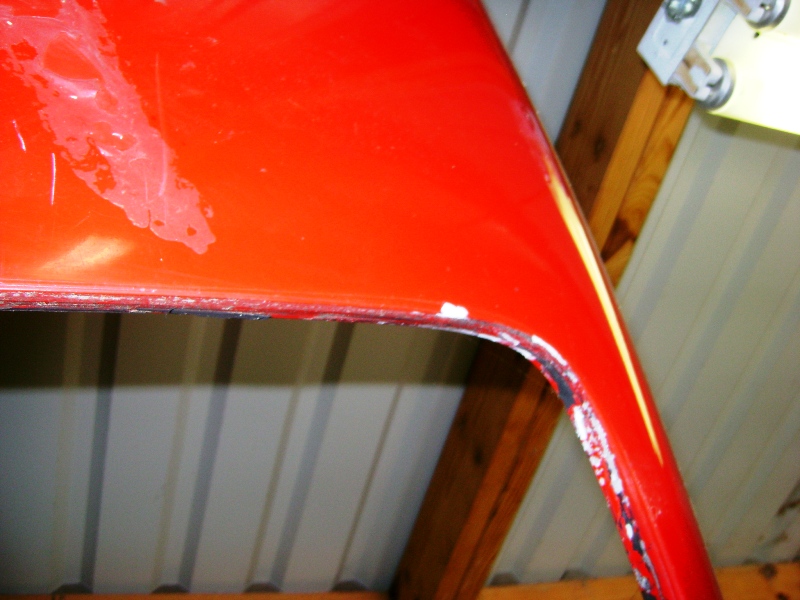

Imperfections in the roof section I need to fix before I can paint. I only want to fix it one time.
and
and
and
