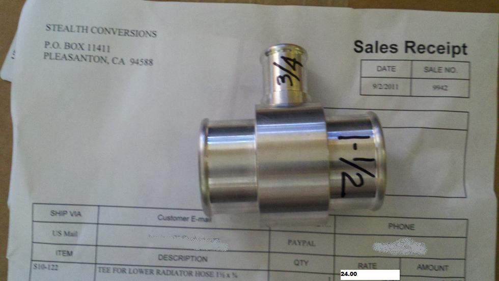

hercimer01 SEP 05, 07:21 PM
No luck starting it today.
I still need the coolant tee for the passenger side so hook up the heater core return to the main line. I hasn't come in yet.
I still have to change the trans fluid filter and fill it.
I still have to pull the Tach wire at the PCM, I guess it goes only the the Tach.
It still doesn't have an exhaust but I still want to start it at least with out it. That should be here tomorrow.
Oh and make the axles.
hercimer01 SEP 06, 01:54 PM
Yay!! This ones a little big, but it worked . Next time get the next size down on the Main hoses.

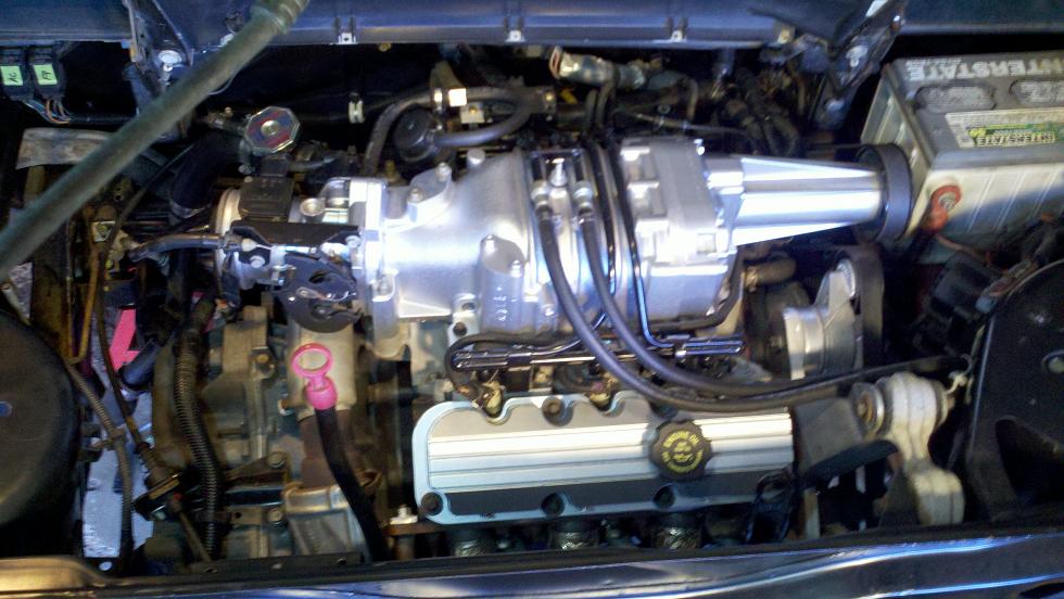

hercimer01 SEP 07, 02:10 PM
: Its Alive!!
Edit: No Exhaust Yet.
