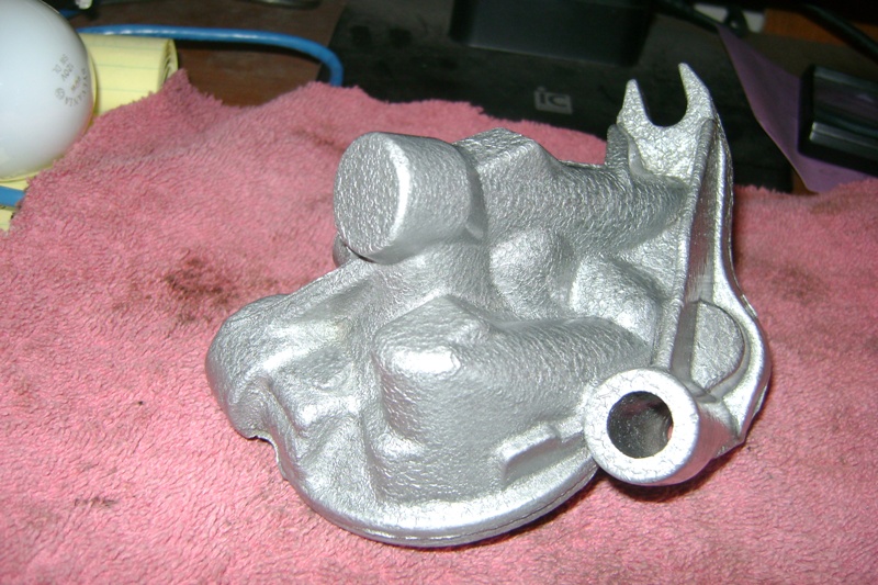

I cleaned and painted the oil filter adapter this afternoon. I used silver 'Hammered' looking paint on it. I will put two coats of clear engine enamel over the 'hammered' silver in the am after the dew burns off. It was 47* this morning at 700am, lots of dew. Had a breakdown on the tracator this morning and didn't get to do all I wanted to the 4.9.

Oil filter adapter painted with hammered silver, and two coats of clear. I'll put it back on the car this afternoon.
Tuurned out real nice and back on the engine:
 [This message has been edited by josef644 (edited 11-13-2009).]
