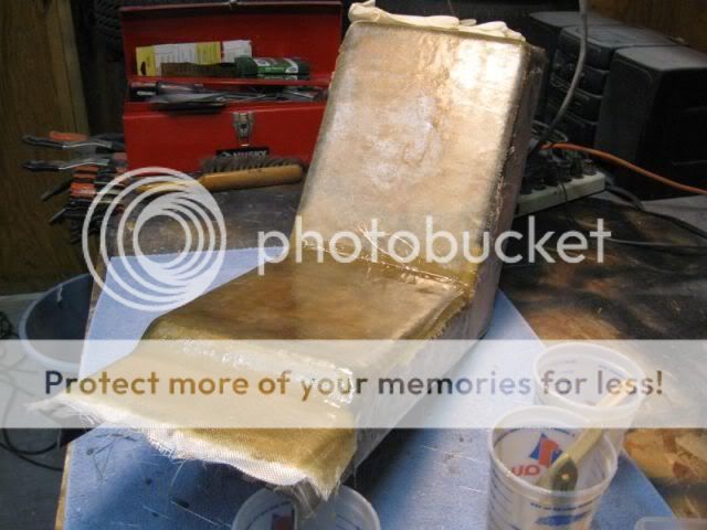

Not much to report today. I got a lot done but it's more of the same from the past few pages. I started laying glass on the rear console last night and continued today. Made good progress and went through a lot of mat, cloth and resin.
A few shots of the console as it sits this evening.

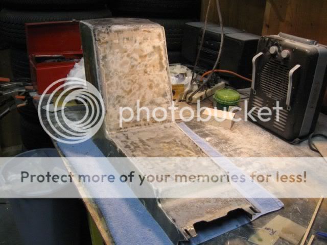

Sanding started:

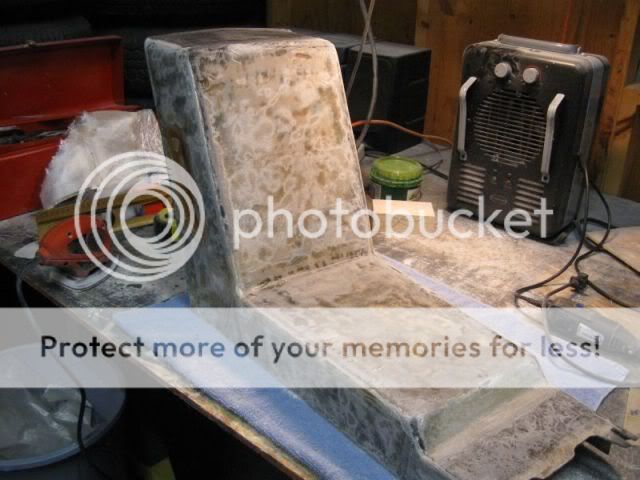

Sanding finished:
And a little filler to smooth out some rough spots before more glass:

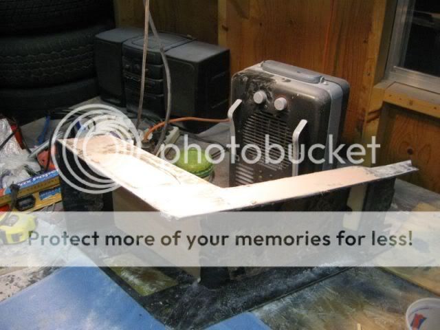

And my entry for the unofficial PFF Fiero Build Art Contest - Abstract Catagory!

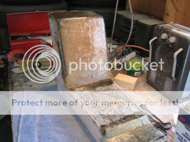

It was a rough day in El Paso. We had 86 mph winds and I spent most the day chasing lawn chairs, tables, garbage cans, Fiero parts, etc around the neighborhood. My workshop is not air tight so this afternoon, around 3 pm, the wind started to die down. I went out to the shop and spent an hour cleaning the sand out. Once the shop was cleaned up, all the lawn furniture back in place, the Fiero parts stacked back up, I had a little time to work on the console.

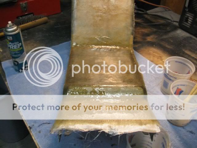

Nothing exciting. Just laying more layers of glass to get the overall size and shape that I am after. Once I get it close, I will start the finish process. It's kind of boring right now. Cut the mat to size, mix a batch of resin, spread the resin, lay the glass, roll it out, and repeat.

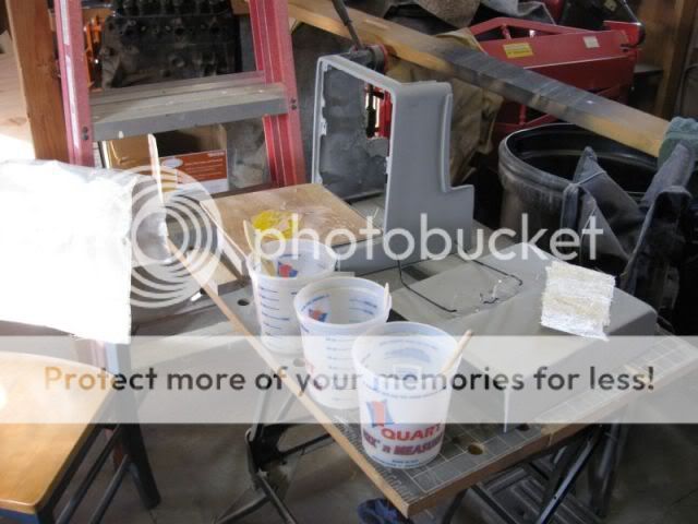

After the cleanup, I got organized:

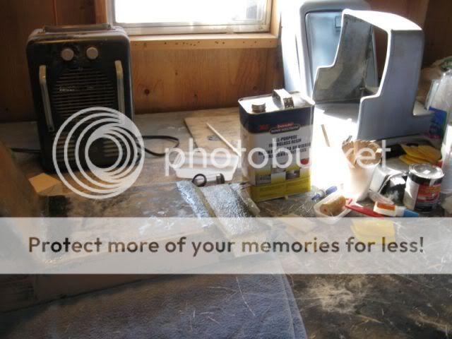

I got tired of messing around with the "child" size cans of resin and picked up some "man" sized resin:
A great tip from Sofa King. I was using plastic drink cups to mix my resin in. About the time it was starting to gel in the cup, it would eat through the bottom and would make a nice mess. Per SK's suggestion, I picked up a few of these plastic mix buckets at Lowe's. These work great. Once the resin sets, just peel it out. Now if you leave resin without hardner on the plastic, it will soften it and I imagine eat through it if left long enough. A quick swipe around the inside with the brush and it will cure and peel out when set.

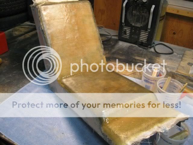

Waiting to cure:
