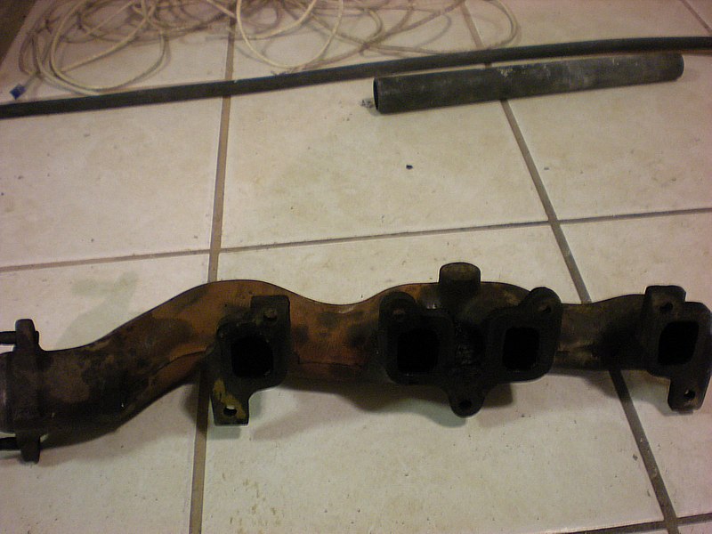

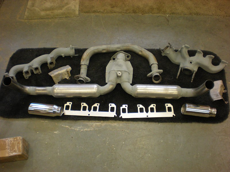

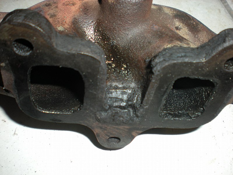

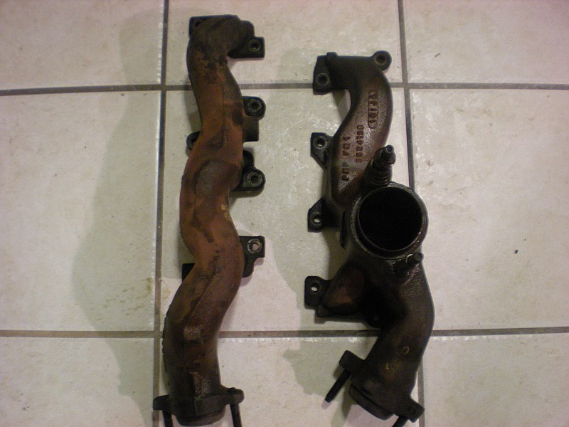

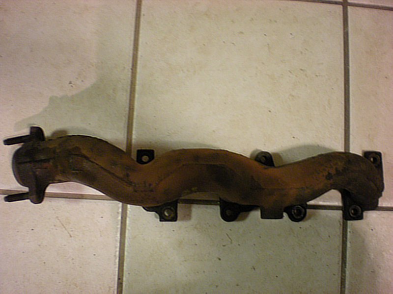

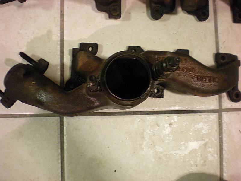

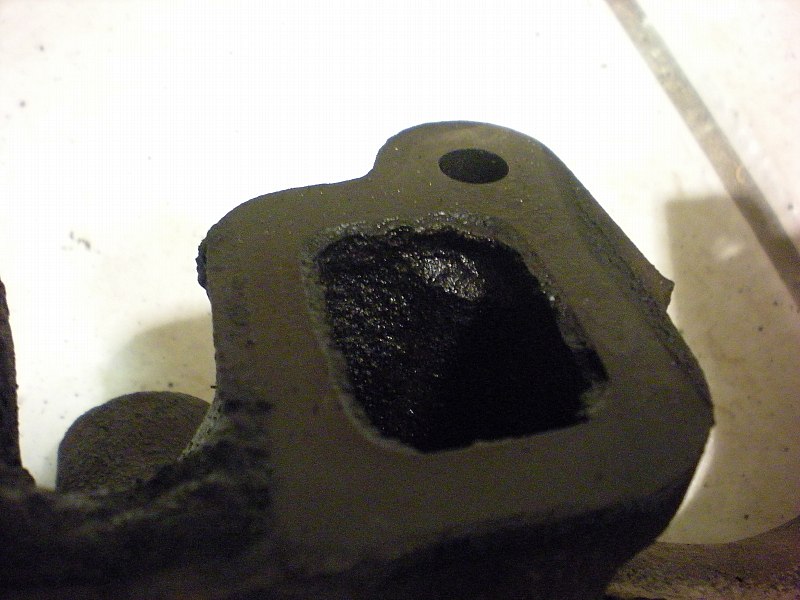

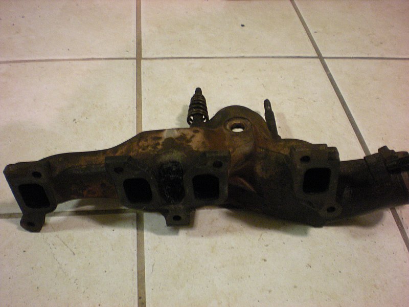

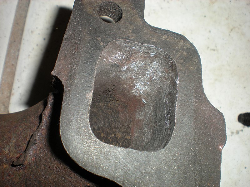

First I went to the wrecking yard to find the new set of exhaust manifolds that I wanted to use. I chose a set of cast iron manifolds off of a 92 deville. They looked like crap, as most yard items do before cleanup...

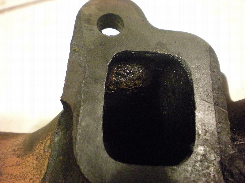

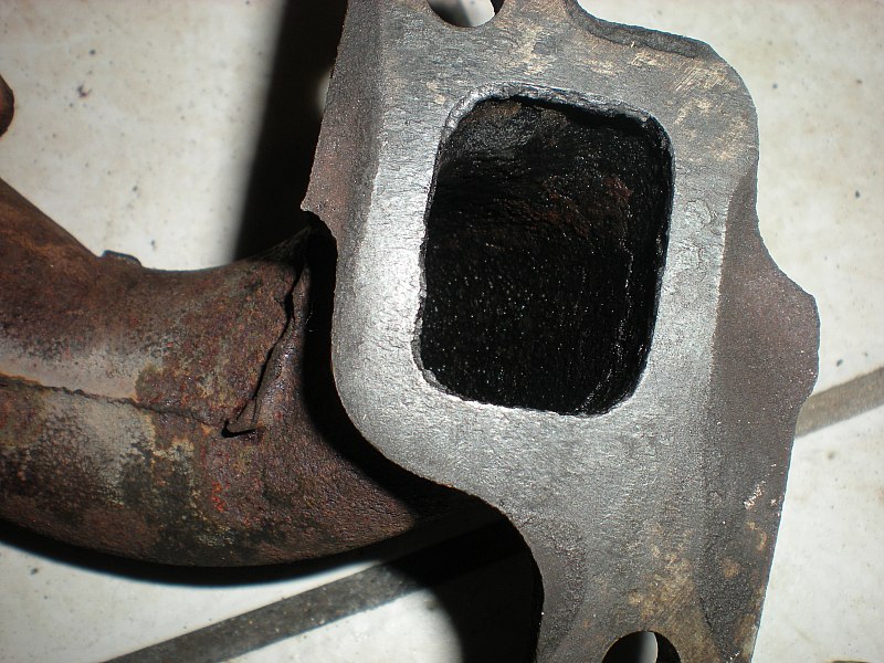

They had huge carbon deposits inside. I spent many hours cleaning them up.

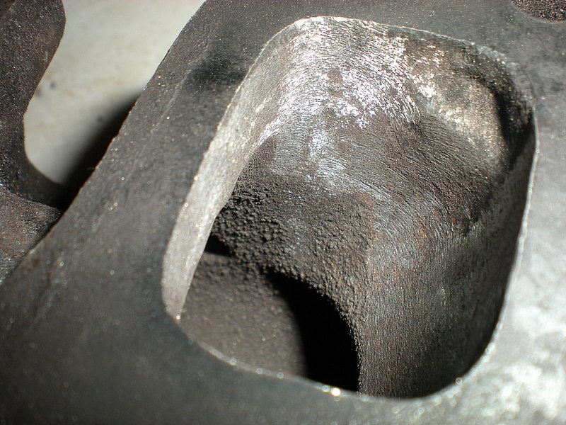

After a few hours with the die grinder most of the carbon was removed. I also spent some time smoothing the transitions for better flow. They were also matched to the gasket. They are as good as I'm going to make them.
They turned out well in the long run...

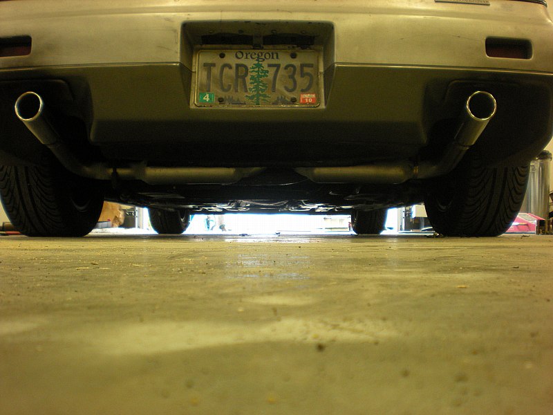

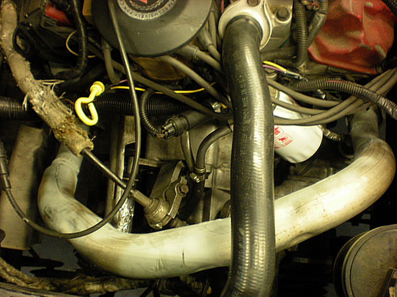

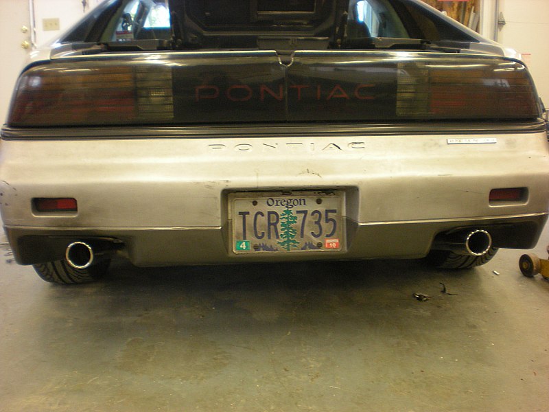

That was the easy part. Now to eliminate the fiero muffler and redesign the setup. I wanted it short and sweet. I don't have pics of the build left. Here is a pic of the entire completed setup though. Also a pic of the new crossover pipe, modified to clear the getrag cables.
And a couple on the car...

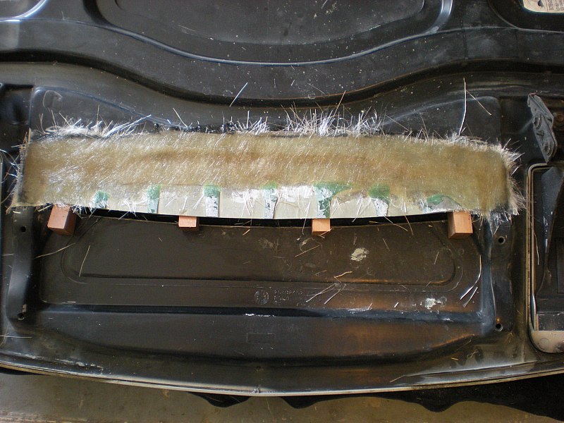

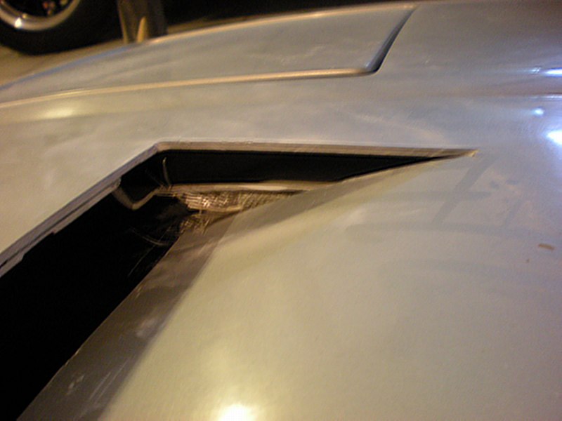

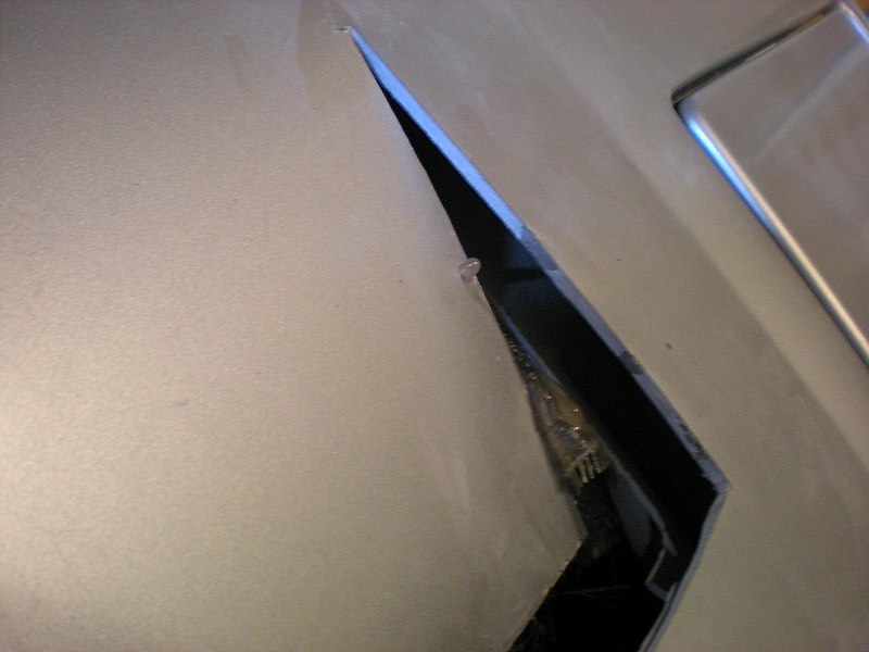

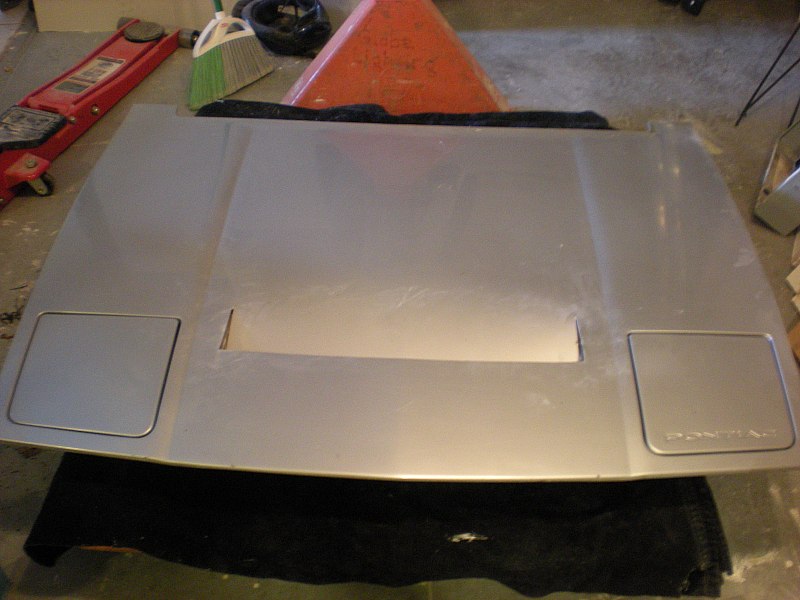

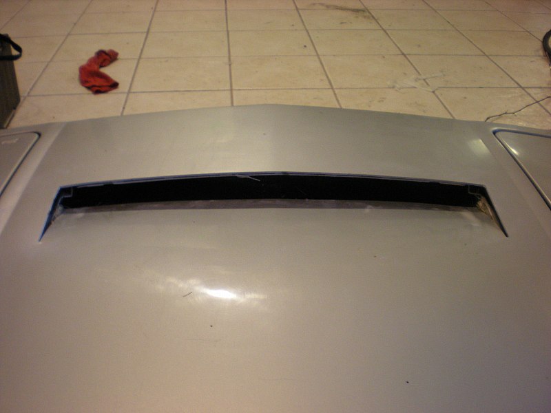

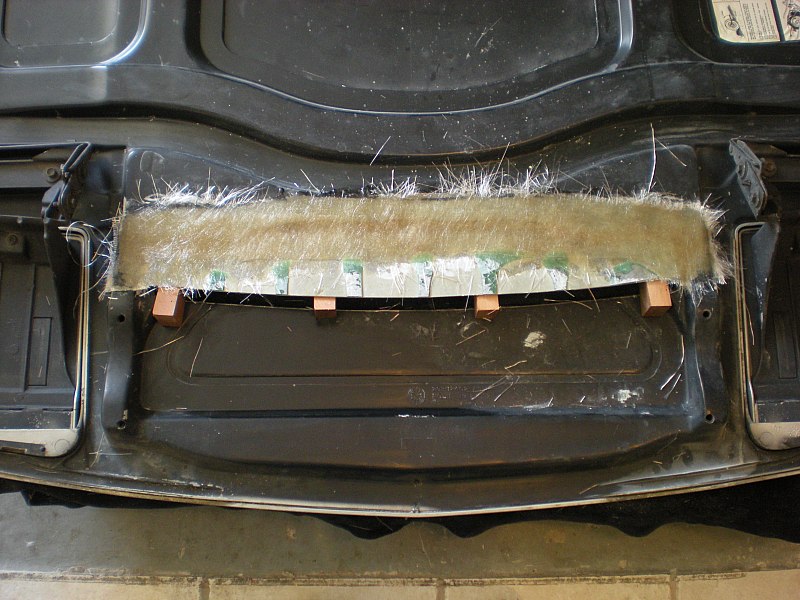

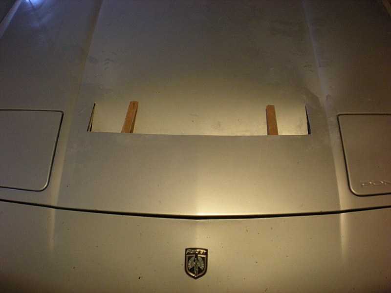

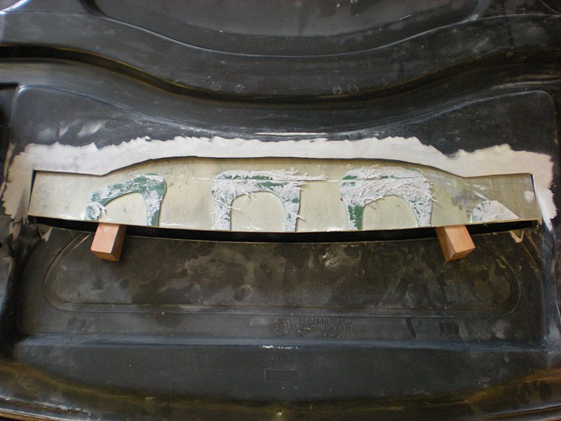

The next major project was the beginning of a hood vent. Its still not complete at this point but its functional. Finish work will be completed this spring after some work on the garage has been completed.

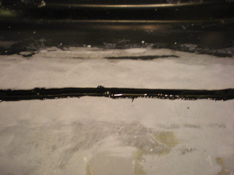

Glass work done. Still have to fill the corners and add the mesh to finish it off. The car feels much more stable at high speeds now. Well worth the trouble.

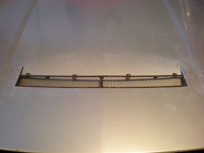

The mesh I'm going to use will be a fiero dash defrost vent. It fits very well in the hood.

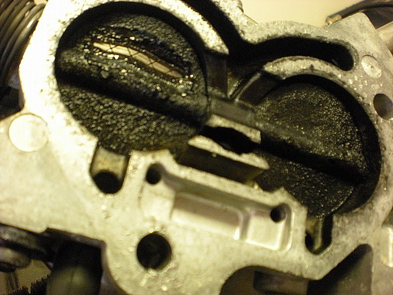

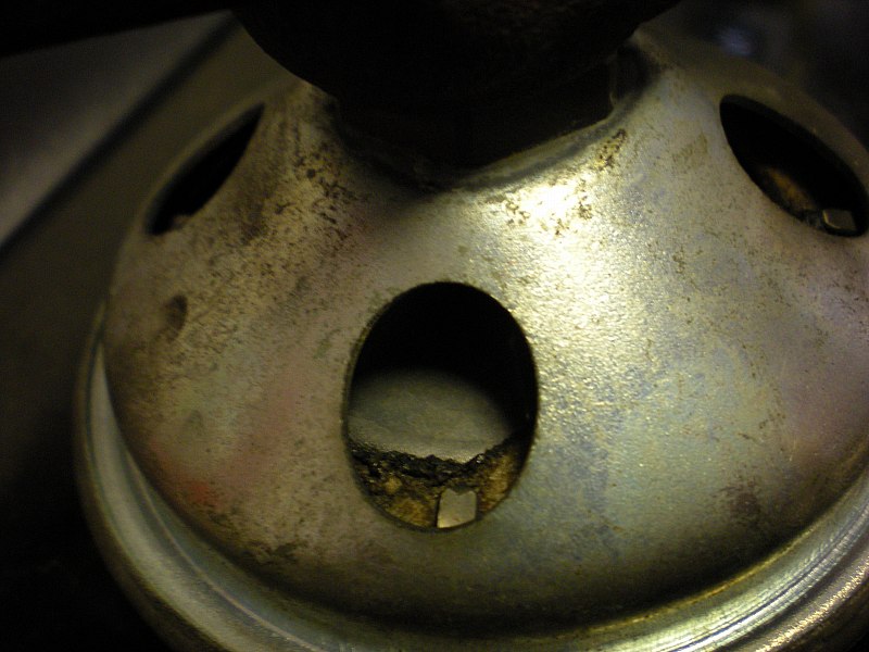

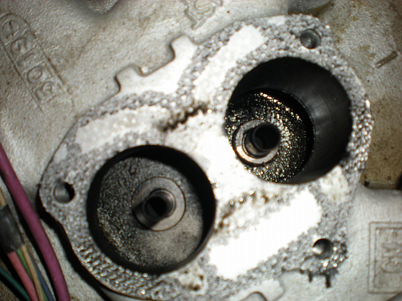

I also spent some time fighting an emmisions problem. It ended up being several issues stacked on top of each other. The car did finally pass though. One of the issues was the EGR valve itself. It somehow burned up and stuck in the open position. This lead to a massive amount of carbon buildup inside the cylinders and intake manifold. It was ugly!!
Underside of throttle body. Keep in mind this was after 4000 miles on a freshly hot tanked and rebuilt motor.
Now that's the kind of tweaking I like to see. Using Fiero parts, but moving them around.
Good one Sir.
Fieroseverywhere FEB 17, 09:42 PM
Good one Sir.
Thanks. Its just sitting there in the pic. I hadn't even cleaned off the rust yet. Wait til I post the completed one.

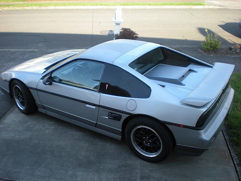

On a good note I've just ordered a pair of ASA AR1's in 17x8 for the rear. This along with a new set of tires and some minor suspension changes coming over the next couple weeks. New tire sizes are 225-50/16 front and 245/45-17 rear. Still lightweight but a little more width in the rear. Then I start the body work. The new job (hehe, 3.5 years now ) is doing great and with a place to do proper fiberglass work I will be starting that after the suspension.
I have a special project in the works for the hood. I plan to start the body work there. I think it will be an "automatic" favorite on the forum.
I'll post a few pics next weekend of the new stance. Later

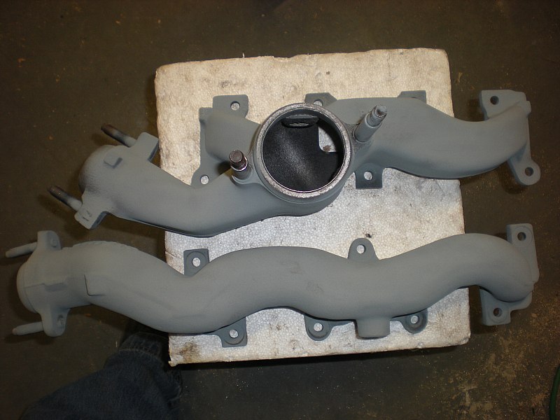

Last thing I did last night was remove the exhaust. The manifolds and crossover pipe also followed me to work today. They were in need to some time in the blast cabinet. They also spent some time with a grinder.
When I got home today they got the finishing touches. They still need to be cured. VHT flame proof silica-ceramic header paint. flat black.
