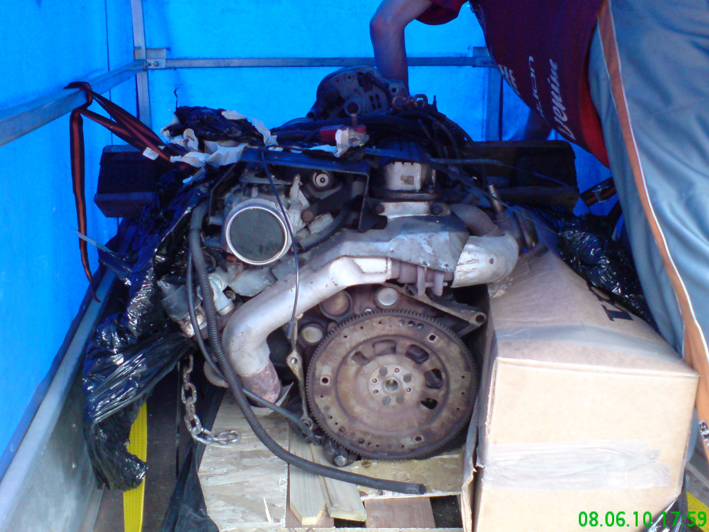

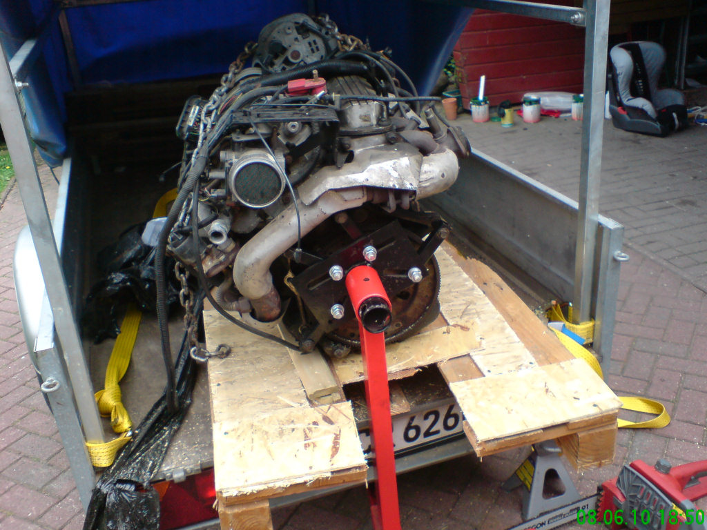

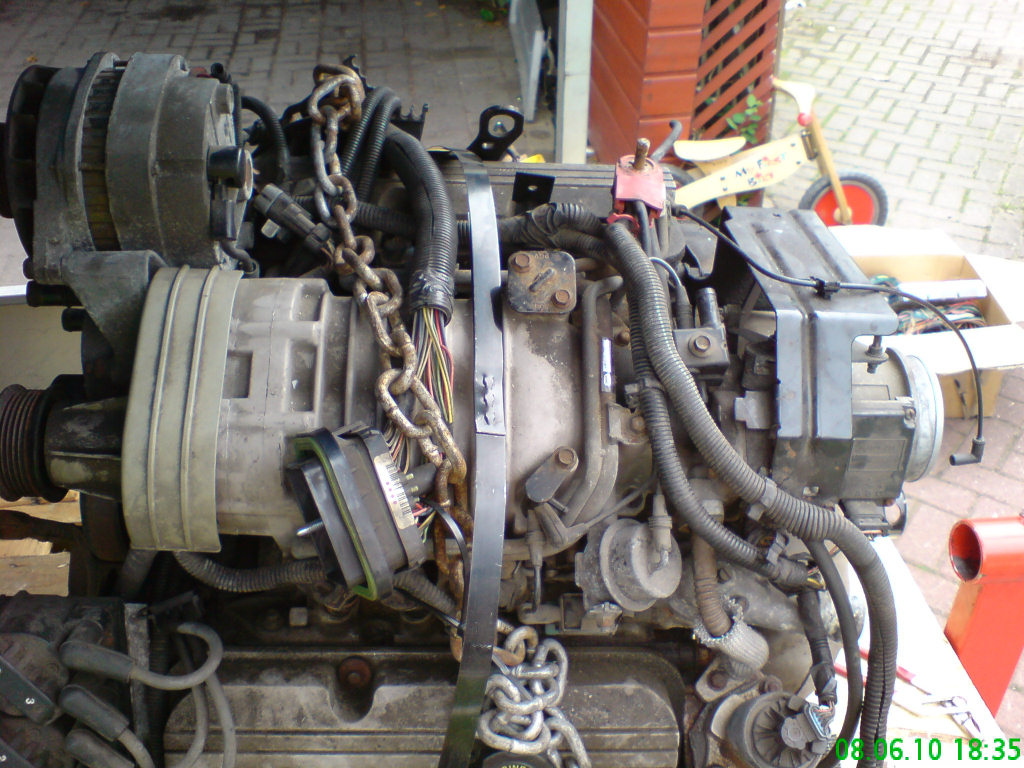

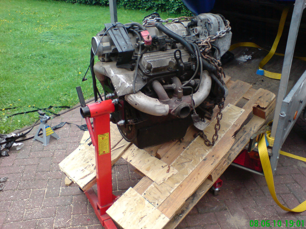

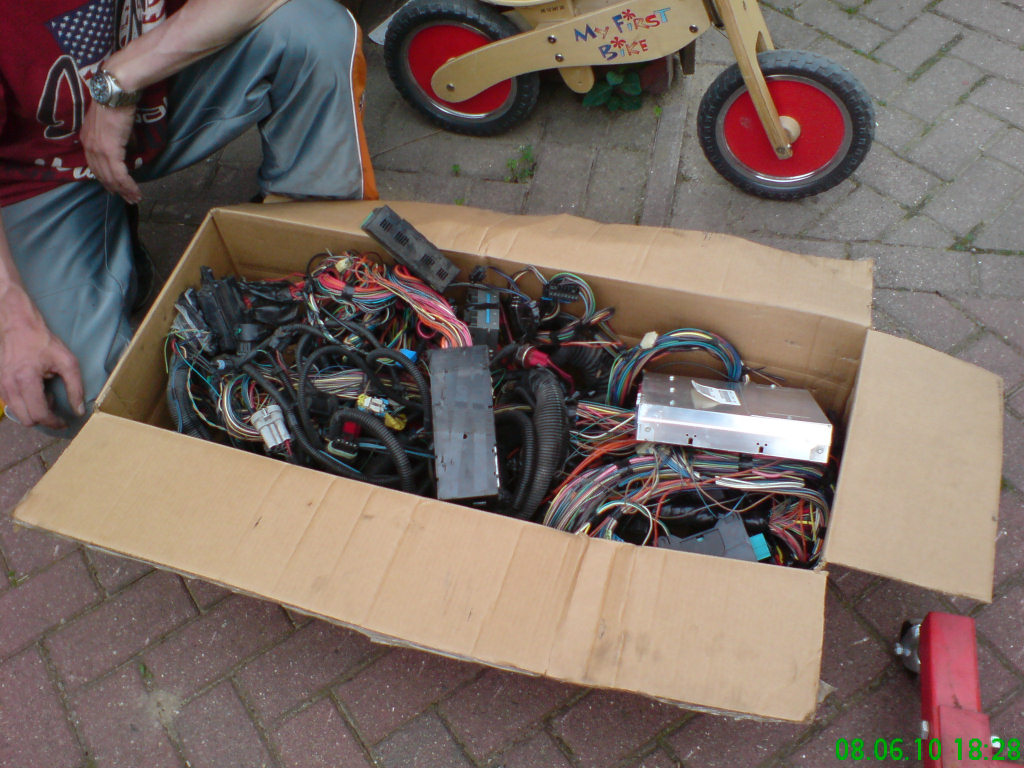

Fieromaniac JUN 09, 05:08 AM
here some pics of the SC
