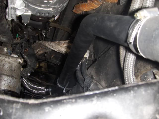

For the cooling system I am using a lot of 1.5" J-bends welded and pressure checked. They hold 100psi, so I think they will be good for the cooling system. Here is the return pipe....as best of a shot I can get in the car. The outlet pipe is still in the bench vice for the last week. I think the holiday rush of customers might die down soon, and I'll hopefully get the cooling system completed.

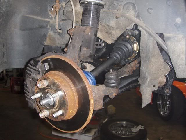

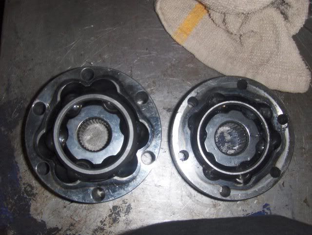

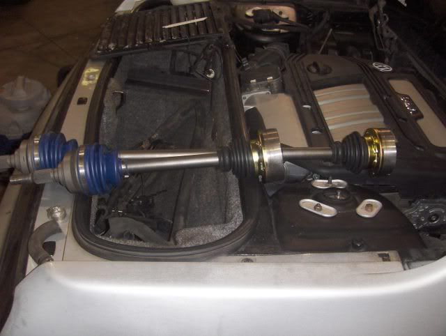

I made some progress today. i had an early start, but then had to tend to customer's vehicles. Tomorrow is 10 hours of pure VR6 work, though. Anyway, I took a pic of the new inner CV joints. You can see the size difference between the O2A and 02J transmissions. The 02J which I am using is on the left.
 Here is a shot of the driver's side axle installed.

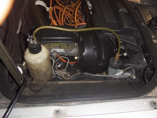

Now, I've been reading how a lot of members have difficulty bleeding out the clutch. I've bled the clutch in all my Fieros in under ten minutes with no issues. Here is the trick.....

Good call with the fluid feeder on the front when bleeding the clutch. I guess you had to modify a clutch fill cap for that to work?

The adapter I used on the clutch master is the same as just about all German brake master cylinders, so it screwed right on. Anyway, I'm getting ready for bed and hoping to get a fresh start in the morning Dave
