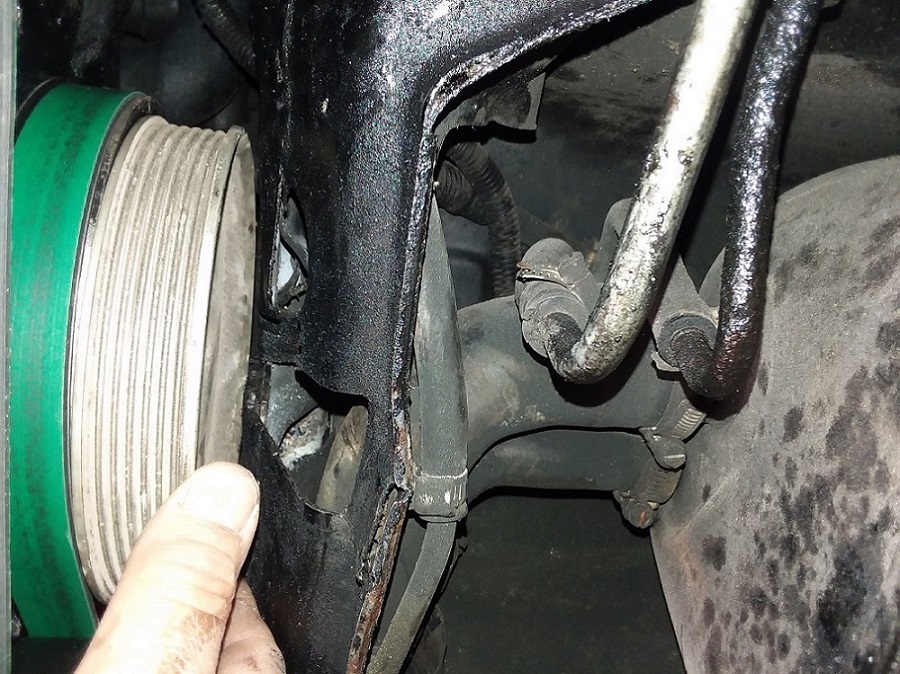

engine man
JUN 25, 06:52 PM
i need to make a bit more room for the second pulley as it is tight maybe a 1/16 inch right now as you can see
