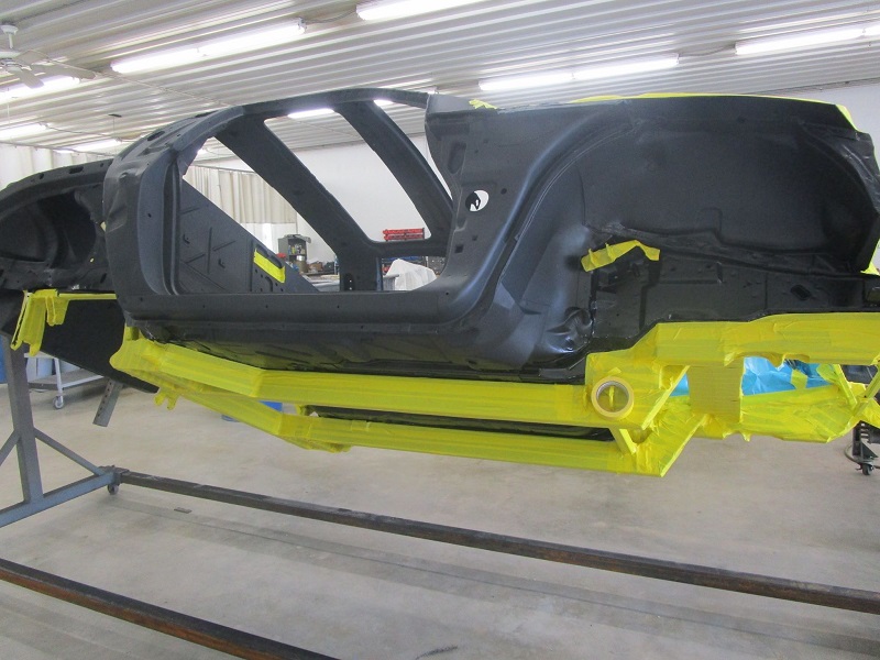

artworks SEP 01, 05:33 PM

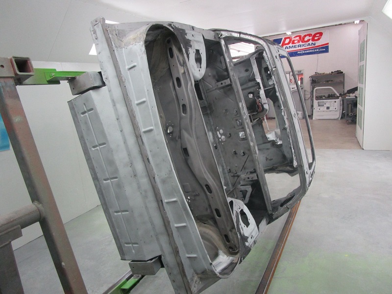

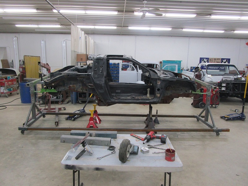

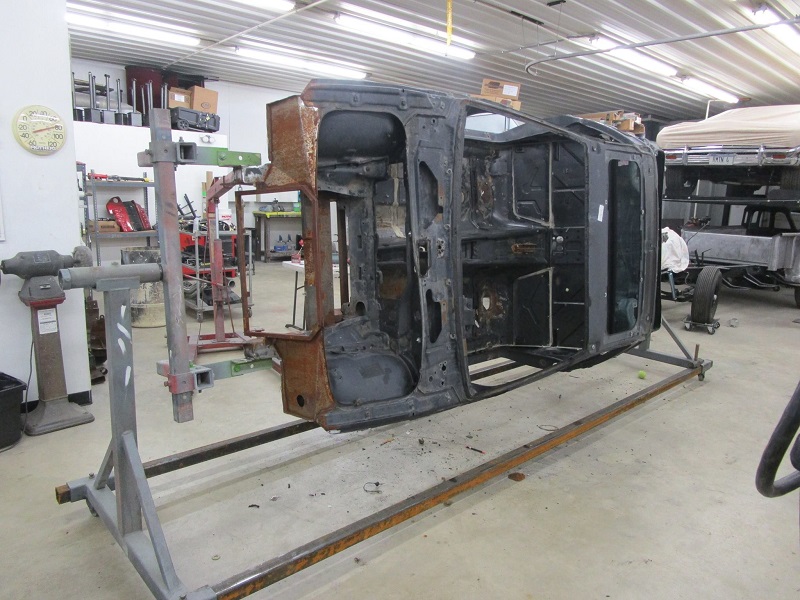

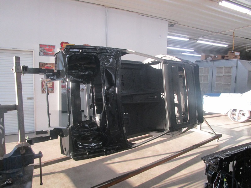

The car is stripped to its bones and ready for cleanup, minor sheet metal repair and primer.

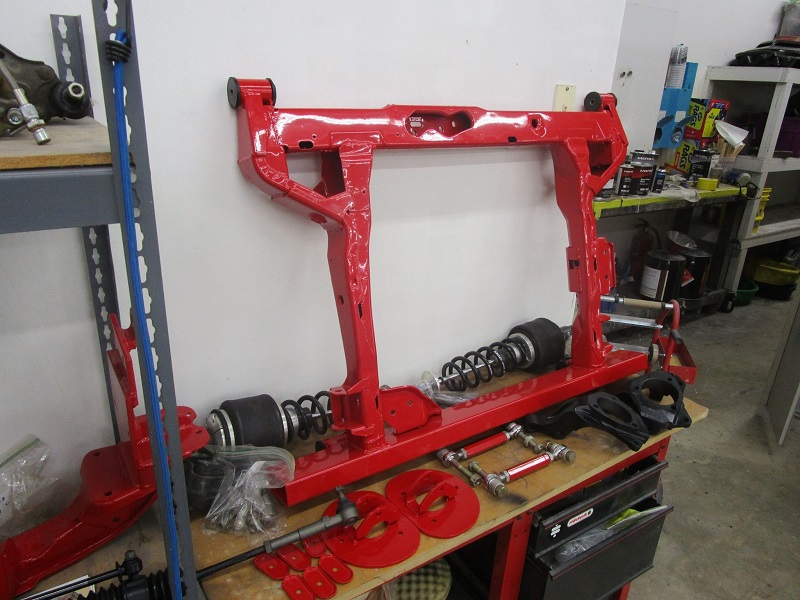

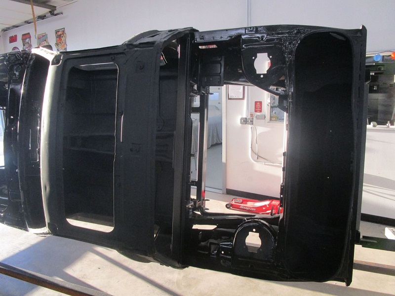

artworks SEP 18, 02:51 PM

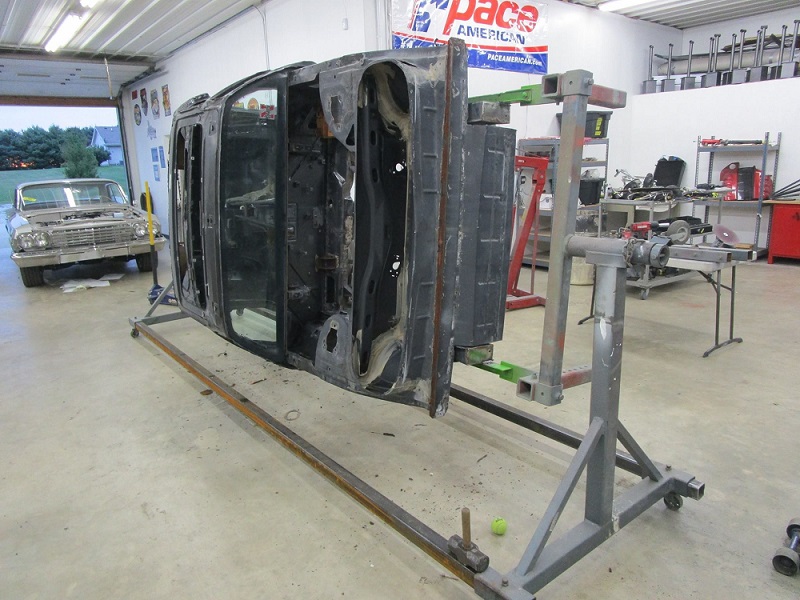

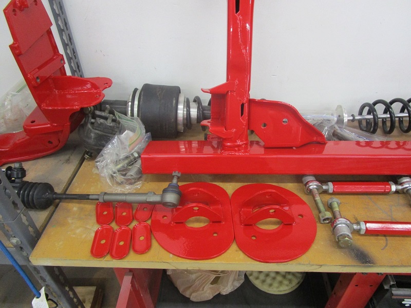

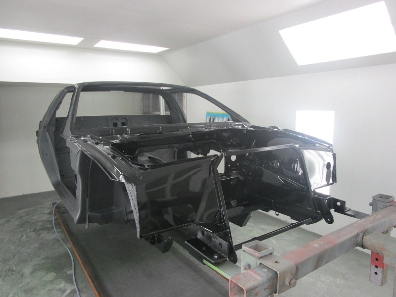

sandblasting is done and an epoxy primer has been sprayed. Chassis components have been powder coated red.
[This message has been edited by artworks (edited 07-15-2017).]

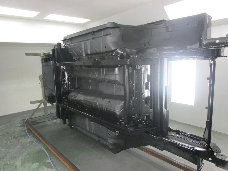

artworks SEP 25, 04:28 PM

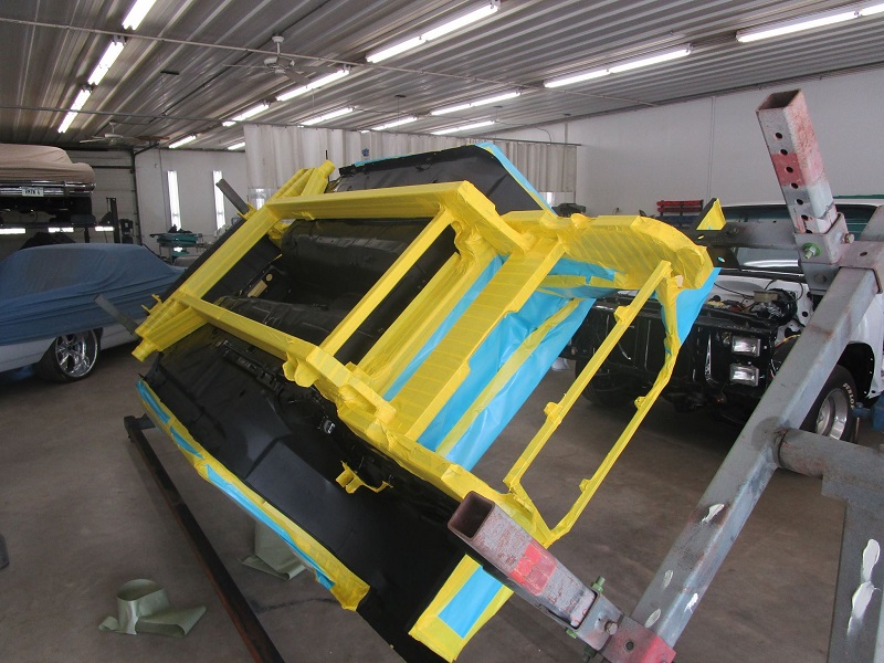

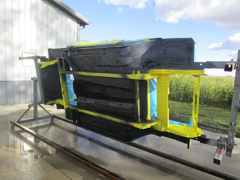

The underside of the chassis has been sprayed with bedliner.

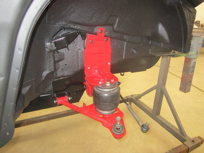

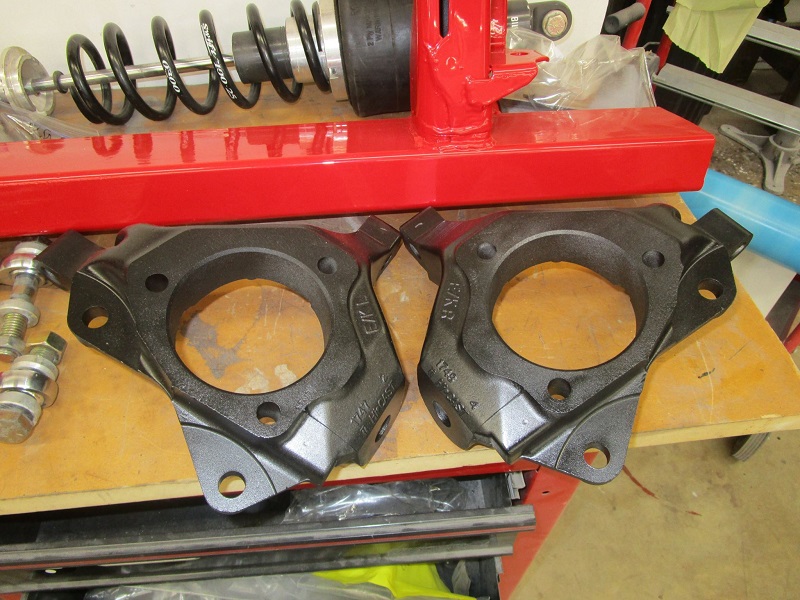

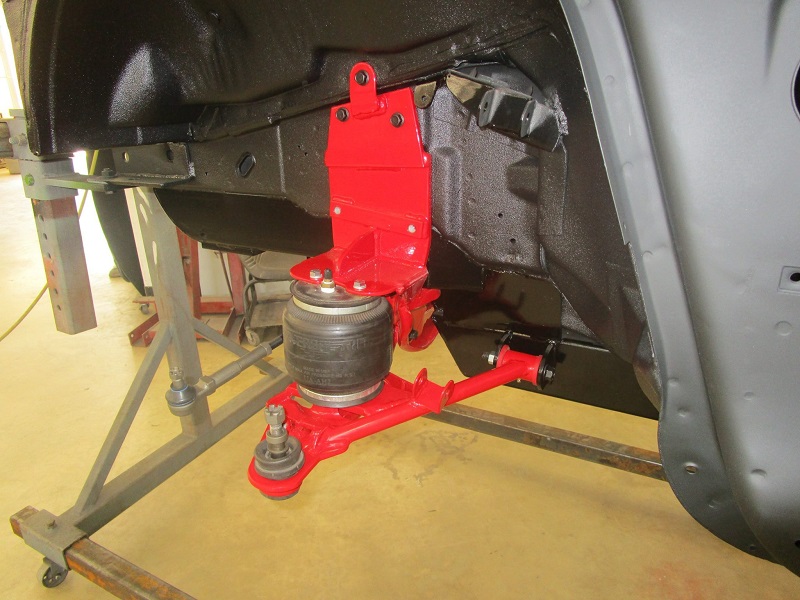

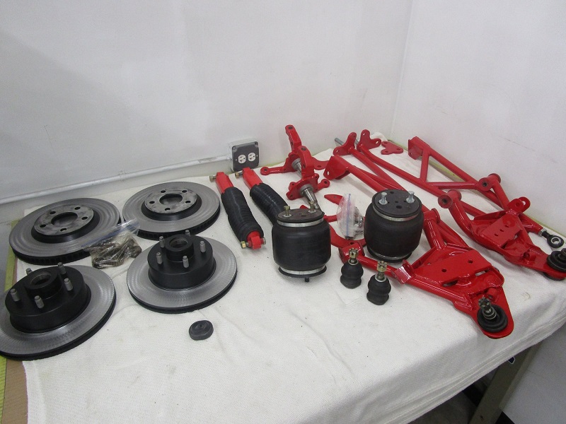

artworks SEP 27, 12:18 PM

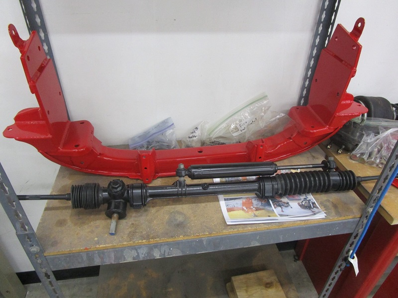

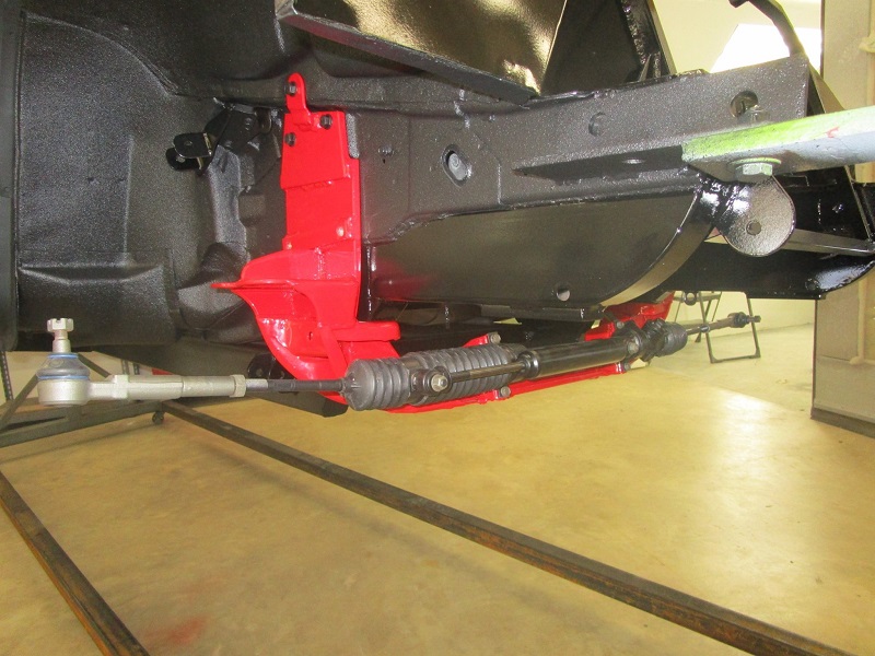

Parts are coming together! Front suspension is back together. Still need to replace the threaded rod holding the upper A-arm with hardened bolts, once the alignment is complete
