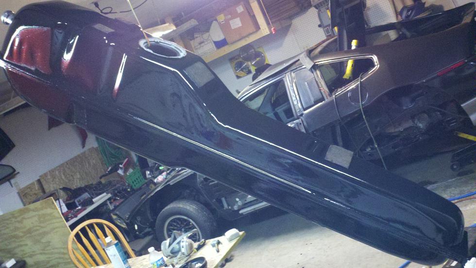

hercimer01 AUG 30, 10:02 AM
I put in an automatic radiator with new lines to the back last night. I also patched my fuel tank where the straps hold it up with fuel tank sealant. It had a pin hole in it. Then I gave it a coat of POR-15, it looks brand new. My cable modem is down so no pics for now.
