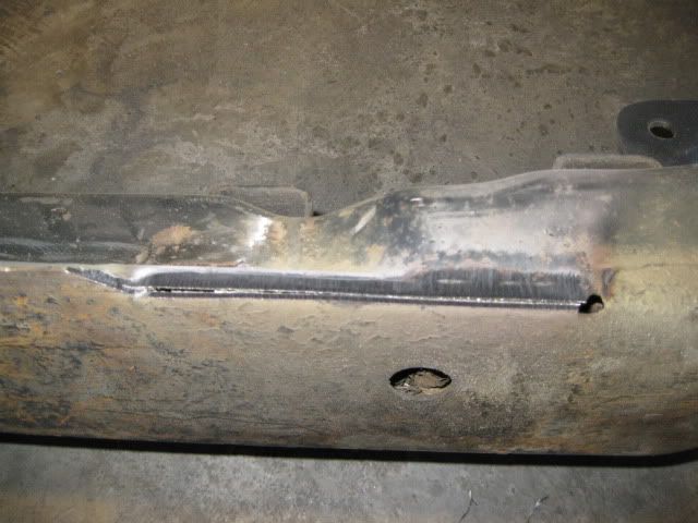

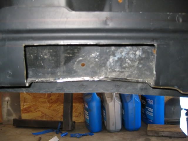

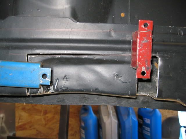

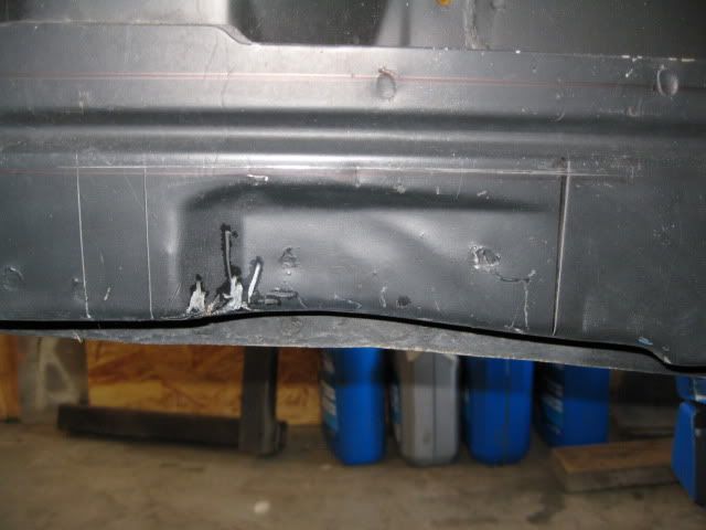

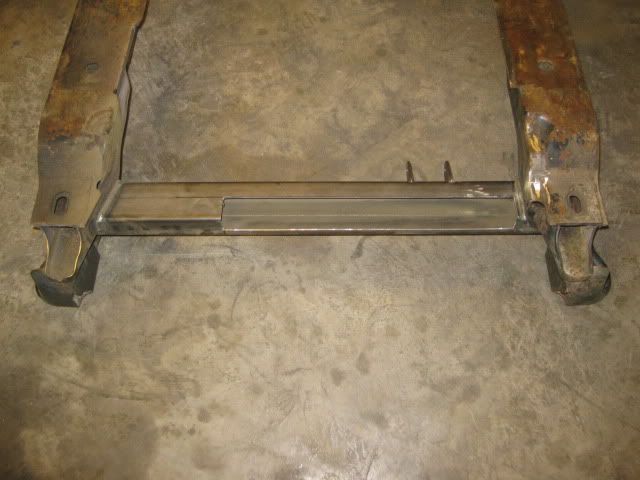

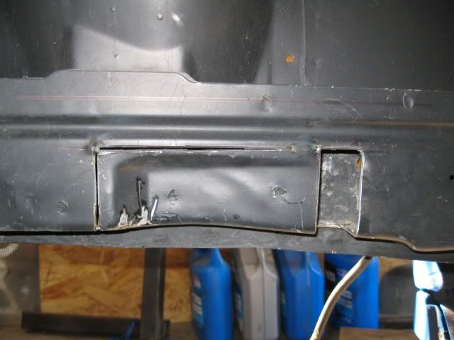

Today was a good day for destruction... The test fit into the blue car showed a couple of areas that needed some additional clearancing.
As discusses a page or two ago, the factory frame notch on the driver's side was moved back 1" so it would better clear the F40:
I will leave it just tacked in place while the engine/tranny/cradle are test fitted again to verify 1" was the proper amount to move it.
Next the cradle needed some slight tweaks. The Magnaflow muffler is thicker than the Flowtech Afterburner I usually use, so I needed to clearance the rear cross-member slightly so I could raise it up more.

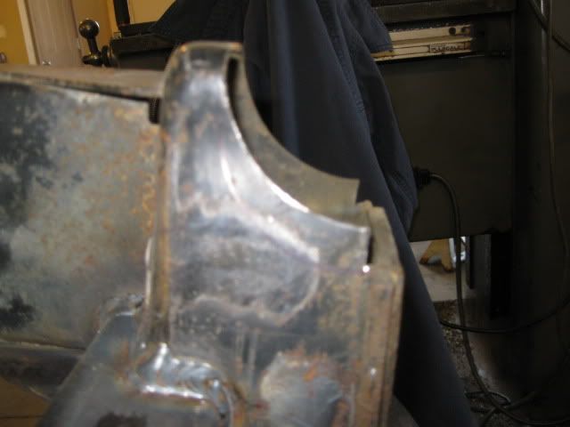

In addition to the rear cross-member, the factory exhaust notches in the cradle needed to be modified slightly. They were shortened about 3/8" and reshaped to better clear my exhaust pipes. This modification allows the Magnaflow muffler to fit without any modifications to the stock trunk. In this pic the bottom portion has already been cut back and the marker outline shows the amount to be removed:
The last modification was to the lower lip of the passenger cradle rail. The 2 1/2" exhaust runs within 3/8" of it and it needs more room for the enlargement to 3". I had kicked around trimming it for the entire length, but chose to just do the portion that is behind the oil pan.
After the next exhaust mockup all the cuts made today will be welded up and ground down smooth.

I'm sure you're aware, but for others that may not be, that cradle lip is just a weld-flange for easier automated spot-welding on the assembly line. You could've removed it entirely without any concerns.
