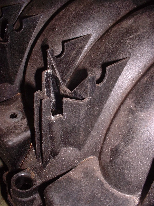

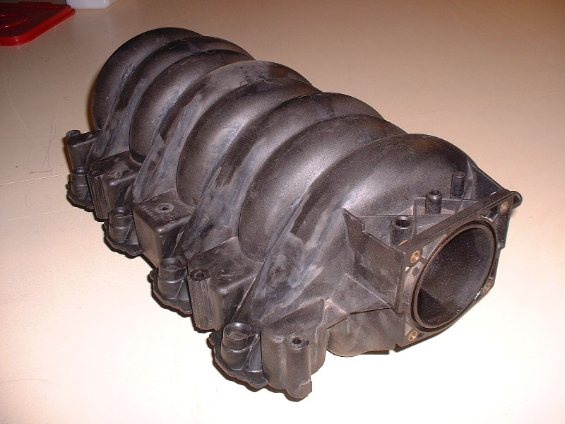

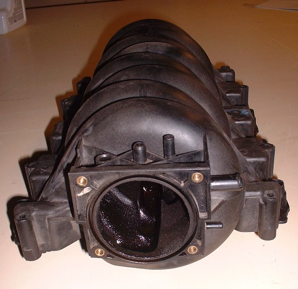

Anyways, before giving the plenum a bath, I figured I’d get some of the messy work done and over with, so I decided to give this porcupine a shave & haircut. Here’s what I’m talking about:
Notice all the fuel rail mounting brackets molded into the sides of the plenum? Here’s what they look like close up. They’re no longer needed when the stainless rail gets installed.

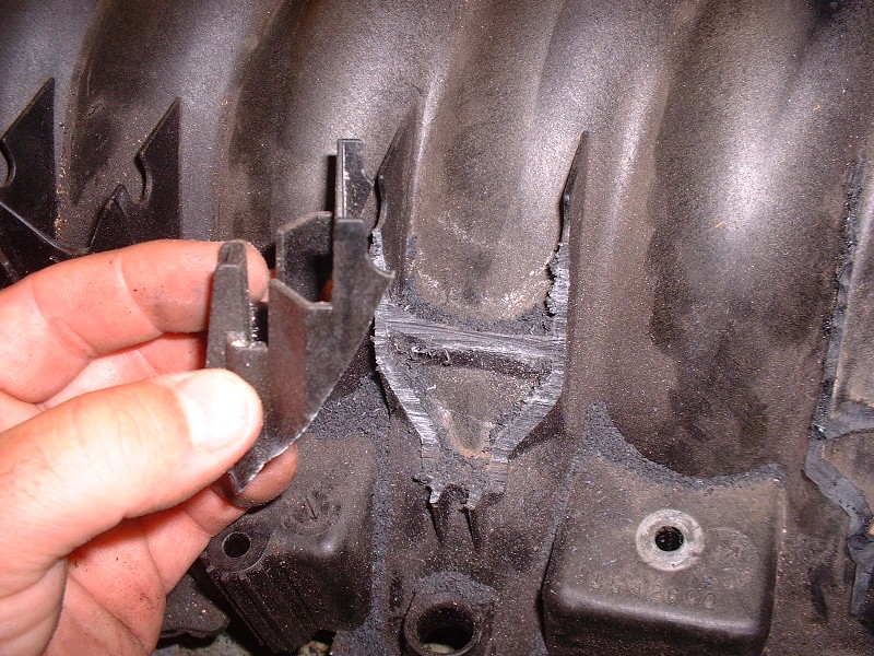

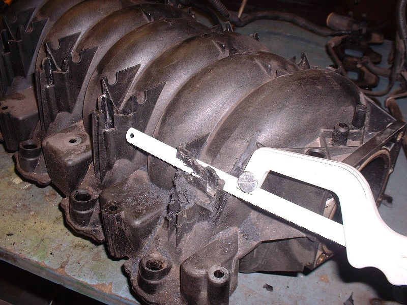

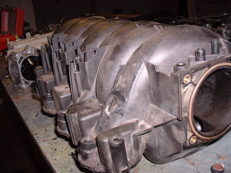

At first it seemed like it would be an easy, quick and dirty task. I started out using a hand hacksaw to be able to control the cutting more easily, but found that the blade wandered a lot. The plenum runners weave in and out a bit too so you can't get a straight line of sight with the saw. I had to cut with the blade bent in a U shape which makes controlling it much more difficult.
Here’s the first “ear” lopped off. Notice how the plastic rail mount gets thicker towards the bottom of the runner as the angle between the runner and the mounting boss gets shallower. This is where the greatest work ended up taking place.

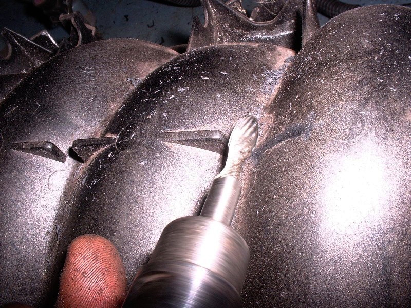

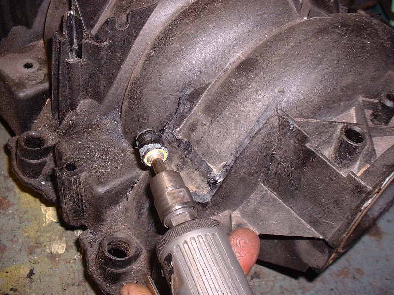

At first I thought I’d be able to use a grinding stone on my die grinder to make quick work out of smoothing off the left-over plastic, but from this photo you can see what happened within the first couple seconds of trying that idea. The stone just heated up the plastic and made it stick to the stone like Bubblicious on a summer sidewalk.
Next I tried a hand file but found that to be waaaaayyyy tooooo sloooow. And you can forget about sandpaper too… the PVC plastic just gums it up after a dozen or so passes. My breakthrough came when I tried a set of high speed multi-fluted dies. I tried one out on the spark plug wire clips molded into the top of the plenum and it worked like a charm. It chops instead of grinds so it doesn’t heat up the plastic and it was very easily controlled at high speed.

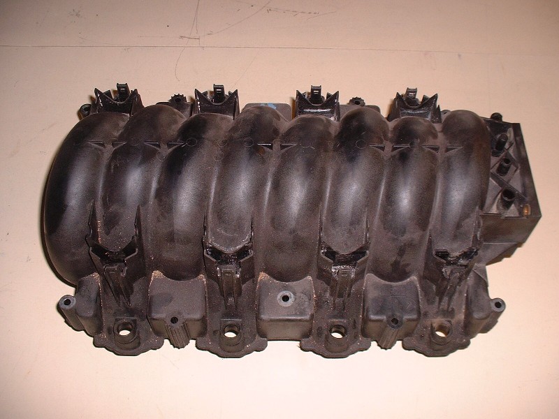

Here’s what the first boss looked like once it was lopped off and roughly smoothed. One of the things I found as I was shaping the lowest part of each fuel rail boss is that the mold line for the plenum must run under the bosses. If you look carefully, you’ll notice that the runner carries on in a nice smooth line under the first web (from top) that crosses the runner. But as it gets to the solid bottom part of the boss, the outside runner wall takes a bit of a step. GM obviously wasn’t expecting anyone to shave the bosses off so whether the mold halves lined up perfectly under them or not probably wasn’t a big concern. Oh well… nothing a little body filler can’t cure.
The other tough part was shaving one of the two vertical webs of each boss because it starts on the base of one runner, crosses over the valley between the adjacent runner and carries on part-way up that adjacent runner at a very shallow angle. If you look at the forth image in this post you’ll see what I mean. It’s the vertical web on the left side of the boss pictured that's a headache. Anyways, getting the tool to follow that eccentric path without slipping and nicking either runner is pretty difficult. More Bondo!
Here’s a couple shots of the intake plenum with all the unnecessary brackets shaved off, and with only two or three little nicks. Bring on the aftershave and the Kleenex bits! Next stop… the hot tub.
