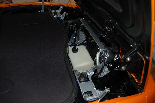

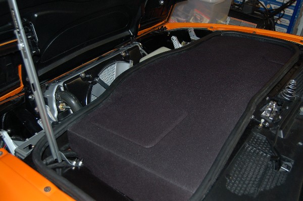

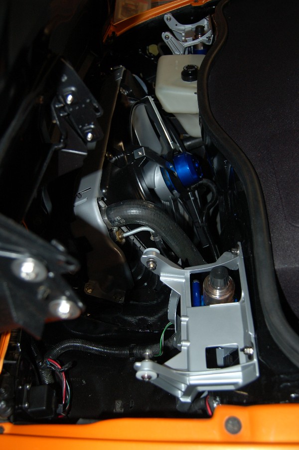

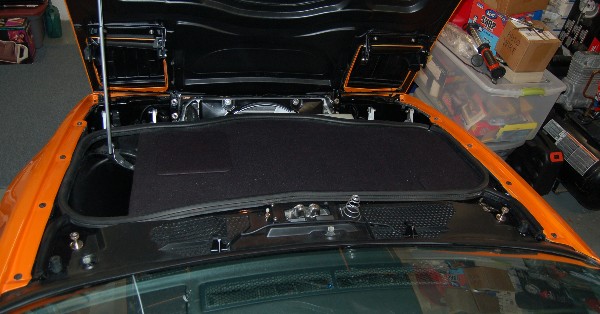

I've never been a huge fan of the spare tire covers, so I thought I'd just cover the whole area!
The cover is made from 3/16 thick ABS plastic some aluminum angle and a few rivets, and is upholstered with a nice durable black headliner material.
I added access doors for the master cylinder reservoir and the windshield washer tank fill.
Always liked the way Ferrari and Lamborghini had all the under hood "guts" neatly covered and thats the look I was going for.
The entire cover simply lifts out when access underneath it is required.
The whole thing is very durable and weighs less than 2 lbs.

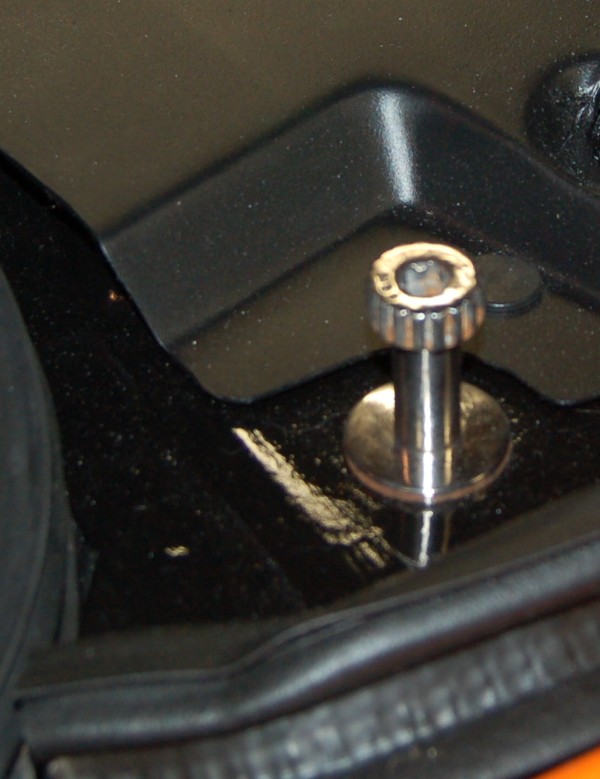

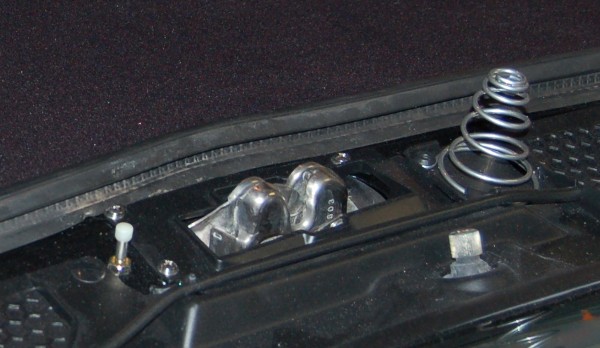

Several years ago I bought some electroplating equipment and never used it ... until now.
I polished and nickel plated the hood safety posts, hood latch and numerous nuts and bolts.
The plating is called "Copy Chrome" and although it's actually nickel, it's a "blue" nickel that approximates chrome very nicely.
Google "Caswell Plating" and look for their brush plating kits if you're interested...

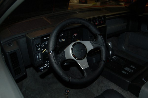

Next up was installing my new Momo steering wheel with NRG adapter
(Key fob for the new keyless entry is laying on the floor mat )

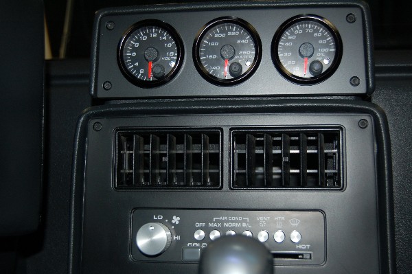

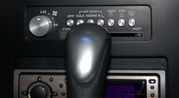

Since I already had a lot of the interior out while doing the keyless entry system, I disasembled the HVAC control head and machined some new billet aluminum buttons and added a billet aluminum fan switch knob, complete with LED in the knob.
Another view of the billet buttons and switch knob along with my new Sony stereo head unit and shortened shifter.
Installed the new Speed Hut Volt, Water Temp. and Oil Pressure gages:
The gages light up cobalt blue, (same as my new Speed Hut tach, speedo and all other gage faces.
The gages have peak and min warning set and LED warning flash feature.

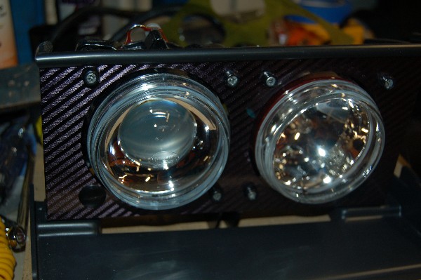

randye JAN 26, 09:58 PM
Both headlight buckets were wrapped in carbon fiber film.
I don't know how well it will hold up, but I'm told it's very durable...we shall see.

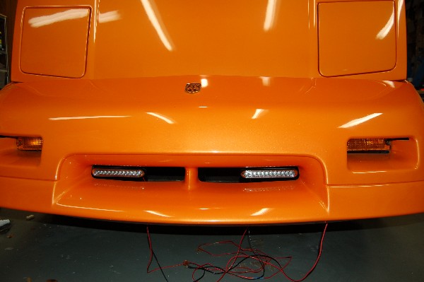

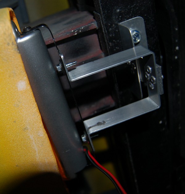

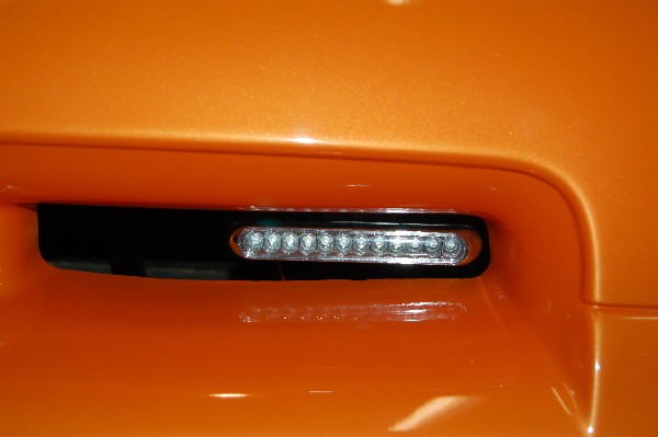

Next up was installing some new LED driving lights:
I had to fabricate some simple aluminum brackets to get the lights to "float" in the grill opening:
They look pretty good I think.
When lit, they give the car something of an Audi look
