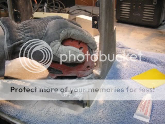

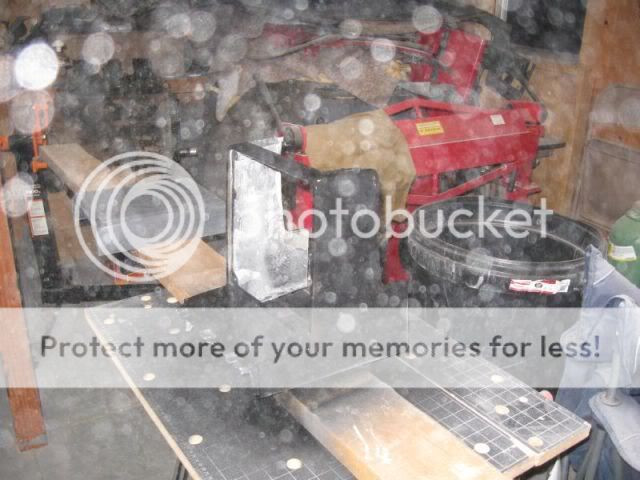

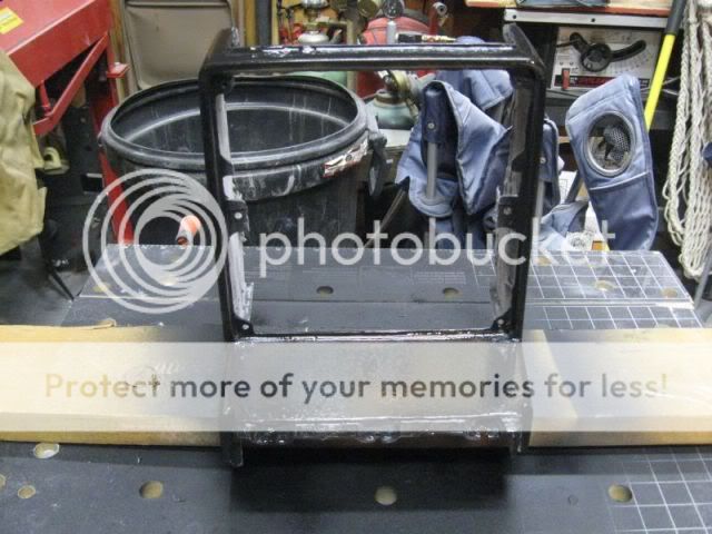

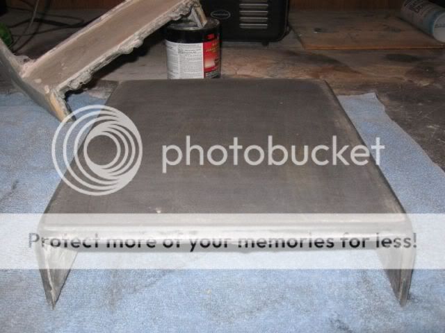

Alrighty then..... Made good progress today despite having to install a water pump on the Formula. Again, my focus is on the AC surround. I had to build up the lip for the vent cover and then I wanted to get some filler on it to see where I was. Lots of sanding took place and there was a little beer drinking but I managed to get some primer on it.
Building up the lip:
A little filler....Ok a lot of filler!
And lots of sanding:

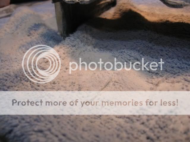

This does not mix with beer to well!

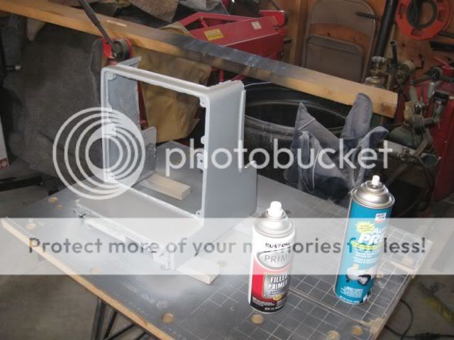

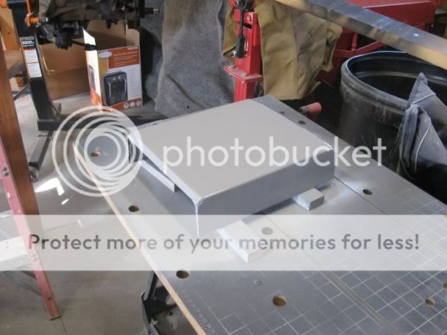

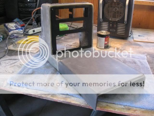

Then I put some primer on the shifter console and the AC surround.
And there was a little dust on the camera:

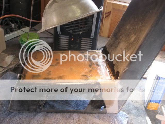

Now I had some problems with my primer. I'm thinking it is due to just cheap primer but it is rustoleum automotive primer. I had a few "fish eyes" in the shift console but the AC surround was really bad. Could it be cheap primer, something on the fiberglass? I sanded the crap out of it and wiped it down with thinner then let it dry real good before spraying. It was about 60* in the shop. It just irks me to do all that work and still have problems with the primer. I'll figure it out!

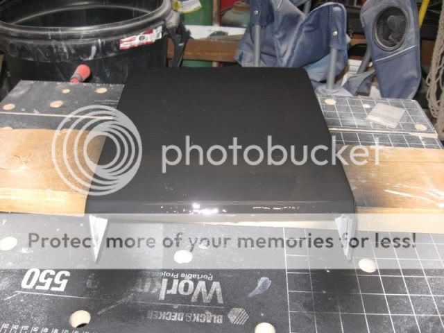

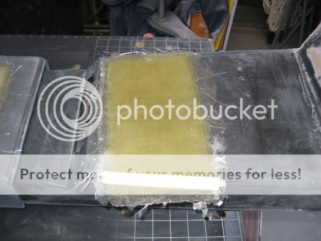

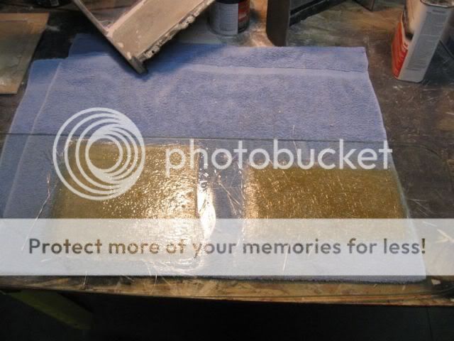

I also made a few "panels" for some parts I will be making tomorrow. The panel on the right has 2 layers of mat, 1 layer of cloth and 2 more layers of mat. The panel on the left has 3 layers of cloth.

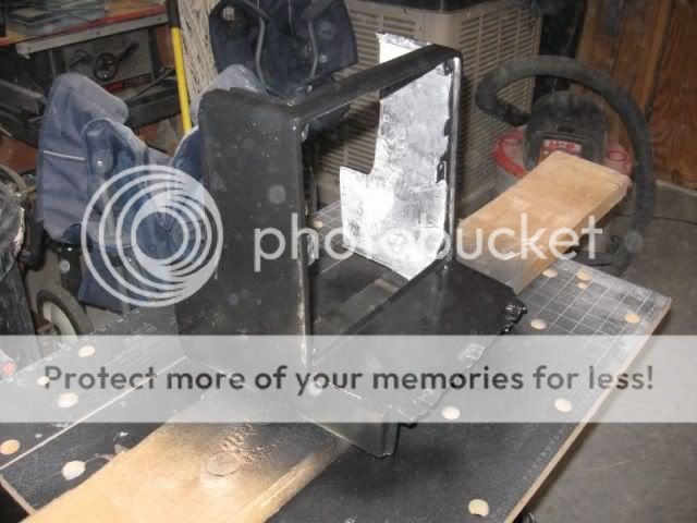

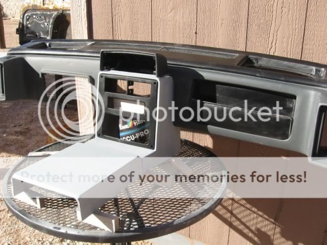

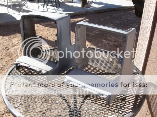

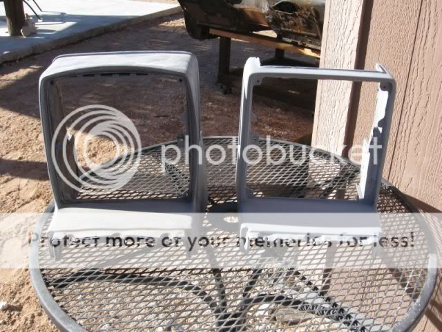

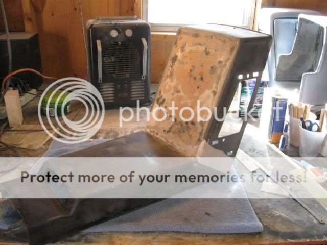

Lots of fun today. Went to AZ and got some filler primer and some wax & grease remover. Did some more filling and sanding and sanding and filling and then some more sanding. After a last coat of filler primer, I can see how many more little holes and low spots left to fix. It is coming together nicely though. I will set the AC surround and the shift console aside now and work on the back piece. I have a lot of work to do on it so here we go.
Here's some of what I got accomplshed today.
After sanding all the fish eye's out:

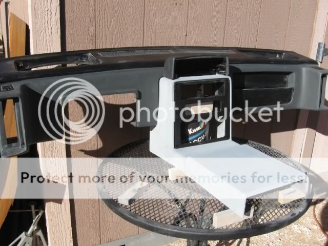

Setup on the skeleton to check fit:
Last coat of filler primer:

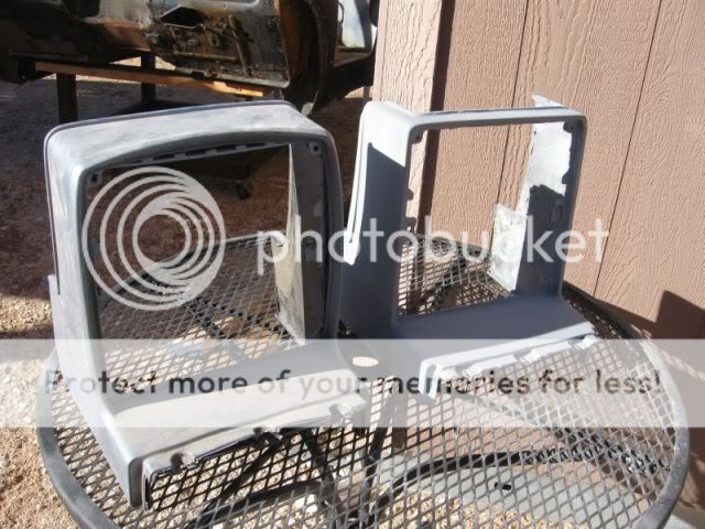

Old versus New:

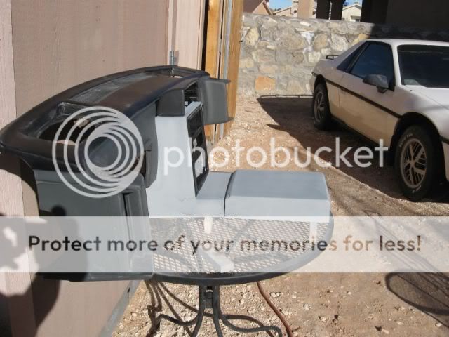

Mocked up with the dash:
Time to work on the back console for awhile now!

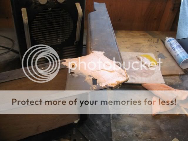

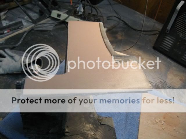

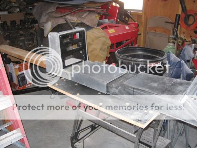

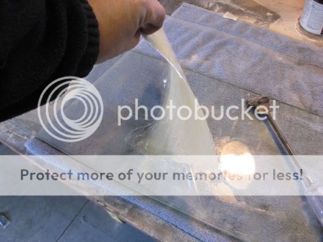

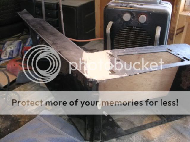

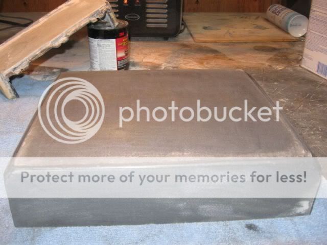

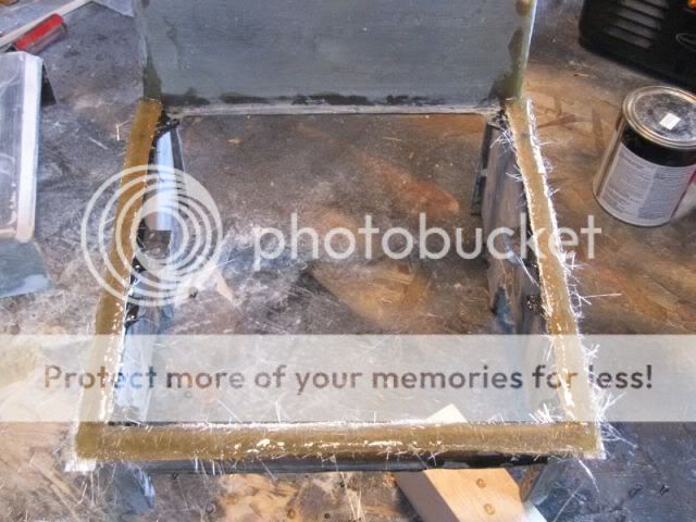

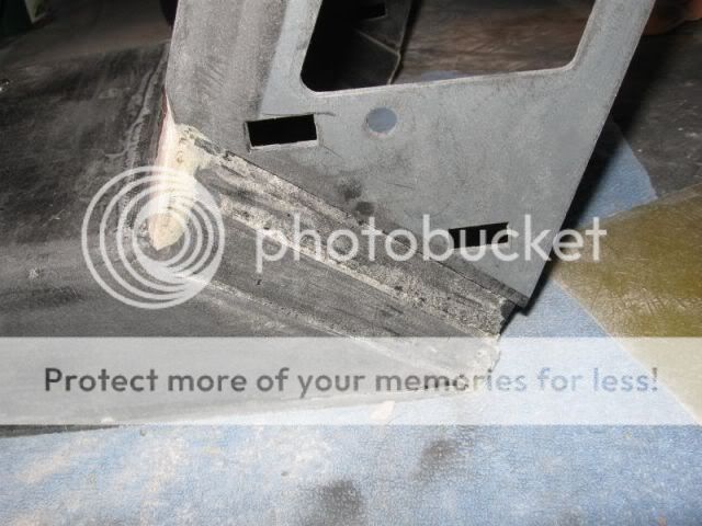

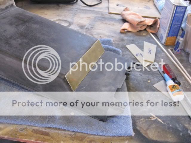

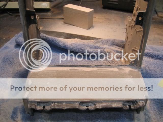

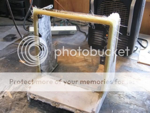

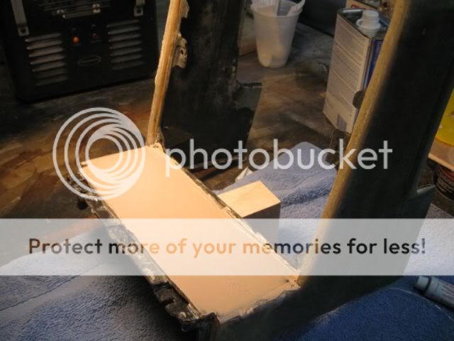

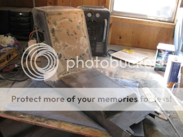

Forgot to add the rest of my work today. I had some things to "smooth" out on the rear console. So I cut some balsa wood fillers and then I was going to use some of the "panels" I made last night to fill in the rest but after cutting the pieces and fitting them in, I did not like the look of it so I changed directions. I ended up using body filler to smooth it out and it turned out better than I was expecting. It's still all experimental but I learn something everyday.

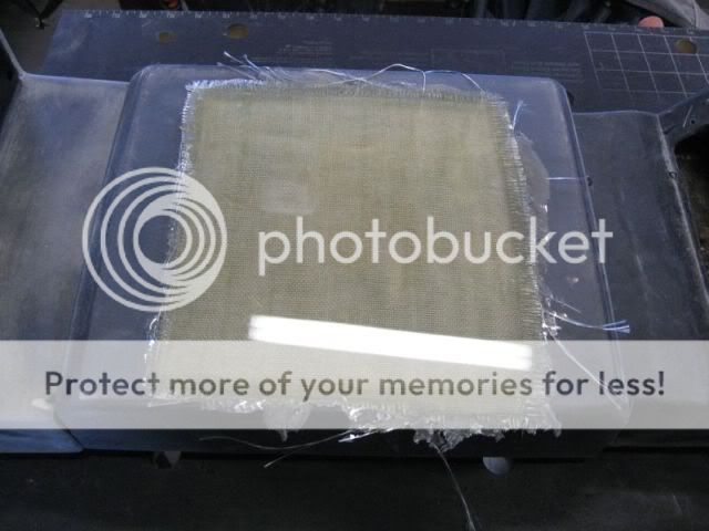

Here's the panels I made last night - peeled off the glass. I made 2 different panels. I ridgid and one flexible.
Flexiible!

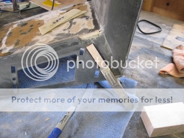

Here's the areas I need to "smooth" out.
Filling in some with balsa wood:

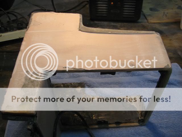

Throw on some filler:
The lighter area will be no more:
After some sanding and shaping, it's time for some glass:
And some glass curing:
More later after the glass cures.
