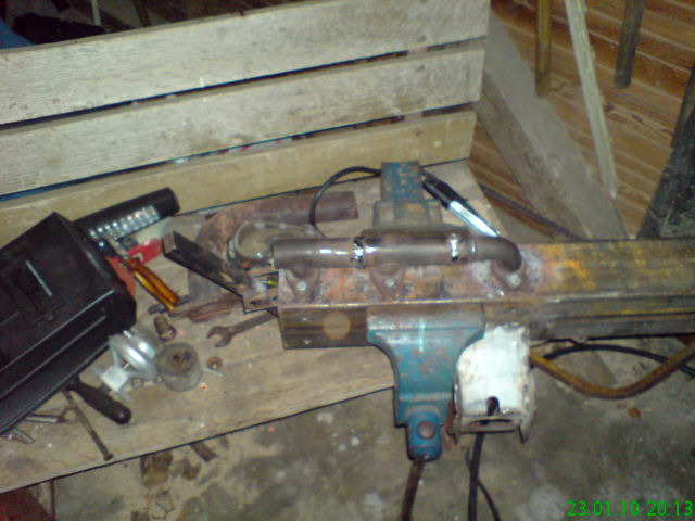

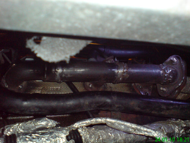

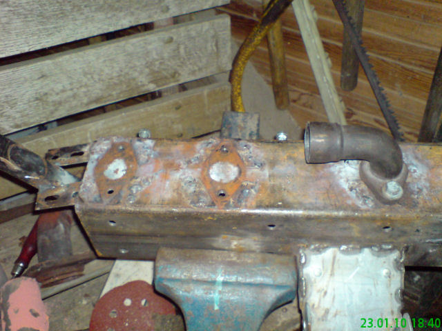

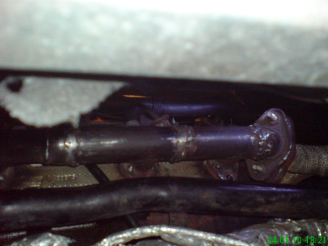

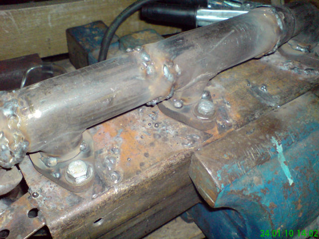

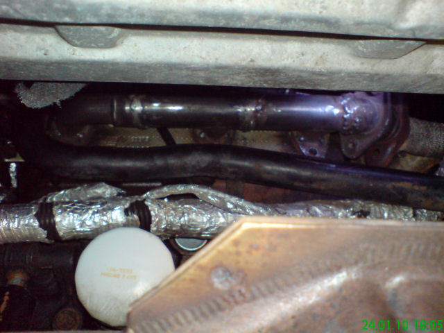

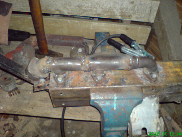

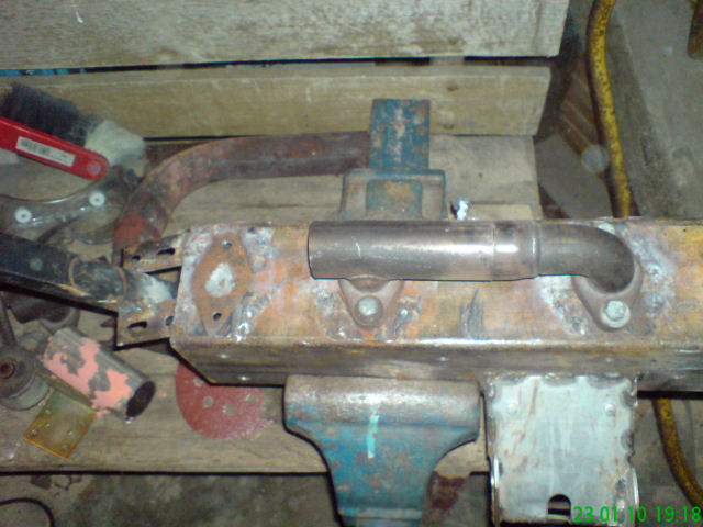

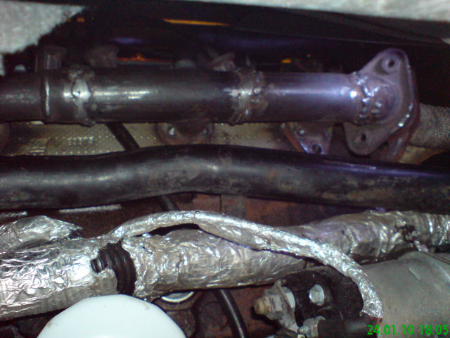

my front manifold was after some weldings so out of line and cracked again so i decided to make a emergency manifold by cutting a rear manifold and weld it together to a front manifold.
too bad that my new welder has big problems with the wiretransport aaaaaand my weldingskills in electrowelding suck very bad. in fact thats my 3rd time ever i welded electric. So dont judge me
and it fits like a charm
ok still there is the missing bolt on cylinder 6 but ill fix it next weekend

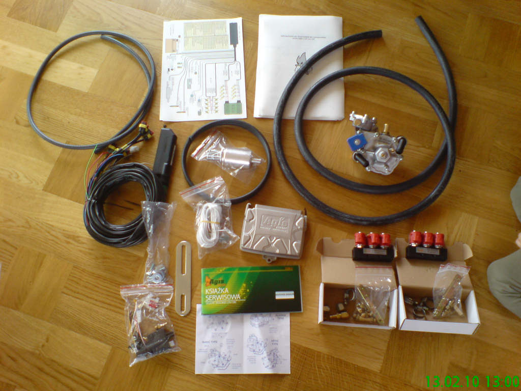

there is my new sequential LPG system  its a lot more sophisticated than the old venturisystem i had before. It has a lot of own Sensors even a own MAP Sensor that registers positive and negative pressure then gas temp , coolant temp , air temp and and and . With this system the fiero has now a real sequential injection and not the ugly batchfiring . i take the signal of injector 1 and 2 then the system knows when to fire the other injectors . That should get me a much better mpg
btw engine has now 5700 mls on the clock and its running strong and it passed all technical inspections ------------------ 1984 Fiero Sport 1987 Fiero 1984 Fiero SE 1999 Chrysler Grand Voyager 3.3 LX LPG SKYPE: Fieromaniac *** nuclear winter cures global warming ***[This message has been edited by Fieromaniac (edited 02-13-2010).]
