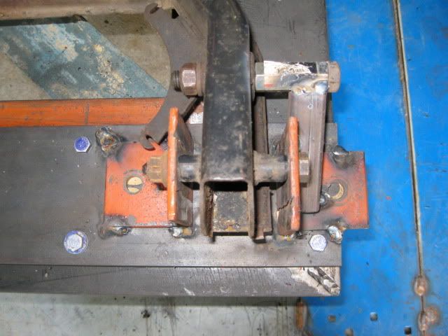

I also went ahead and reworked the front cradle attachment points on my cradle fixture. This is what they looked like when I used some scrap metal back in 2009. While they have been used many, many times since w/o issue, I didn't like looking at them, and didn't want them to be distractions for my tubular cradle build. Old brackets:
