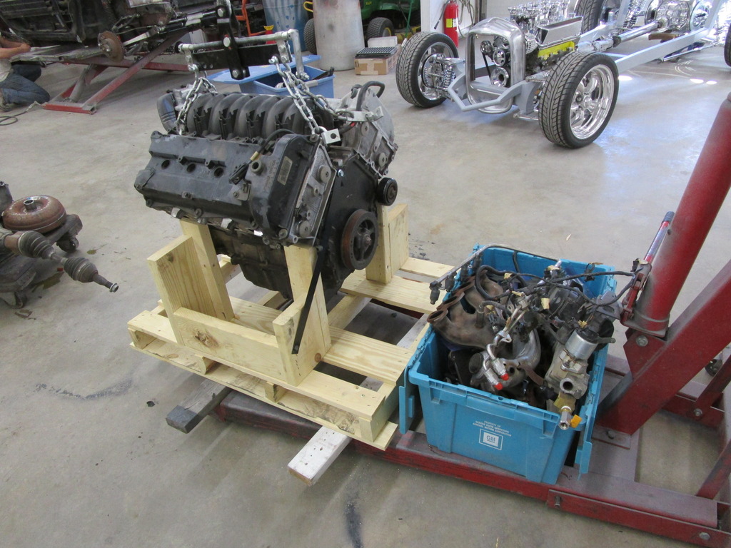

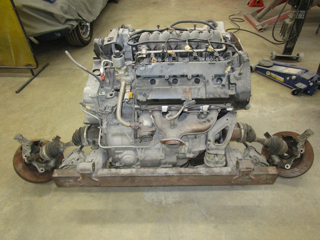

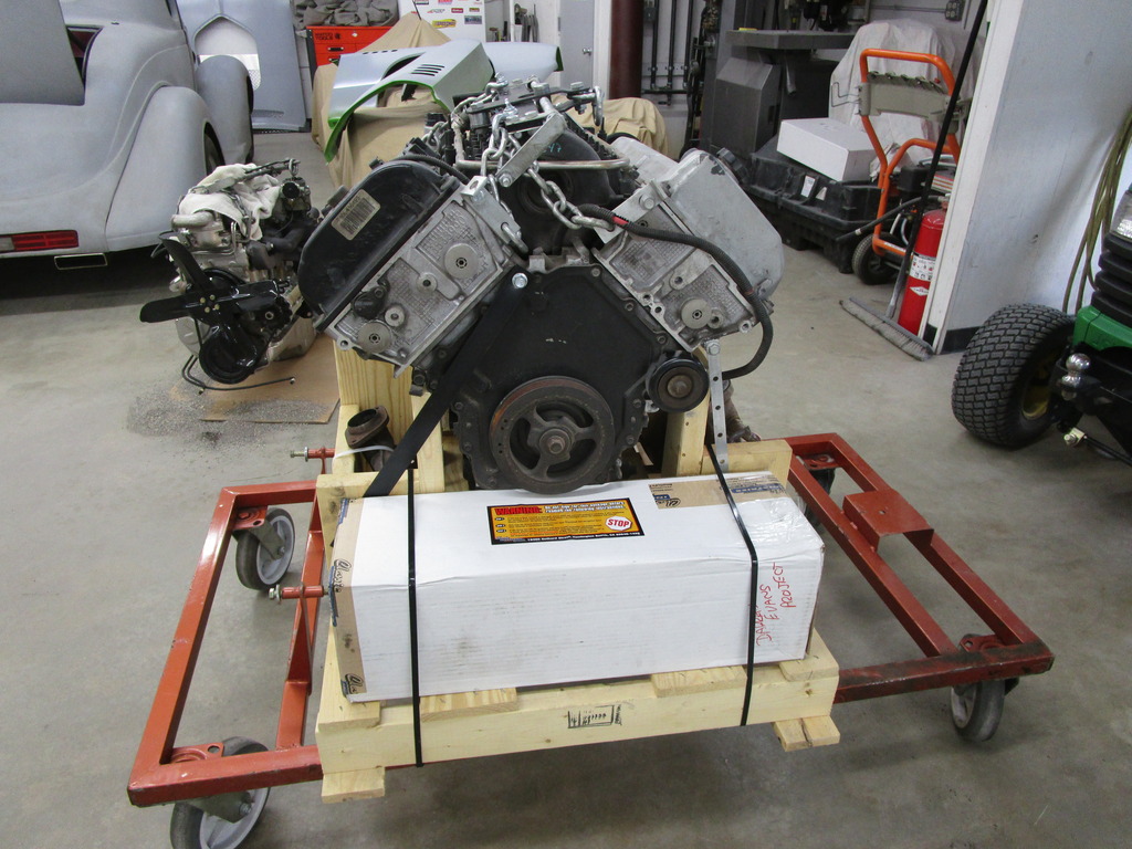

The drivetrain is back out of the car and has been shipped off to Cadillac Hot Rod Fabricators in CA for a complete rebuild with forged internals. The plan also includes CHRF building new exhaust manifolds to let the high RPM breathing begin, and a nitrous shot...just because.

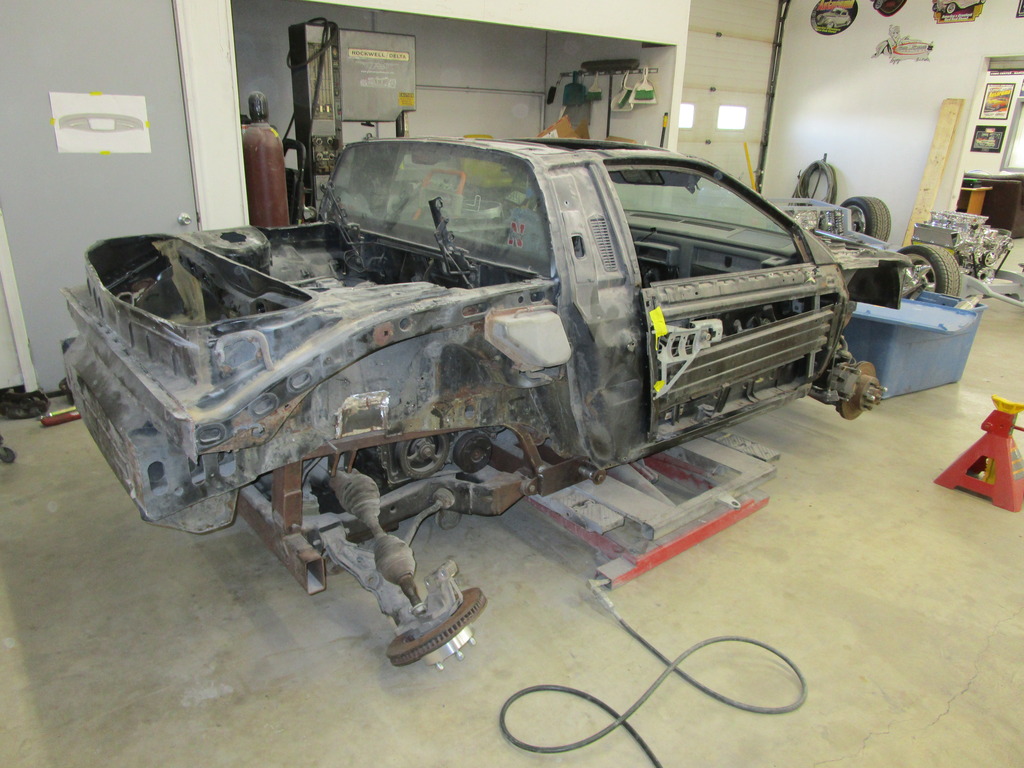

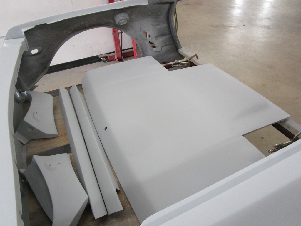

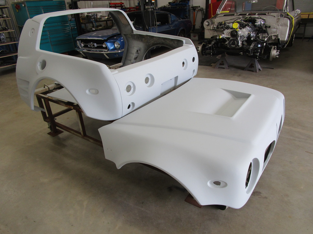

The body is off the car again, and has a nice thick coat of polyurethane primer for smoothing and strength.

The progress you're seeing is being done by Michael Dumas @ Platimun Custom Cars in Manteno, IL. Like most folks that have seen this project, he thinks I'm a little nuts, but he's happy to do the work. The Northstar is a little different for him tho...

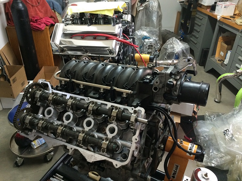

Alan Johnson at CHRF has the motor apart and new parts on order. A minor re-bore to clean up the cylinders, new pistons and rods which will take the compression from 10.3:1 up to 11.7:1, ARP studs and bolts to hold it all together, and the aforementioned exhaust. We're shooting for 400 H.P. before the nitrous shot.

The Northstar rebuild is coming together - here's a pic of the engine after Cadillac Hot Rod Fabricators went through it. The valve covers are on the motor right behind it.
[This message has been edited by artworks (edited 07-15-2017).]
fieroguru AUG 17, 08:45 PM
Just in case you were not aware.... those polished aluminum valve covers normally require some clearancing to fit a fiero. Madcurl and Bloozeberry both had to mod either the cover or the rear firewall to use them.
