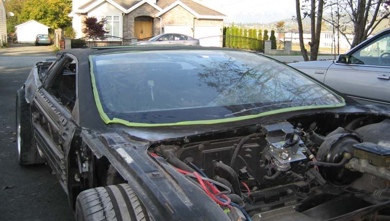

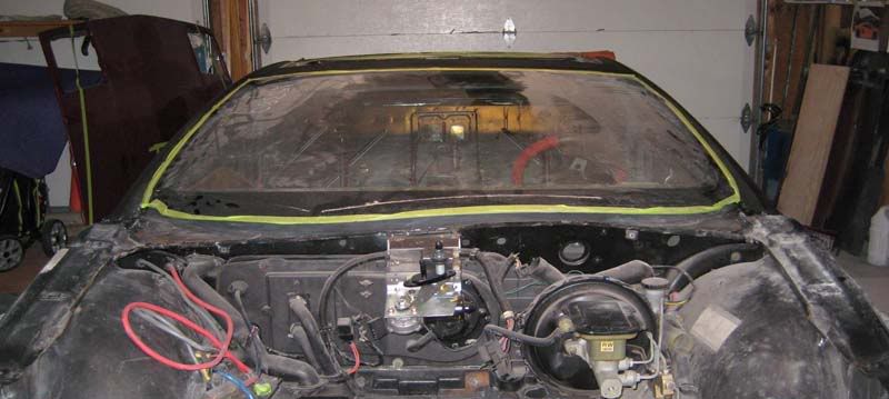

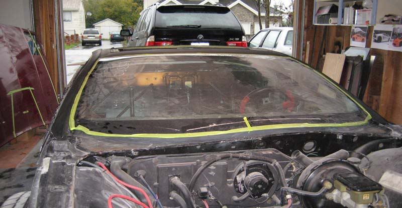

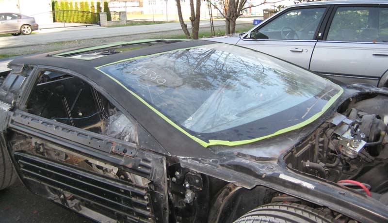

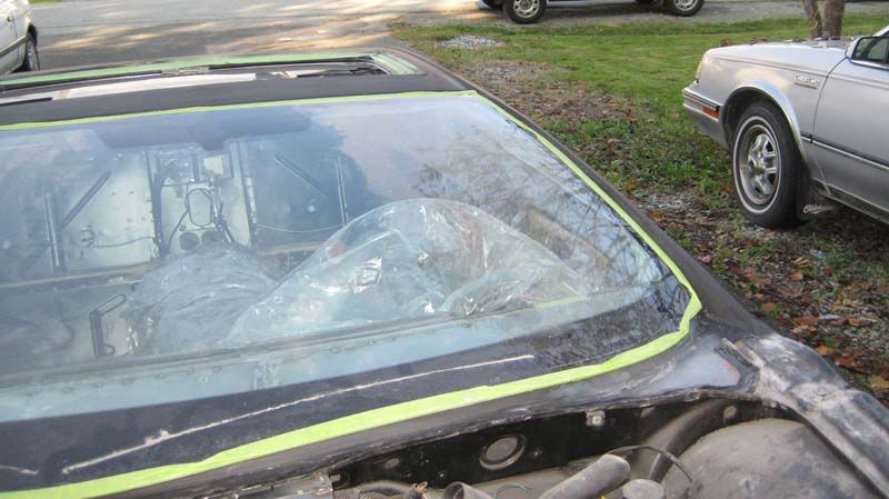

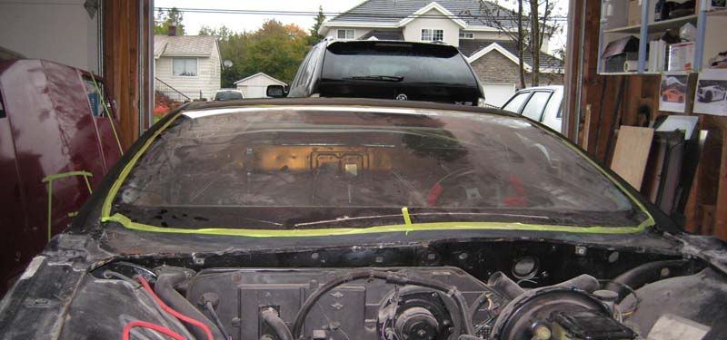

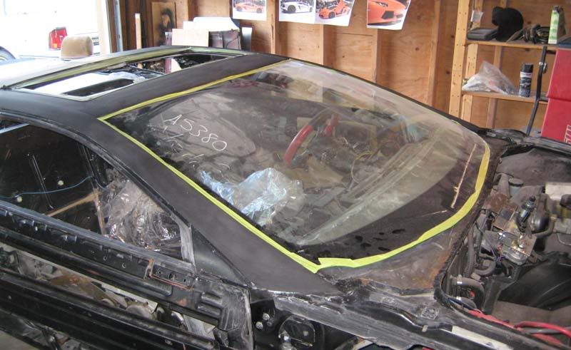

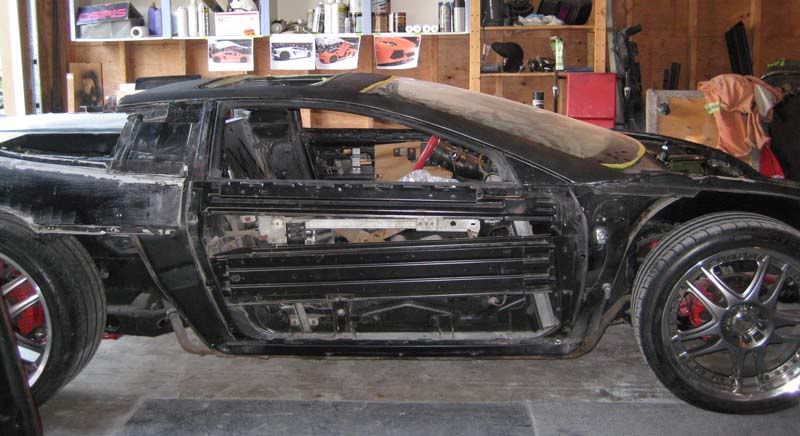

Finally roof and pillar moulding are roughed in, some close up shots...(the wiper is tacked on for location only)

Car-Lo OCT 28, 06:38 PM
The Mazda windshield frame design (like most or all cars today) have raised pillar moulding on each side of frame,
that follow through over roof and into fastback pillars, I had to do the same to get pillar moulding flowing into RBS roof .

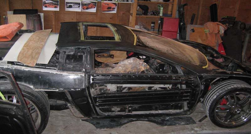

85LAMB OCT 28, 07:07 PM
Looks good
Are the roof moldings removeable ?
or
did your glass them to the side of the roof ?
Looks like you decided to keep the sunroof
Car-Lo OCT 28, 09:02 PM
Originally posted by 85LAMB:
Looks good
or
Good question, not removeable (same with roof).
The old sunroof: At first when Clynt and I started talking about widening roof, it was not possible to us to make sunroof work again.
I always wanted to keep sunroof on, driving with Clynt's 3"chop I did not like it at all without one and I was chopping RBS to 4"
(for me it was too closed in feeling). I put the sunroof on and all the drip rails still lined up and at the end it worked out okay,
anyway RBS does not like the rain.
[This message has been edited by Car-Lo (edited 10-28-2011).]
