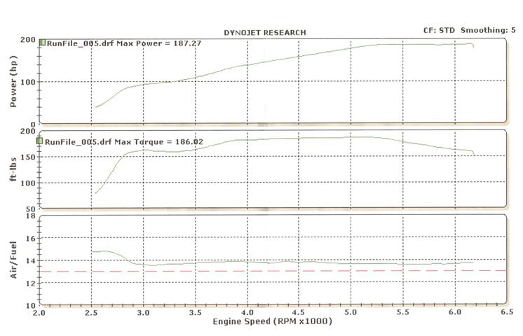

| quote | Originally posted by Sourmug:
And the Dyno slip:
.jpg)
Nolan
it the tach issue what kept you from running up to 7k?
first time i have seen the mirrors. they look sharp.
Sourmug
NOV 07, 09:57 PM
No, not at all, they don't use the vehicle tach on the dyno in any event.
