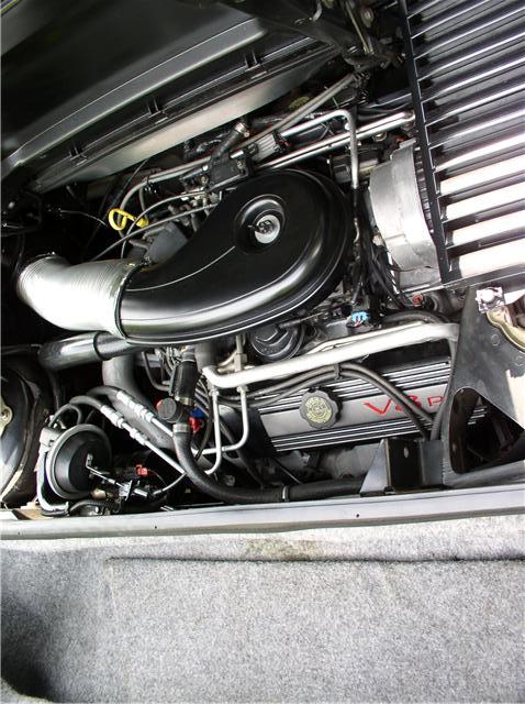

I was checking wires for being connected properly today, ecm, pin number so an so, etc. Following the paths. I have found around 3 mistakes that I have made splicing wires. I taggged these and will address these one at a time after work tomorrow. After seeing some of the harness builds some of you guys have done , mine makes me sick at my stomach. But mine isn't wrapped in the black covering yet, so maybe there is some light at the end of this tunnel after all. Look at this one here. Hell fire GM didn't do them this nice. Olejoedad's 4.9 install:
