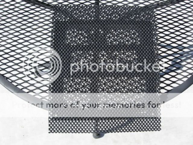

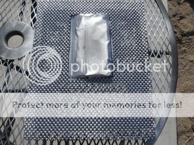

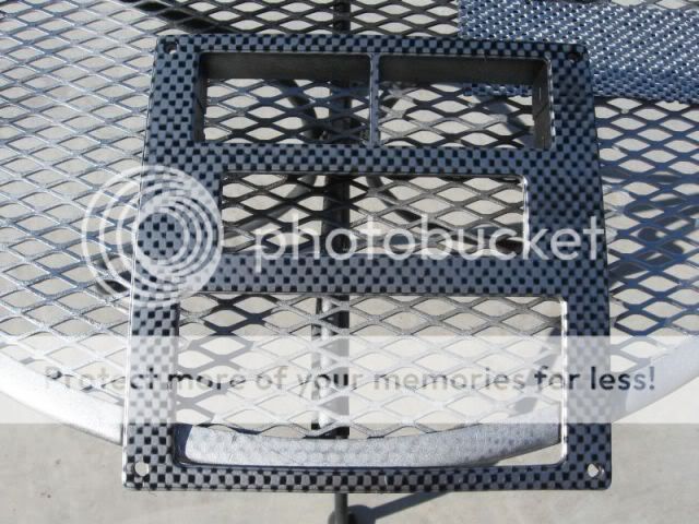

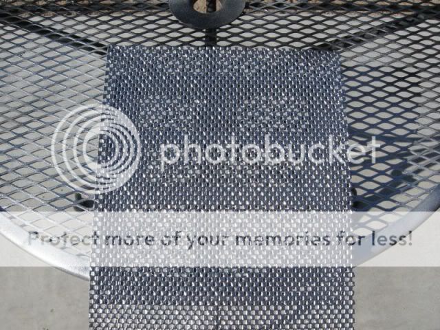

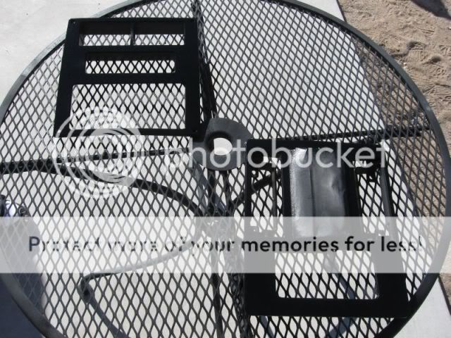

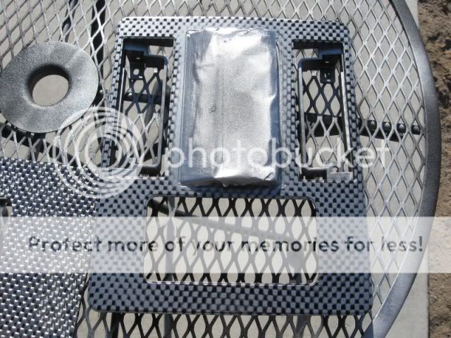

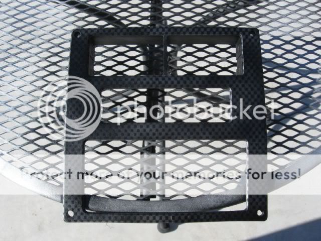

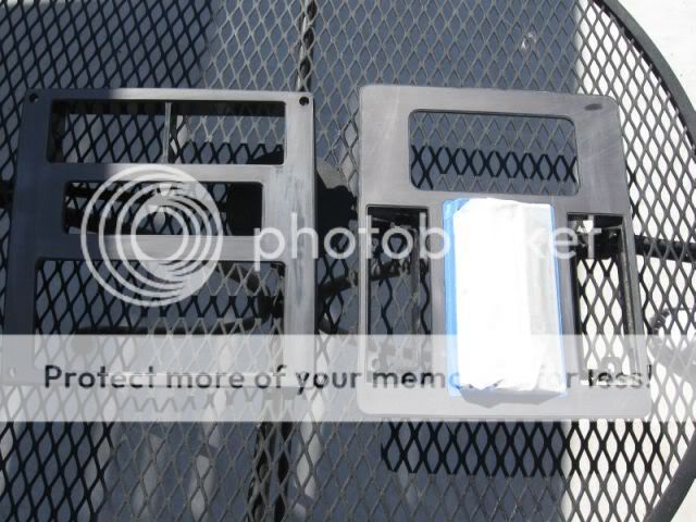

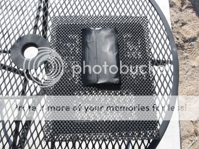

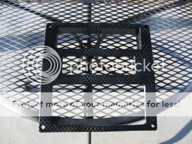

Today, Chris - my 16 year old who will soon be taking over the care and feeding of the XTC decided it was time to get some much needed work done on the car. Awhile ago, he wanted to give the car some "carbon fiber" look. We watched some youtube vids and did some experimenting and did the "painted" carbon fiber process on the Speedo bezel and the dash corner AC vents. I told him then that this was the last time I would "do the work" on his car. From then on, it was up to him what, when and how things got done.
While I was working on the V8 Coupe, he decided to try his hand at the carbon fiber paint thing. For a kid that up unitl today, had never done anything like this on his own, I am pretty impressed. Here's the results:
Masked, sanded and primed:
 Black coat on:
 Mask in place:
 Silver coat on:
 Drying in the sun:
 Black fogged on:
 And 3 coats of clear:
They turned out a little dark and have some shading areas but I think he did pertty good for his first attempt all on his own from start to finish. Makes me a proud papa to see my boy taking an interest and taking care of his car.
Now for the rest of the story. At around 12:00, he went out to the car to take off the old AC suround and Shifter cover. At around 7:30, I went out front to close up the cars and he had left the doors open, the stereo on and the battery did not have enough umph to start the car. Now he's out there in the dark jumping it...... They never learn....lol.
Pat
Mr.PBody
NOV 24, 01:15 PM
Does that foam stuff come in a tighter weave? You're good at what you're doing and the technique works, but a tighter weave would make it look much more realistic.
