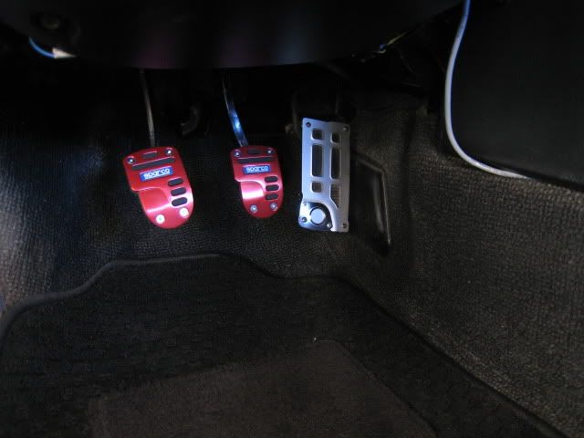

So the latest update is new pedals. I came across some red anodized sparco pedals... now I know my interior theme is black and silver, but I thought red on the brake and clutch would spice things up. I kept my old gas pedal because its big enough that I'm able to heel/toe with it... check it out:

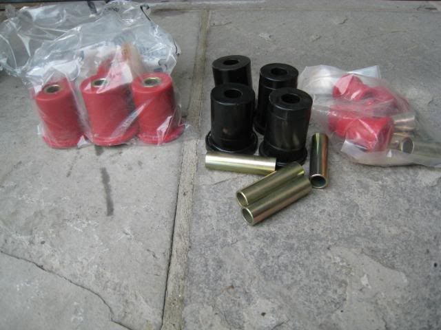

Collecting suspension parts:
Front/rear poly bushings:

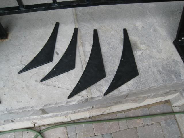

Also, I picked up some of these "splitters/canaards" that they sell on ebay:
No they won't be bolted to my front bumper.

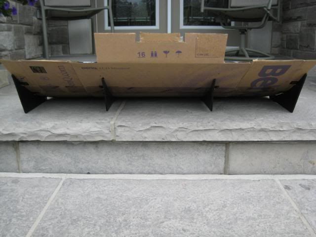

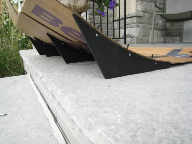

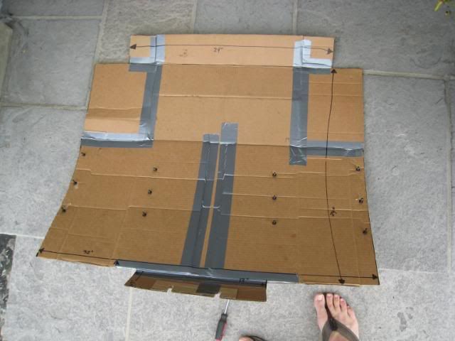

Instead, I'm using them as diffuser fins for my rear diffuser project. Right now I'm in the stages of doing a mock-up with cardboard. Please jump in with suggestions:

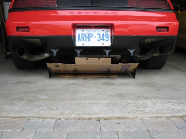

And here is a picture of it placed under the car, but not held up into its proper position. The old "fins" I have on there will have to be removed.

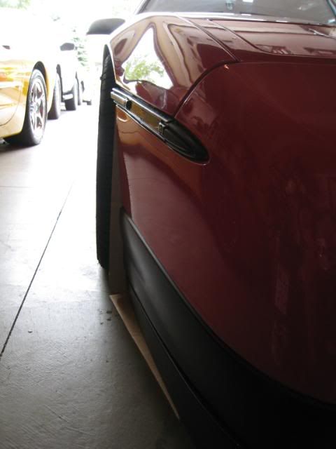

Now I was also thinking about some kind of front splitter/flap that would reduce the amount of air that hits the front tires causing drag. I just taped some cardboard in place, but what do you guys think? Does it have potential or am I getting carried away

Jake_Dragon AUG 29, 11:11 AM
I like the diffuser, you should be able to pickup some aluminum and cut it with a jig saw. Its not hard to form and could be done with a couple of 2x4s if you wanted to try yourself. Stick one 2x4 under the aluminum and the other spaced back about 6 inches on the top side. Now just step on it. You can create the correct roll by moving the top board closer or farther away and just work your way from one end to the other. This also depends on the thickness of aluminum you use. If its too thick you will have to take it to someone with a roller and a metal break.
The splitters will help hold it to the correct shape and what every you bolt it to to hold it to the Fiero. Once bolted on it should be pretty stiff.
I don't know about the front flap, I think you could get the same results by splitting the wheel liner and the underside of the fascia and just pull it out flush with the tires. Just bolt a piece of aluminum to the back side and paint it black. You could use something to fill in the cut and use some glue to fill the gap.
