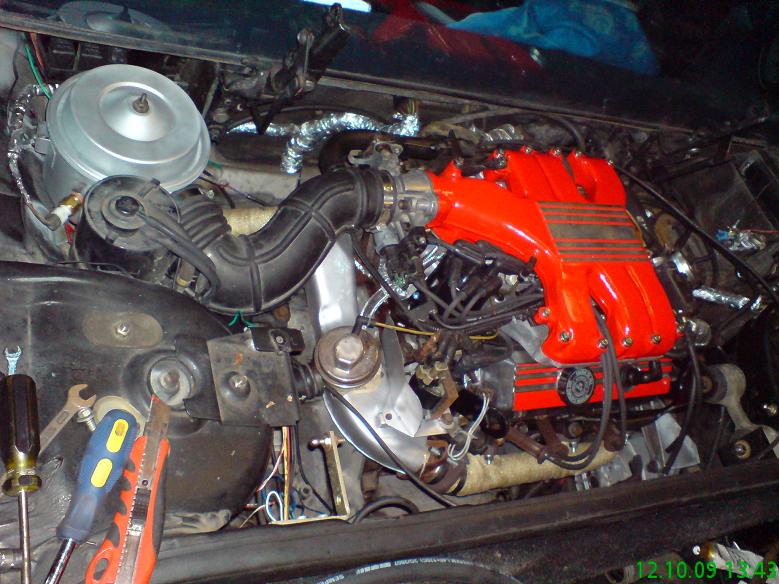

ITS RUNNING
very smooth and on all cylinders.
Ive set the ignitiontiming it was ok .
but , my aftermarket instrument reads 0 oilpressure it started with 4-9 psi but after 1 min it went down to zero ....
tomorrow i guess ill swap in another pressure sensor and test with a akkudrill if the gauge is reading something.
I guess ill check the valvelash too .
hmmm

ALJR OCT 12, 04:10 PM
Looks like your tach filter is mounted on the wrong bolt... I belive it is supposed to go on the other coil bolt, away from the exhaust maniflod...
What is that hose attached to your crossover pipe shield?
[This message has been edited by ALJR (edited 10-12-2009).]
Fieromaniac OCT 13, 01:51 AM
ah ok ill mount the tachfilter other bolt then .
The Hose is the old main coolant hose of the L4 , it still need to be removed
its too bad that ive 3 fieros here but the others are L4 so i cant check this lil details .

Thought that old hose was some sort of cooling device for your exhaust
I am sure you can find ANY information needed from others in here (PFF). Some of these guys know the Fiero inside & out and could probably assemble one in the dark...

Update:
changed oil alrdy after first 100mls and engine is running very well.
I setup the timing for the first 1000mls conservative at exactly 10°
I still need to install the propanesystem , a new 200cell racing cat and an electrical coolant heater with 220v plug for cold nights.
Oilpressure is fine , i had a ground problem .
After adding some extra ground straps the gauge shows the exact pressure.
After the break in period and the install of the propanesystem ill guess ill go to 13°-14° ignition advance .
