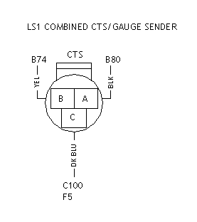

| quote | Originally posted by fieroguru:
Found it:
3 wire LS1 temp sender GM # 12551708, application 1998 Camaro w/ LS1, pigtail is the same as the TPS sensor on the fiero 2.5 and later model applications.
The bottom wire is for the gauge.
Only downside to using this 3 wire setup is I will loose the temp light, but the gauge is much more important anyways. I like the idea of 1 less sensor.
Is this pinout is looking at the mating face of the connector?[This message has been edited by Will (edited 10-05-2019).]

| quote | Originally posted by Will:
I think it is the face of the connector (vs. the face of the sensor), but I will need to check the service manual when I get back home this coming Friday...
Will
OCT 07, 08:34 AM
We just swapped my dad's truck* from two wire sensor + original gauge sender to the three wire sensor/sender combo. We figured it out.
