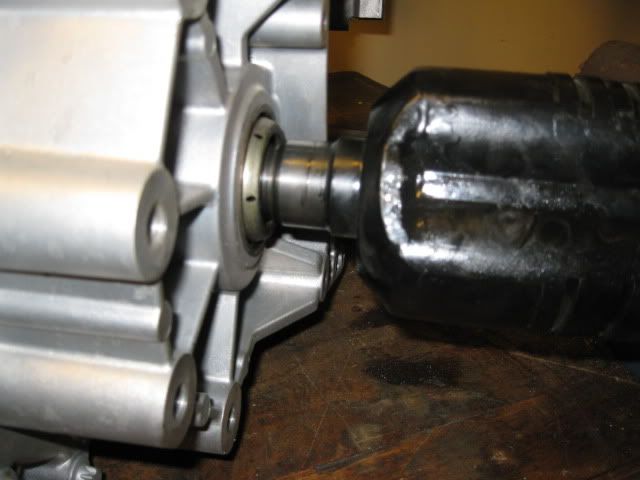

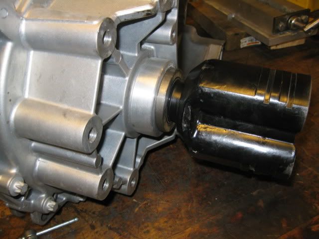

To convert from an AWD to FWD, the opening in the AWD case is larger than the FWD case (atleast that is the case with the F40 AWD setups). There is also a spline extension on the differential carrier that sticks past the bearing support to drive the AWD unit, so any seal would have to be offset slightly to clear this spline (or swap out a FWD differential). So making a seal extension housing is probably all that is needed, but it still needs to ride on a machined seal surface.
I made one of these seal extension housing for the F40 10 years ago...
How much difference is there actually between the 6T70 and 6T75? Would the 6T70 bellhousing swap onto a 6T75 or even 6T80 (RPO MHM in XTS V-Sport)?
I figured it wasn't as easy as just popping the seal in, but with swapping in the RWD diff or using 6T80 guts the seal adapter could be simpler. Obviously your seal adapter works, so I assume the profile of the intermediate shaft allows moving the seal out while staying on a journal with the appropriate surface finish. Is there an LSD available?
I made that housing for the F40 to use a tripod vs. intermediate shaft on the passenger side. With the design of the F40, the tripot stuck out an inch too far, so this left the support and seal area exposed, helped everything work with the seal extension. The F40 has a LSD available from Quaife and wavetrac. Not sure about the 6T70+ transmissions.
In the pictures above, the differential housing surface was recessed about 1" from the bellhousing face and the spacer merely moved the seal mounting surface to be flush with the bellhousing face. The 6T70+ transmissions didn't recess this area, so the differential seal surface is flush with the bellhousing. From looking at intermediate shafts for the 6T70+, they have a longer seal surface area, so I assume they go about the same depth into the transmission (as the F40), but since the seal surface it 1" further out, the seal surfaces on the shafts are longer. Can they be made even longer... hard to say without installing one in an AWD 6T70+ transmission.
