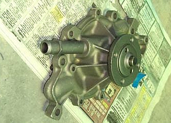

Hi Daniel,
I see your Fiero is an '86 so the other heater hose connects to the pipe that screws into the water pump:
About the oil, I broke in my rebuilt engine using regular engine oil, drove it for about 500 miles, changed the oil & filter, drove another 3,000 miles and then switched over to Mobil 1 synthetic and a Mobil 1 oil filter.
