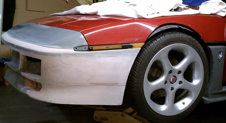

I'm #4 in line for this front fascia. Here's Amida's latest progress on the prototype...
I'm not sure exactly how yet, but I'll mod* that a bit, too, for better airflow. (*The word 'tweak' is officially played out. )
