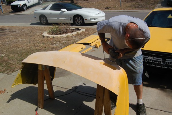

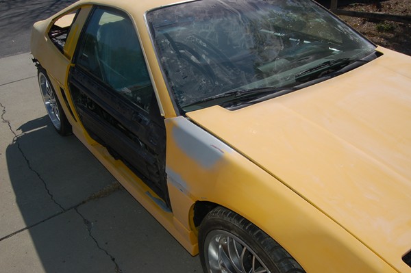

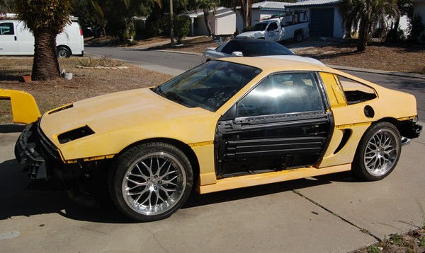

The car has been scuff sanded and smoothed out a lot better, (but it's going to get MUCH smoother before this is all done)

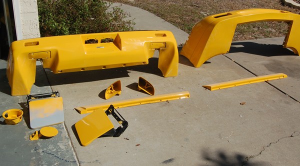

Lots of parts yet to be sanded:
Antenna hole has been glassed in and smoothed out nicely:

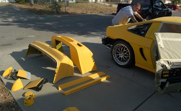

Custom painter, Billy Kidd, busy sanding:

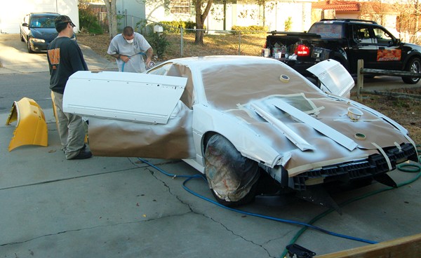

Parts sanded and ready for prep:

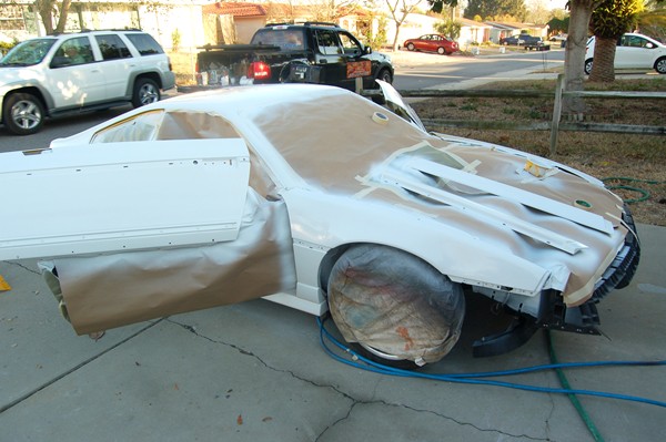

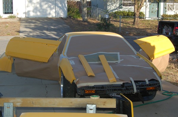

Billy Kidd has started bagging the car:

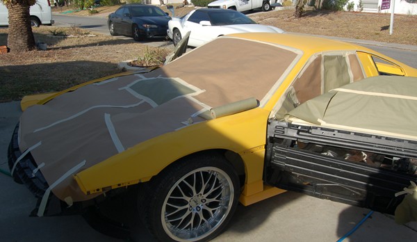

When we get in the paint booth the windshield molding will be pulled back with....what else?.."pull-back tape"
Cool stuff. It's specifically made with a thin plastic strip on one side to slip under the rubber molding and pull it back to let you paint under the molding.
Billy assures me the rubber will lay down fine afterwards.

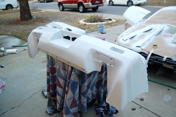

Billy finds a unique way to hang door panels for prep:

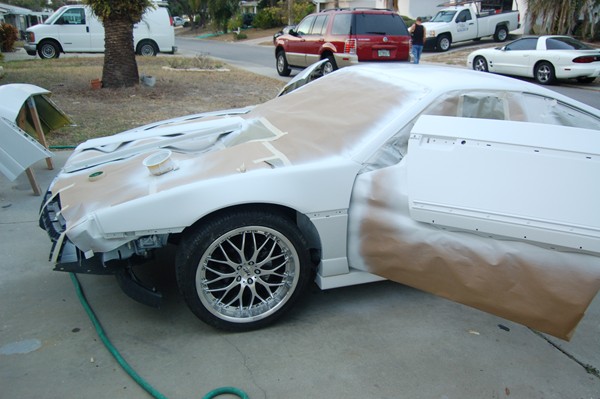

Decklids off and ready:

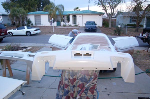

The squirting of primer sealer begins:

We had a nice low humidity day with no breeze, so Billy decided to shoot the primer sealer coats outdoors.
We will be moving the car to a paint booth once we are ready to shoot the final sealer coat and begin shooting color

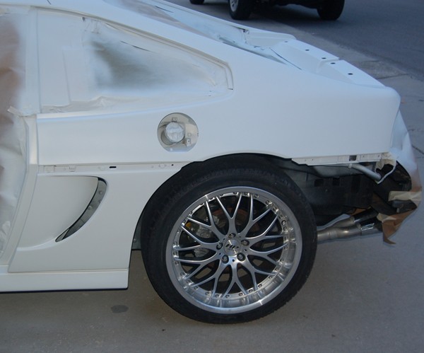

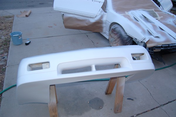

Front bumper cover lookin' good
2 coats of primer sealer on...we're running out of daylight!!
My new quarter panel scoops from JimmyS also looking great and Billy has kept my wheels and tires nice and clean.

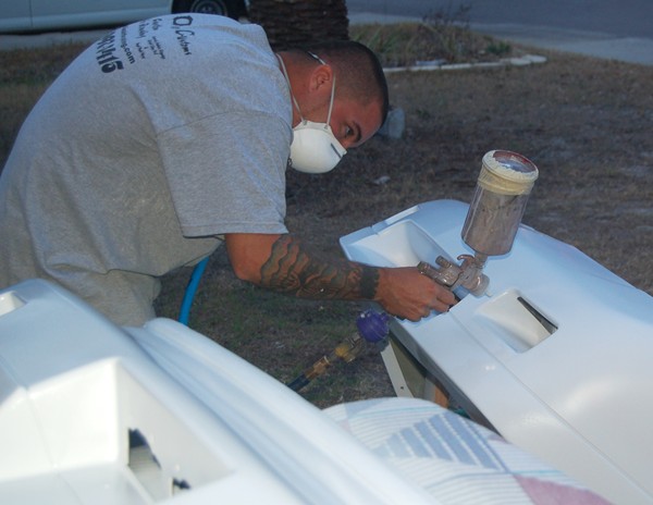

HVLP guns are nice!

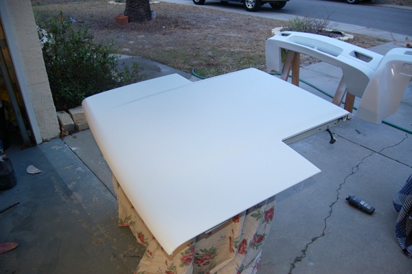

randye FEB 28, 10:01 PM

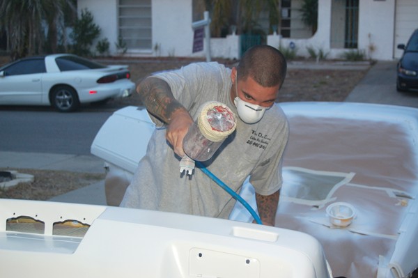

Billy Kidd of "Tricked Out Customs", doing what he does best...squirtin' paint.
A little more attention to the nose:

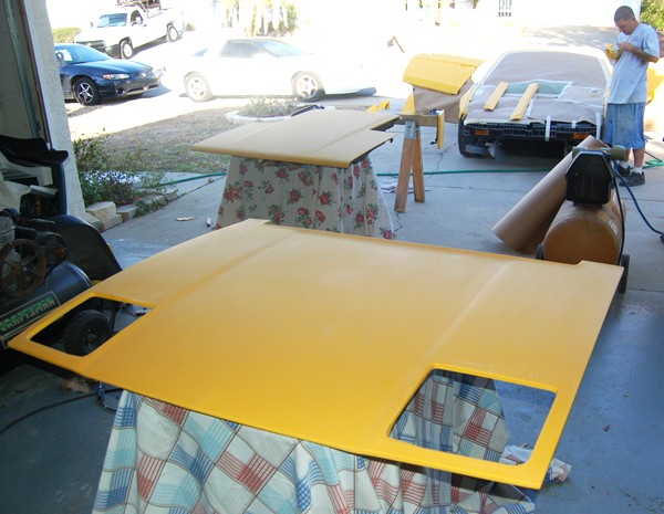

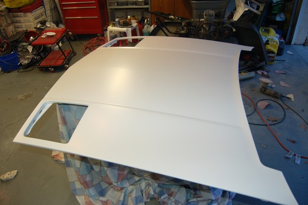

The hood be lookin' good!
Rear decklid in white primer sealer...Hurry Bill..it's gettin' DARK!
A sea of Fiero parts in white primer
Managed to even get the mirrors their first 2 coats of sealer before calling it a day
All ready for some more sanding tomorrow, (does this sanding stuff ever end?)
