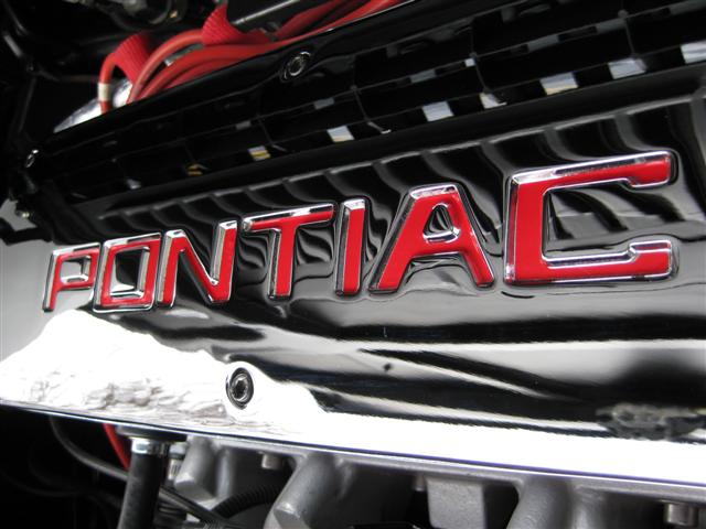

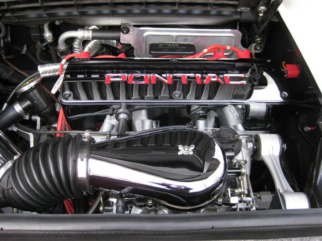

I had noticed it was difficult to keep a high polish on the aluminum valve cover etc.
They also had a tendency for water spots anytime water splashed on them.
So I got my aluminum parts chrome plated. Please excuse the glare/reflections
Not cheap to do - but well worth it (and will look good forever).

FieroMonkey JAN 04, 01:28 PM
They also has a tendency for water spots anytime water splashed on them.
Safastro made some vinyl letter cutouts for me to stick in the bottom of the letters.
http://www.fiero.nl/forum/Forum4/HTML/045657.html
Holy crap! Stunning.
This car should be in a magazine, with a nice article.
Seriously, you have a gorgeous beast of an Indy.
[This message has been edited by FieroMonkey (edited 01-04-2010).]
