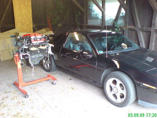

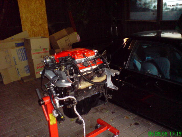

Fieromaniac SEP 05, 01:38 PM
and here it is sitting under my carport ,
the spedition thought of a modern engine when i hired 'em .... they came with 2 men
believe me , they earned theyr money hard

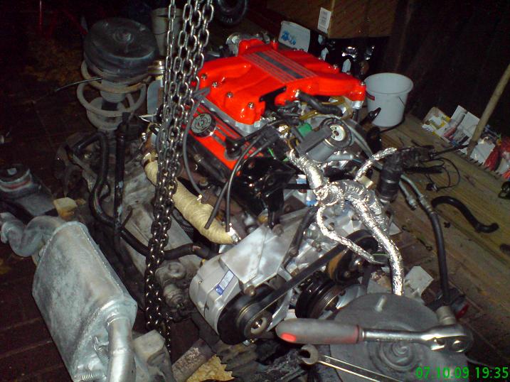

Fieromaniac OCT 10, 04:03 PM
tomorrow it will get in the car
more pics of the swap will come soon.
so far i did:
- cradlebushings front and rear polyurethane
- tranny new bearings
- new mounts for tranny and engine
- cradle got tin and fresh color
man iam exited like dating a woman first time or hmm first time sex or hmmm birth of child .....

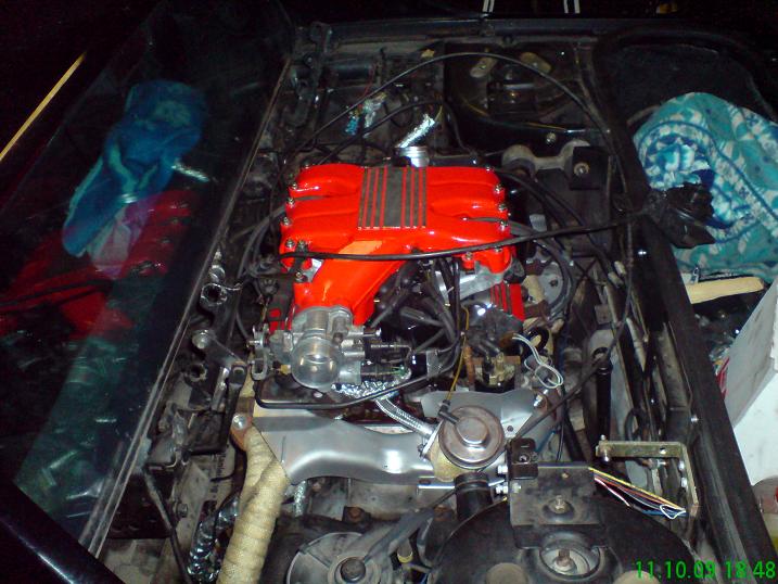

Fieromaniac OCT 11, 02:10 PM
sooo its inside but some hoses and cables need to be connected
