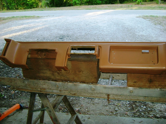

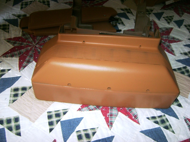

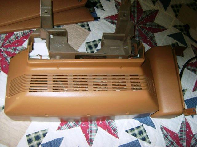

The dash this morning:
 and
This dash paint I got from PPG is premixed and ready to shoot. Real good paint. excellent coverage.

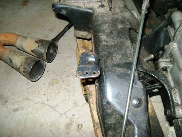

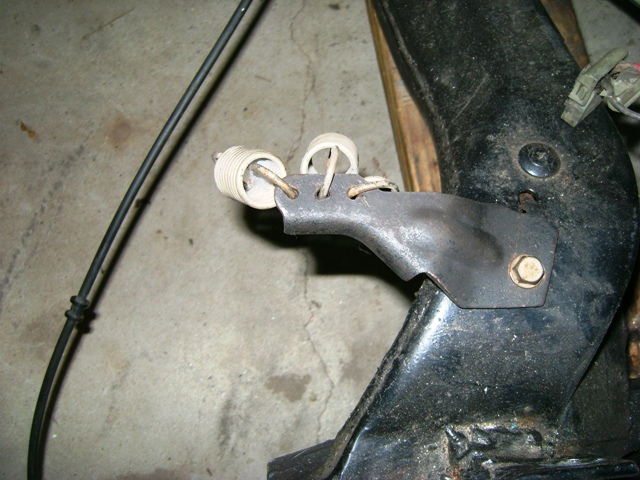

I have had grandchildren here since my last posting. All are back with their parents now. I was able to get a lot of small things done this morning. Muffler hanger brackets attached:
 and

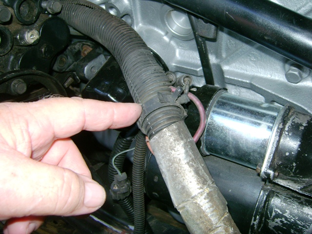

Discovered that my harness fastener has the little plastic anchor destroyed. Gonna look in the mall for one:

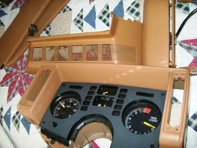

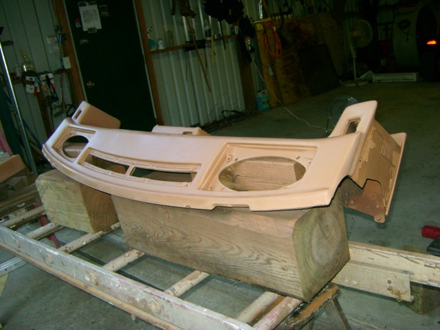

Dash pieces I have been working on in the house:

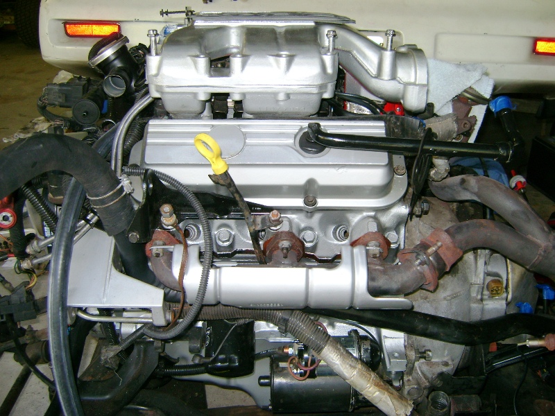

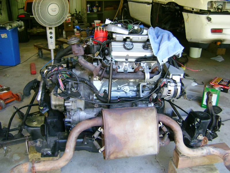

Went out in the garage this morning at 7:00 am to get a few things done before it gets 107* here today.
Removed the exhaust cross over pipe and twisted the wires in the distributor so they will not interfere with anything else. Mounted the tack filter in it's spot. Remounted the alternator and belt. Rewired the rear part of the harness so it would match the attachment points. Connected the alternator wires and it's adaptor for the CS 130. Mounted the ERS solenoid and connected it's hoses and connector.
Removed the metal lines that are supposed to go from the thermostat to the TB. TB holes were plugged. Mounted the MAP sensor bracket to the upper intake. Added some of the black plastic covering to some of the wires that didn't have any on them. Installed the new red MSD distributor cap and rotor. as it sits today:
 and

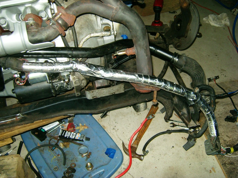

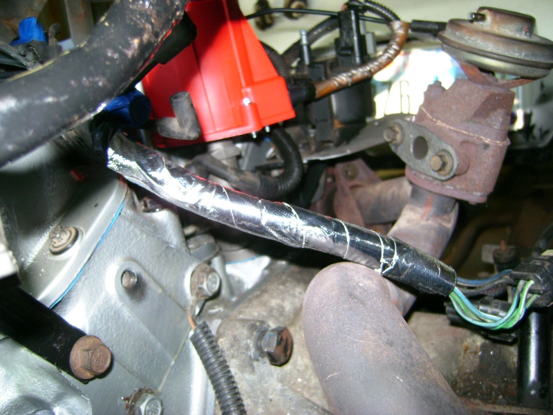

Back out at 7am. I used this to wrap the exhaust side of the harness this morning. I was pretty happy with it as it has a fabric backing as did the GM tape I removed. This was the 15 foot roll and was just enough. I got this from Summitt.
 on the harness
and here also:

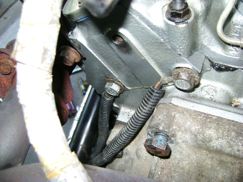

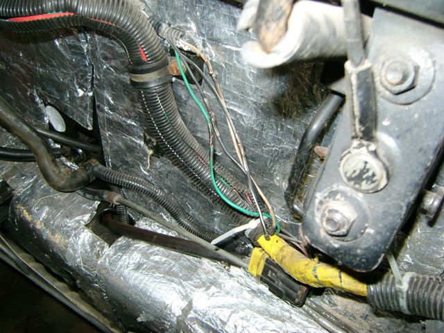

Ground wires:

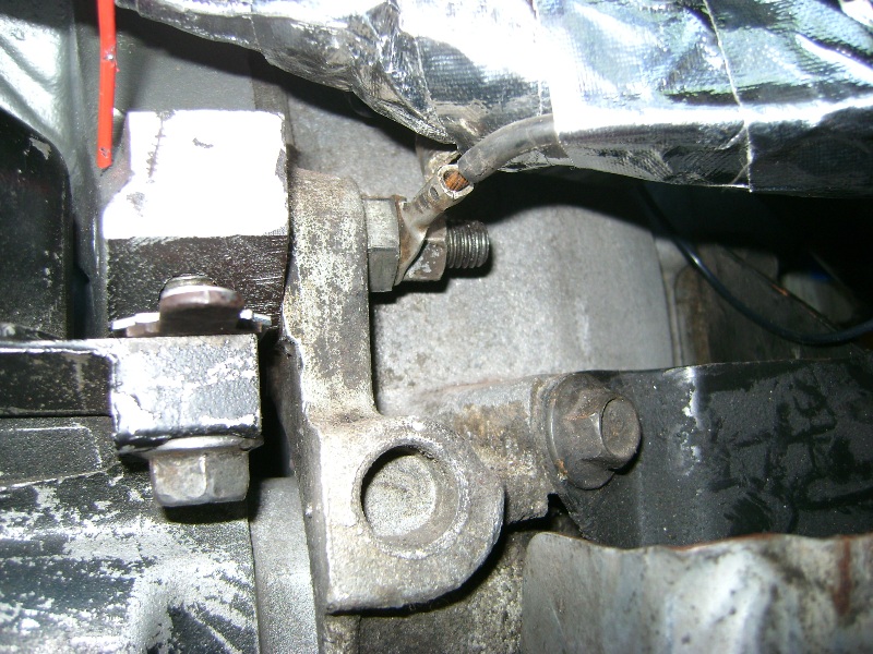

and this one behind the starter area:

It's coming along nicely! How do the MSD cap and rotor compare to GM pieces? On my 3.4 I also installed Rodneys idler set up, power pully kit , and alternator bracket reinforcement. It's much easier to do with the engine out.
I don't recall having that many grounds. Did you add extras?[This message has been edited by Rick 88 (edited 08-23-2011).]
